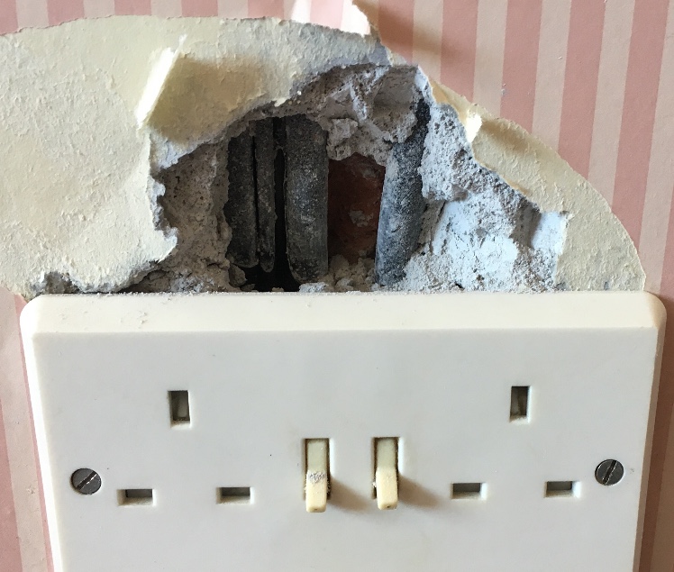

If it is in regular cable, you MAY be lucky and someone MAY have just cut the earth wires off at the switches. It does happen.
Thanks for the replies. I didn't unscrew the back box and decided to have EIRC. Lighting circuit turns out fine...lucky! There is a breakage in kitchen ring circuit but we are going to have all the socket rewired so that should be fine.
for anyone who's interested, this is the cable behind wall, no trunking, no conduit, just black rubber casing.
