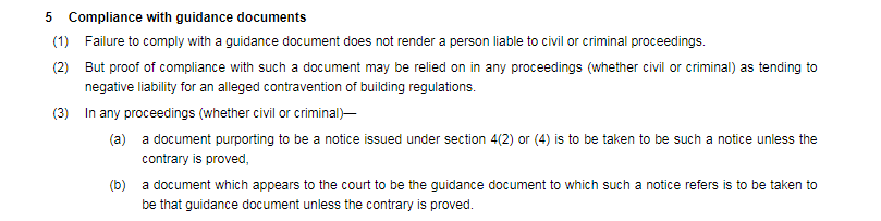

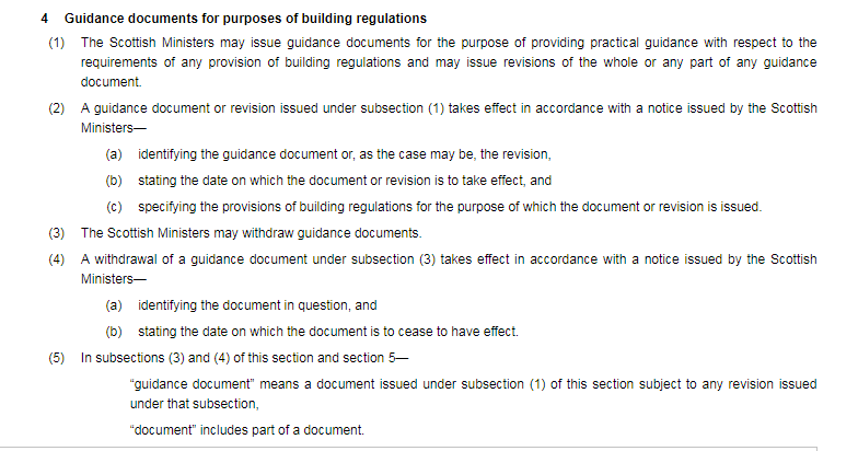

AFAICT these "guidance" documents are the actual regulations - did you follow the link in section 6 to the Technical Handbooks ? The Building (Scotland) Act 2003 doesn't actually have any specifics in it (unlike our English Act where the regs are in an appendix) - part 4 refers to ministers issuing guidance documents.
That's a bit cock-eyed, isn't it? Can legislation make 'guidance' mandatory by referring to it? If so, I'm not sure in what sense it is really 'guidance'?? Ministers could surely issue SI's (or their Scottish equivalent), which are law (not 'guidance'), just as they do in England, couldn't they?
Kind Regards, John
Well if anyone can come up with better .....
I agree, it's hardly "guidance" if it's mandatory.
Simon's Part4 link:
A misnomer to say the least.
Maybe not: ....
I suppose it's a bit like BS7671 and Part P. Although the law (Part P) does not mandate compliance with BS7671, the fact that one has complied with BS7671 constitutes a pretty strong defence if one is accused of non-compliance with Part P. Although, again, not law/mandatory, Approved Doc P more=or-less says that.
Kind Regards, John
Why ? you are being guided to ensure compliance with the law. Put down the regs book and pick up a dictionary :)
