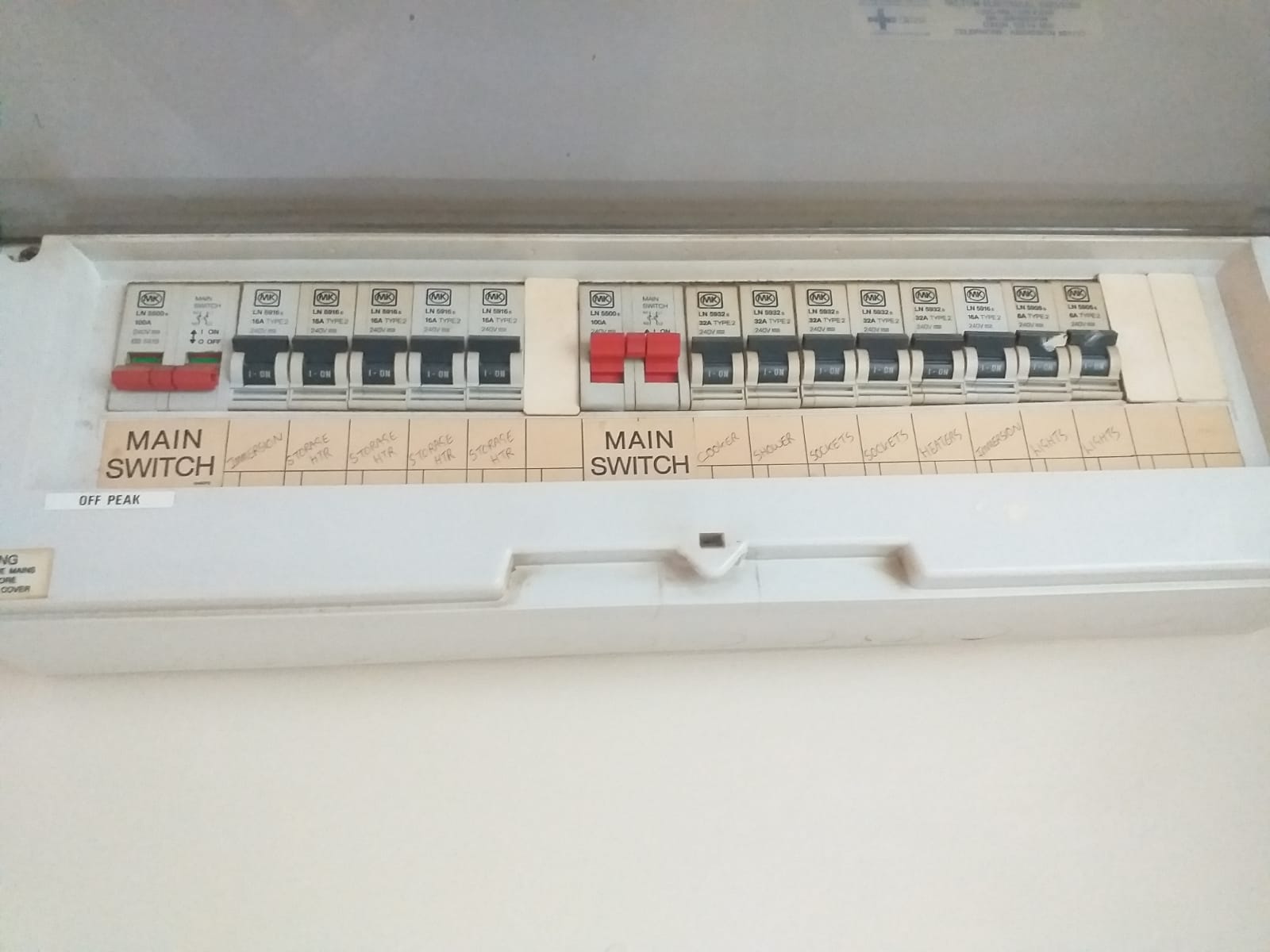

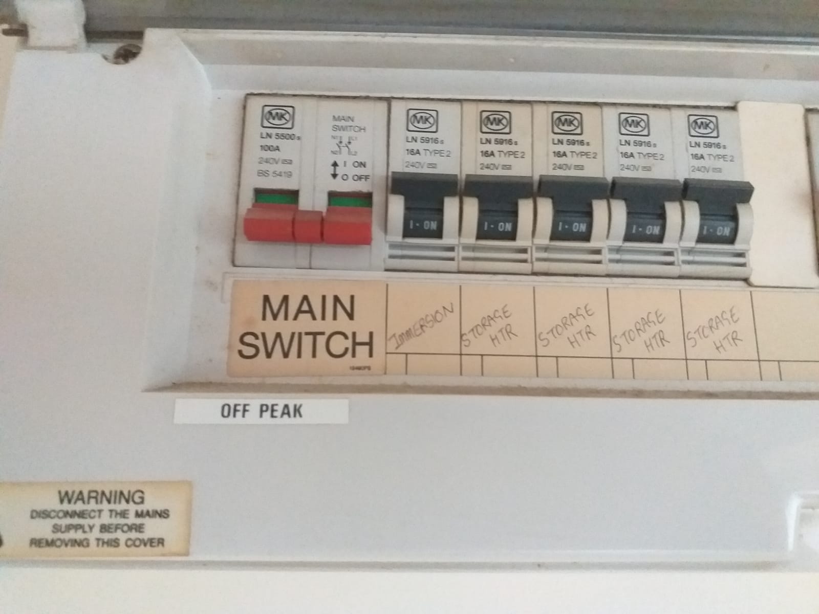

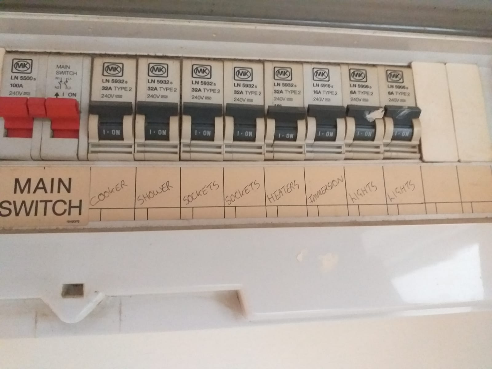

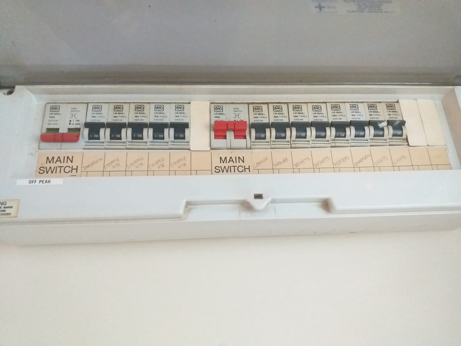

Hi everyone
After some help please!
I've needed to get an EICR for my flat that I rent out while I am working away for a while. The flat is a 1990s build, I've owned it since 2000, as far as I know, the installation was original when I bought and I've not had any significant electrical work done on the place since I've owned it.
The original installation doesn't have RCDs as I don't think regs at the time of build required them. Pics of the consumer unit attached which to me looks to be in good visual condition.
As I said, I work away and I had the letting agency arrange the EICR. The company that performed the EICR (attached) have graded the absence of RCDs against a number of the checks as C2.
Is this right? I was under the impression that in general there is no need to continuously update a property to meet latest building regs, but any new work has to be to the new standard.
They're quoting £780 to replace the consumer unit, fit RCDs to all circuits, replace a broken socket and a broken switch and fit an IP rated light fitting in the bathroom.
Am I being taken for a ride or does the consumer unit really need doing?
Thanks in advance!!

It likely needs doing, the stuff we use today really does need RCD protection, however you are correct BS 7671 has a date where installations designed after that date must comply.
However one the guy doing the EICR would need to be supplied with the orignal EIC to know the date, and code 4 does not comply with current edition has been dropped.
So Code C2 means protentialy dangerous and is not linked to BS 7671, but clearly we do need to follow some rules, and easy way is follow BS 7671.
What has caused a problem is when RCD's are used the bonding rules change in bathrooms, so some thing which looks unrelated to electrics like using some plastic pipes can cause changes as to what it required.
In real terms the goverment has done it on the cheap, and there has always been a diffrence of opinion as what should get a C2 or C3, but until the new law it did not matter.
However in real terms it should have RCD protection does not really matter is technically required, morally you should fit them.

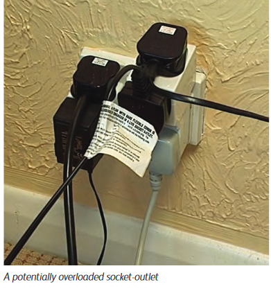

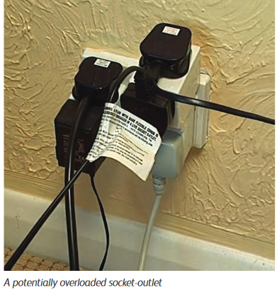

Another sh*t EICR, perhaps not quite as sh*t as some we have seen on other threads but still sh*t.
I particularly note the following paragraph from the electrical safety councils EICR best practices guide.
Each observation should be written in a clear, accurate and concise manner that is likely to be understood by the person ordering the work. Technical terms should be avoided or explained unless it is known that the recipient is an electrical engineer or electrician, for example.
The descriptions of the defects on your report just consist of the out of context text of a regulation and the description of a category code, rammed together into a statement that makes no gramatical sense and gives no indication of where or what exactly the fault is, just which regulation the inspector believes it does not comply with and what severity they have assigned it. There is a little bit of extra information in the "inspection schedule" section, but it's still very terse for example it says something is "not IP rated" but gives no indication as to what.
Under "Manual operation of circuit-breakers and RCDs to prove disconnection(643.10)" in the insepection schedule he puts "some circuit not rcd protected", this doesn't seem to have anything to do with the category he put it under and is not consistent with the schedule of circuit details which mentions no RCD protection for any circuit. He mentions "some circuit not rcd protected" again in several more correct categories, but again "some" is not consistent with the schedule of test results.
There seems to be a bunch of electricians out there who run their businesses based on doing sh*t EICRs, doing sh*t EICRs serves two purposes, firstly it makes doing the EICRs cheaper and hence makes it easier to sell their EICR services to those who don't know or don't care about a good job being done, secondly it makes it difficult for anyone else to quote for the remedial works because they do not have proper descriptions of the defects they are quoting to remedy.

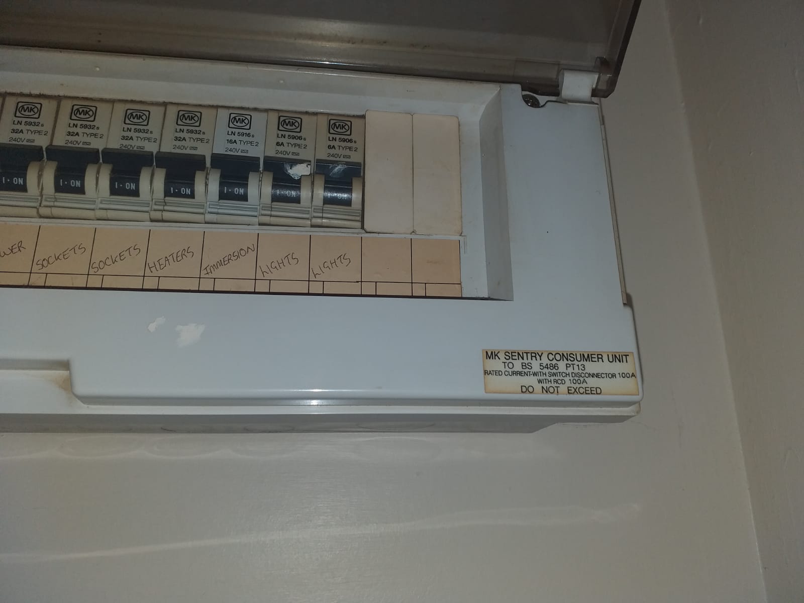

It is likely that remedial works are indeed required and replacing the CU is often the most sensible way to deal with a lack of RCD protection, but I would find another electrician to do them.
It does seem to be a lot of paperwork to say RCD's not fitted, a damaged socket, and wrong type of equipment fitted some where.
IP rating is never not there, the IP rating may not be indicated on the equipment, but table 55.2 says "NOTE: The marking of the symbol,corresponding to IP numbers is optional" so it does not need to be marked, or of a level not accepted. So the "Not IP rated" makes no sense. We have IPXXB or IP2X, IPX4, IPX5 and IPX8. It can refer to some thing as simple as a knock out missing in a CU case or MCB blank, or wrong type of fitting in a bathroom, even a surface socket box with a blank or knock-out missing, so without a location it is totally useless.
The same could be said for damaged socket, location is important, in my parents house there were a few sockets which were damaged or did not comply with IP rating requirements, all were redundant left in place after a re-wire, so location is important.

Depends what you are getting - there is a world of difference between a quality consumer unit from a reputable manufacturer and some end of line clearance special from Screwfix.

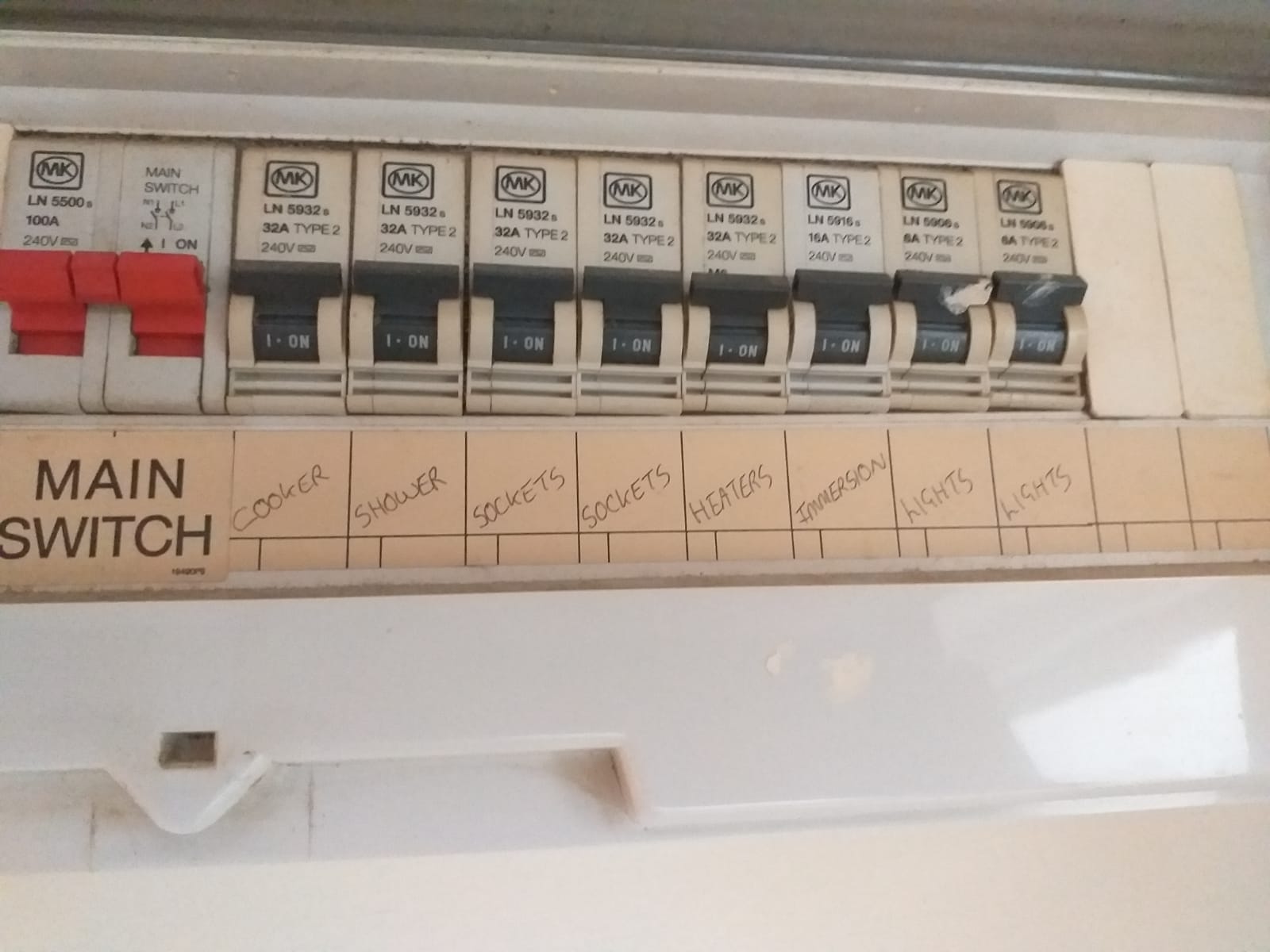

The EICR document is poor.
However the lack of RCDs is correct, even in the 1990s RCDs were required for some circuits.
Seem to remember paying around £250 for my consumer unit, that did not include fitting costs, the guy who fitted it for me took nearly the whole day, and I did some work after he left correcting borrowed neutrals, so really more than a day. So not far out cost wise, but hard to say what is reasonable. If I had used top of range instead of budget consumer units the cost would more than double, and if OK with just two RCD's for whole of house could half the cost.
