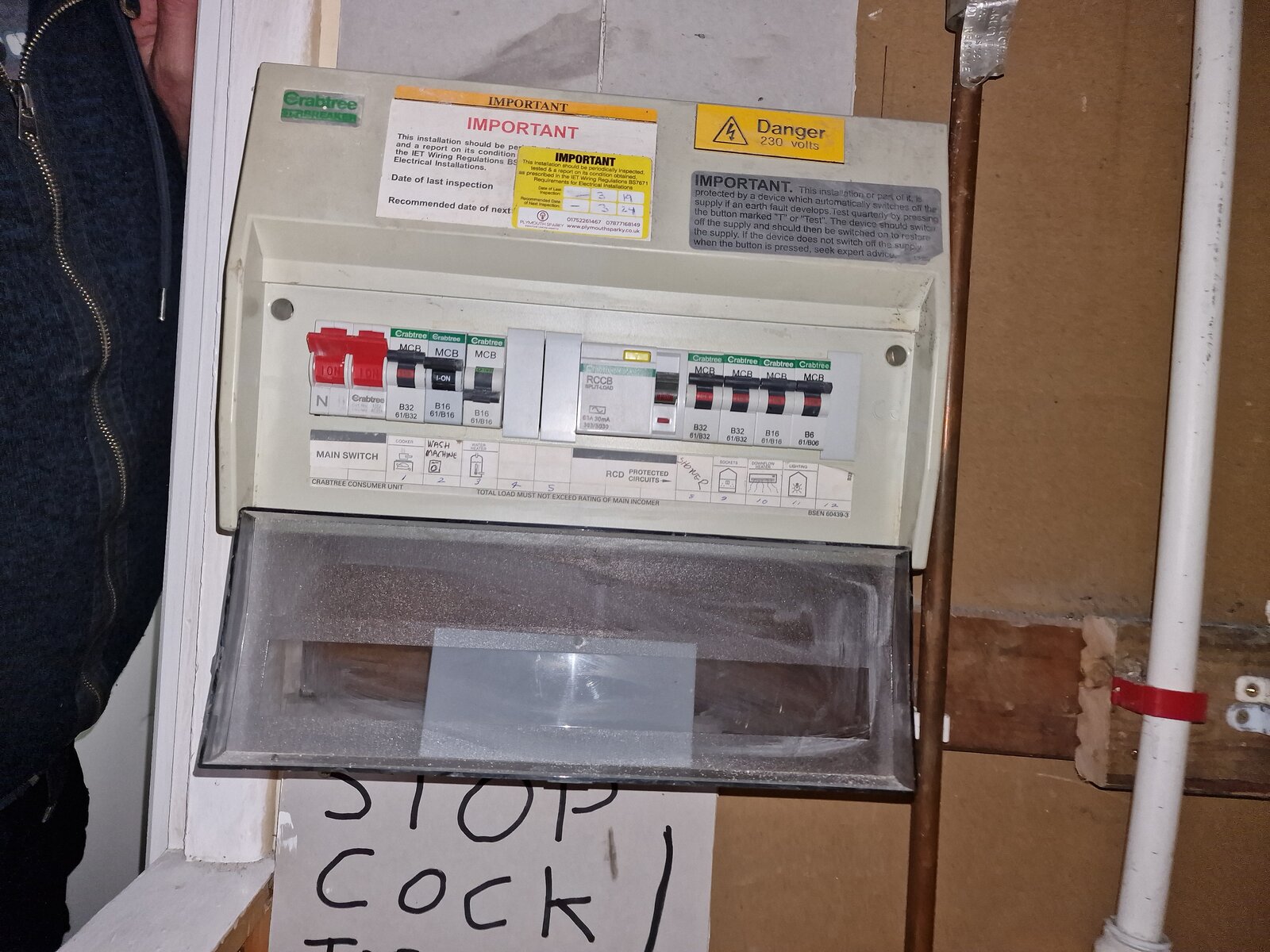

Hi Guys,
I have a consumer unit regulation question I'd like help on please...
So this is for a 1 bedroom self contained rental property and not a HMO in England.
See picture....
So half of the circuits are covered by a RCBO and the wash machine, cooker and hot water tank are not. A spark has said it doesn't comply failed the eicr and requires all the MCB's to be replaced with RCBO's.
I was wondering if this is necessary? New tennant moving in soon.
Would another option be to have the RCCB moved to the left to cover all circuits? Or is the 63 amp rating for the RCCB to low to cover all circuits?
Thanks a lot guys any advice from someone who knows would be great please. Tony uk
C3 is not a fail; merely improvement recommended.
That is nonsense.
HOWEVER - as a landlord the only way to show that you have done everything you can to ensure the safety of tenants is to do as the electrician says.
You will likely need a new metal consumer unit as well.
I wouldn't bother if I were living there but that's not how it works for landlords these days.
Your picture does not show any RCBO's, and an EICR is the opinion of the inspector, it is not like a car MOT where there is a reasonable fixed pass or fail, or it says is the inspector feels it is Dangerous, Protenually Dangerous, Need improving, or there was some reason he could not inspect and test.
Only C1, C2 and FI are fails, the rest is advice.
I would not be happy with that consumer unit, but as to what needs doing not so easy. The problem is to change anything the person doing the change does need to comply with the current edition of BS 7671.
So it is really down to what a scheme member will do and issue a compliance certificate. Likely better to get a new fire resistance CU with all new RCBO's than faff around trying to upgrade it.
However if the two left hand MCB's had been RCBO's it would have likely passed.
Thanks Guys, I was not given the paperwork for the two flats that failed just the one for one that passed. The guy said c3 but since I rang them they say its a c2 and must be done. I wanted them to move the 63 amp rcd to the left to cover all circuits to save a few hundred quid but they said it could be very fiddly and they might not be able to do that and then they would have to go to the wholesalers and get the rcbo,s and that would add on a lot of time to the job.
I can't see at all how moving the rcd over could be fiddly.
I decided to buy the RCBO's myself to save time and as they were saying they are not easy to find although they managed to tell me how much they were.
I'm not happy with their service after people are giving me differing accounts of what's what.
I spoke to the spark next door, he looked at the box and said it's an advisory not mandatory and he would have passed it.
Thanks guys
Not possible in that consumer unit, the busbar is a fixed 'plug in' style, the RCD can only be located where it is now.
RCBOs for that consumer unit are readily available everywhere.

And I’m not convinced those circuits are anything but C3’s
The three non RCD protected circuits in theory can have their MCB's replaced with RCBO's, the bigger problem is where the plastic nature of the consumer unit is going to meet any potential legal requirements imposed on landlord (such as the result of a EICR for example) or if the whole consumer unit will need replacing with a modern metal one.

I have a similar Starbreaker board with an identical 3-module RCD. Busbar in mine goes full width but there were many variants of these boards. Worth taking off the cover to look. If it can't be moved my solution would be to fit 3 new Crabtree rcbos* as a DIY job, then get new EICR from someone different who doesn't know all the history.
* with certain limitations, dedicated circuits did not need to have RCD protection. Is that still true and if not is it retrospective?
