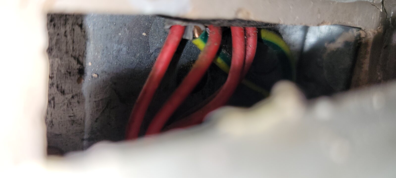

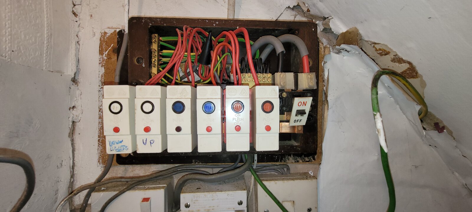

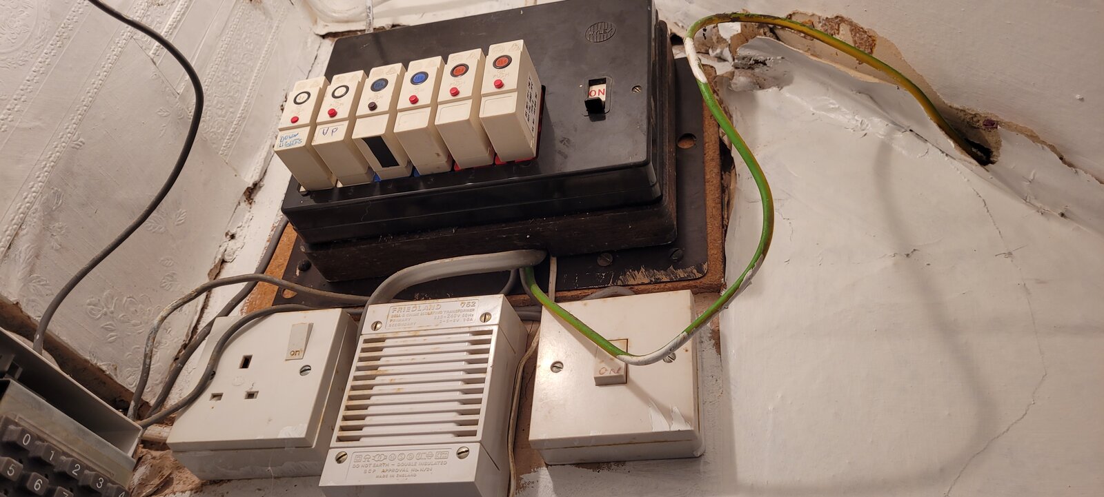

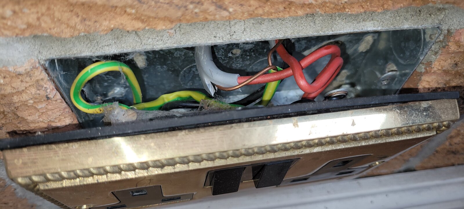

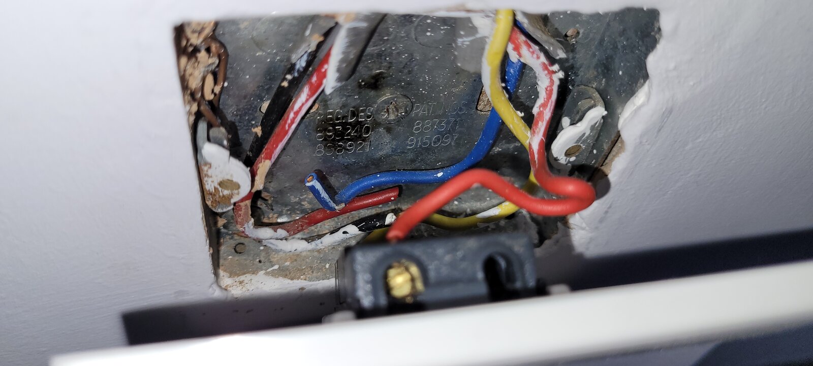

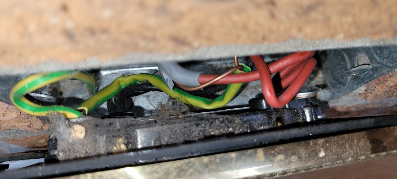

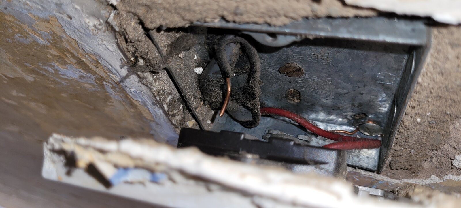

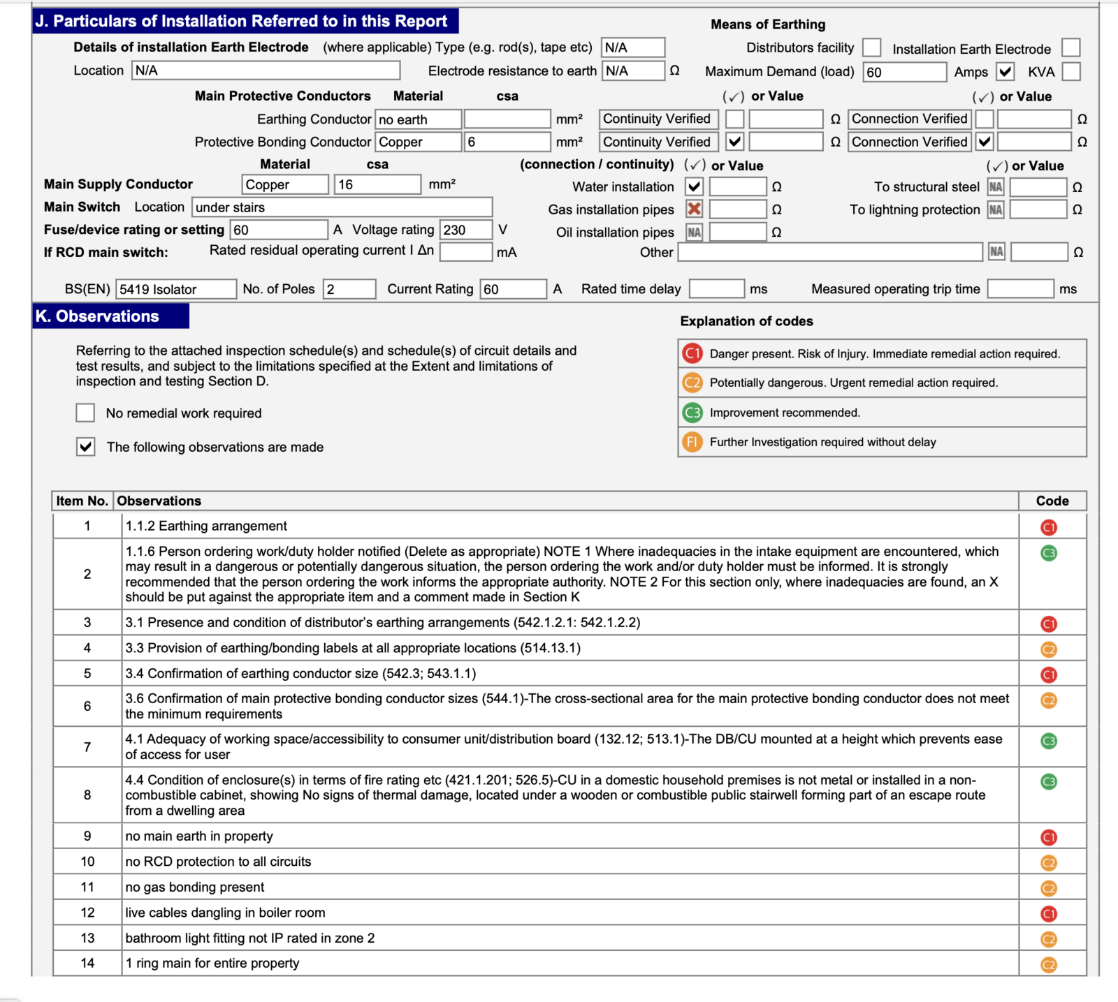

Hi
Recently done a EICR Test and a full rewire was recommend, the house is semi detached constructed in 1930 and the whole side of the house has been extended in 1970, therefore some of the wiring could be new and some old, not 100% sure but the consumer unit is located in the newer extension. I have attached some images of the report and there are many C1's:
- 1.1.2 Earthing arrangement
- 3.1 Presence and condition of distributor’s earthing arrangements (542.1.2.1: 542.1.2.2)
- no main earth in property
- live cables dangling in boiler room
C2's:
- 3.3 Provision of earthing/bonding labels at all appropriate locations (514.13.1)
- 3.6 Confirmation of main protective bonding conductor sizes (544.1)-The cross-sectional area for the main protective bonding conductor does not meetthe minimum requirements
- no RCD protection to all circuits
- bathroom light fitting not IP rated in zone 2
- 1 ring main for entire property
- no gas bonding present

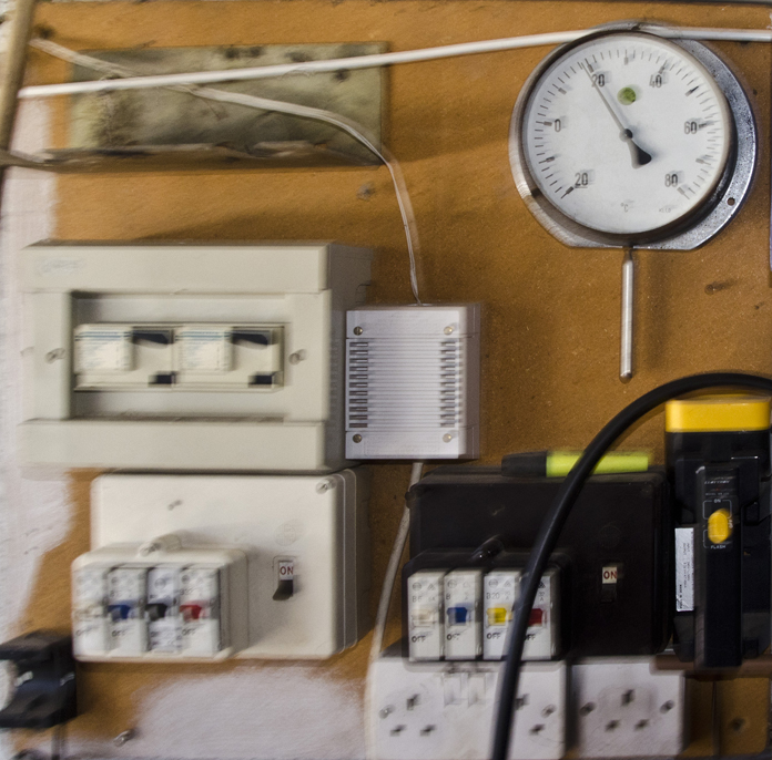

Does the house require a rewire or is it possible to get the issues rectified and a new consumer unit. Also really confused why there is a C1 for no earth to property, when I see a green and yellow earth cable coming into the consumer unit (Attached some images). Most of the plug sockets have earthing but some of the lights don't have the earthing cable.

For starters 1 ring main for whole property is NOT a C2 and I’m not sure I agree with the C2 for the undersized bonding cable unless it has obvious heat damage
But it does sound in need of a lot of work
Your own property or rental you own?
My own property
The large green/yellow wire is probably not a main earth but a bonding conductor (makes sure pipes don’t become live in case of a fault in the electrical system).
At the very least you need an earth rod somewhere and the cables in the boiler room need to be taken care of. From the certificate alone it doesn’t sound like a full rewire is your only choice but depending on how happy you are with the number and placement of sockets it might be the most feasible.

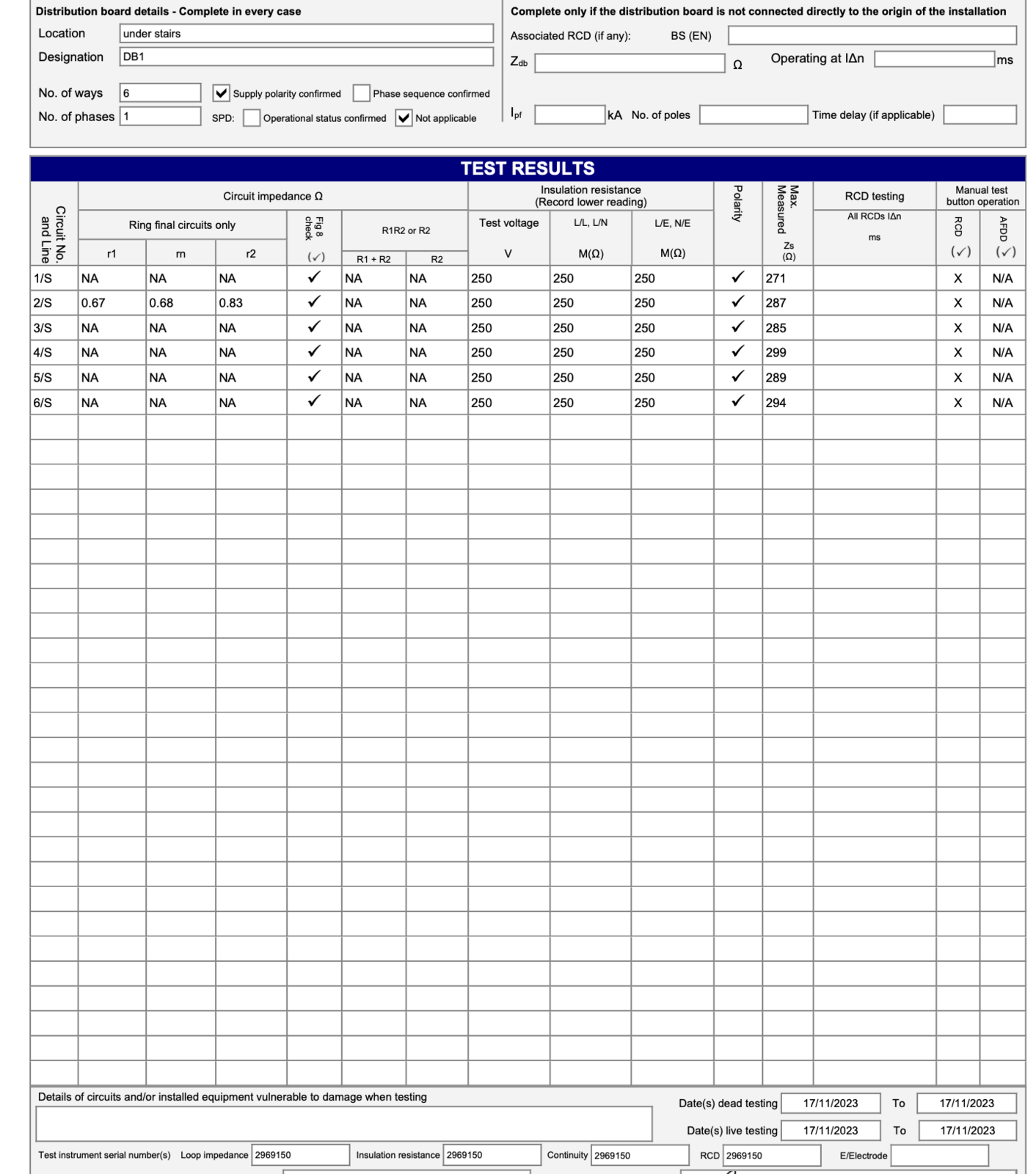

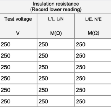

So firstly you are under no obligation to act on the EICR , that said you do need to get the earthing clarified / fixed. It could be a TT system with a poor earth rod which could be the reason for the very similar Zs readings. Could you post a photo of the incoming service head?
No R1 + R2 readings either
No cpc in some of the lighting isn’t great either
If I was you visiting spark I would recommend
1. Get main Earth clarified/ fixed
2. Seriously consider a new CU with RCBOs
3. Get a partial or full rewire

So the question is what has happened to the earth? Two options one bang in an earth rod and fit RCD's, or two get the DNO to provide and earth. Without a RCD the earth loop impedance (called resistance with DC) must be below 1.38 ohm for a 32 amp MCB type B which is near impossible, so the main thing is you need RCD protection, I did add it with my own house Wilex-board-with-RCD.jpg but this was before we could buy consumer units with the RCD built in, and it did from time to time cause problems, so it likely will need a new consumer unit with RCBO's (RCD and MCB combined) and likely SPD as well which is more to stop spikes damaging electronic equipment in home rather than people.
Since the main fuse will likely be pulled when the DNO provide the earth, better to get CU done first in some ways. Then DNO will fit new seals.
C2.
Sketchy C1
C2's:
C3
Depends on the circuits.
C3
C3
C2
I'd advise you to get a new consumer unit while having the issues rectified. It'll only take less than an hour to get the electrician to fix those C2's and C1's.
54-yo wiring is not "new". Realistically the entire electrical installation belongs in the bin. Start again. It's life expired.
Around 1966 we had major changes with wiring, before that date lighting circuits often had no earth, and rubber cable was used, so my parents house built 1954 did require a re-wire, the change from imperial to smaller metric cables combined with spurs off spurs many of the metric cables showed signs of overheating, and reading with the insulation tester showed poor reading, however I used 500 volt, I can see with smart sockets, filtered sockets, RCD sockets and the like why 250 volt used, but would not have used the lower voltage throughout.
However with a powered up system one test I would have made is earth leakage. A guy swapped my parents consumer unit without testing, and then found he could not keep the RCD powered up due to leakage, leakage can be due to failing insulation and the insulation tester at 500 volt will find this, but also it can be due to capacitive or inductive linking, which will only happen with AC, and the insulation tester uses DC, so before fitting a new consumer unit one needs to know if the new 30 mA RCD's will hold in, and we are allowed 30% leakage so nothing over 9 mA is allowed, socket circuits seem to remember 3.5 mA is the limit.
I took a chance, the consumer unit was fitted, all RCBO then I looked for any problems, two lamps using wrong neutral, soon swapped the neutrals over, but the whole idea of an EICR is to find these faults before one starts, and the easy way is a clamp on ammeter with 1 mA resolution or better, around the lives (line and neutral) of each circuit, and putting a load on the circuit, the typical up/down stairs errors are easy shown, OK may miss some obscure faults, but most will be found.
I feel the standard forms should have a box for earth leakage, far more important than which number in BS 7671 the fault brakes, yes as electricians we may know what 701.411.3.3 Additional protection by RCDs covers, but the EICR should be in a language the client understands, so if I as an electrical engineer commission an EICR then OK quote 701.411.3.3 but for an ordinary person (that is a BS 7671 definition) it should says bonding in bathroom is missing so either bonding needs doing or a RCD installed, I recommend the latter. Is that so hard to use everyday language?
