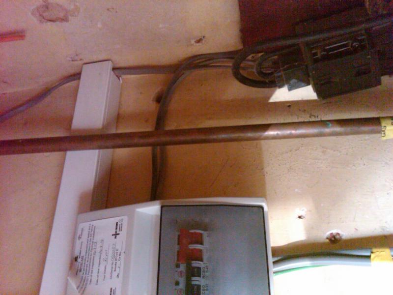

Hi all,
I got a call from a family member who asked me to come and look at possibly putting in a socket or two in his newly acuired home. He has just been offered it from a housing associastion for an exchange.
Anyhow, I popped over and noticed it had just been re-wired and so scoped out for the install cert. I have managed to obtain it, and having scrutinised pretty much all of it, need to decide the next best action.
The cert is with a periodic cert (the one that said it needed the rewire in the first place) and BOTH have not been signed off.
These are DCN5 + DPN4 forms from an approved contractor.
Having read these forms, I would get them done again (as my companies QS I wouldn't sign off something that came back to me like this).
So I thought I would check the company out on the LABC but no luck, although the company has a different name on both froms, same address though. :?:
So I dunno wether to go to the client direct to advise them to get it completed, their office is open tomorrow. Or get straight on the phone to the NICEIC and give them the enrolment no.
I am not happy myself to do work on another companies rewire if it hasn't been properly signed off beforehand, but I may have no choice..

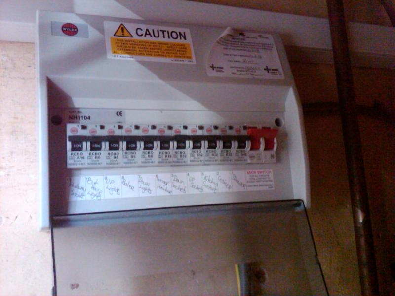

(Cha-ching with the RCBO's)
Installation Certificate issued -

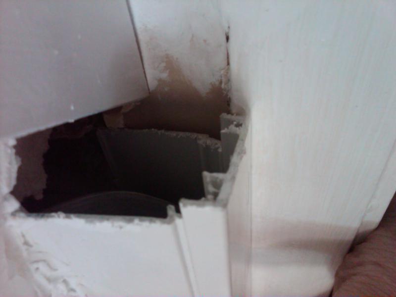

Would you like us to pick holes in the new installation?
BTW, the original PIR is a complete joke, and I would definatly send a copy to the NICEIC.
Trading Standards might also be interested. It appears to be much the same as telling somebody their whole roof needs replacing because they have a few loose tiles. Then taking the money and not even doing the job right.
Fire away, if you want me to re-up bigger copies let me know ;)

I like item 9 on the PIR 'there must be a joint in the loft'
It's strange how the cutout changed it's BS number between certificates, and neither of the inspectors seem to know the kA ratings for these fuses.
They must have got bored with filling in the max permitted Zs coloumn. Maybe they were too busy verifing the phase sequence on a SP installation. :rolleyes:
