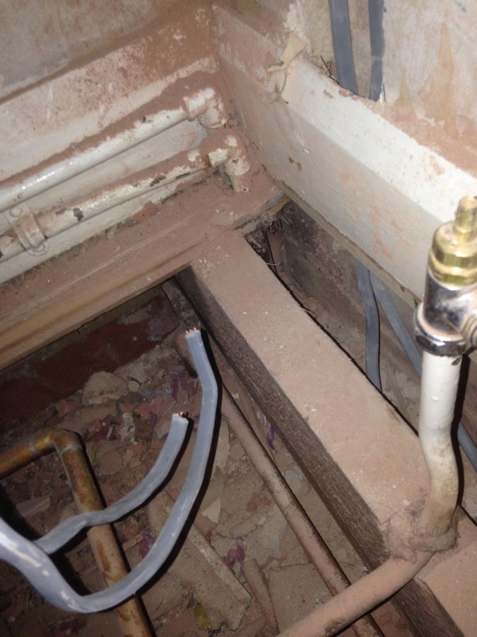

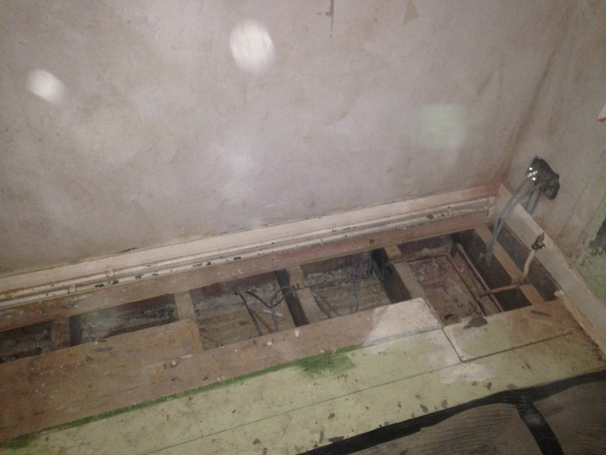

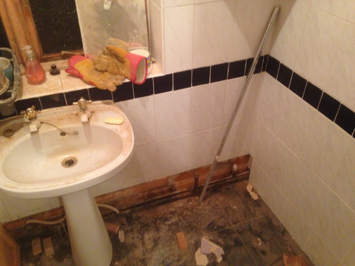

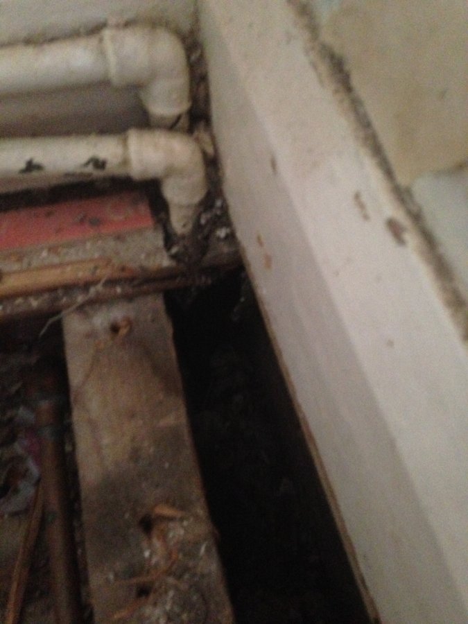

pics of existing installation - for planned push fit pipes..

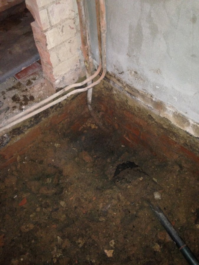

ok reading up some more..
lead pipe comes in as a 25 mm it narrows down to 15 mm copper which has a seized main. - this rises to the bathroom above ( still 15 mm copper ) where it T's 3 ways ( shower/bath - bath sink - feed to seperate toilet/handbasin - ) the 15 mm then goes over to feed the boiler..
we will be replacing the main I hope ( dont want the lead ) we might well want that come up in a different place.
can we pre lay that pipe? ie dig out to where the pipe is outside the house - and rejoin there?
we can then run a 22mm ( or would 25mm plastic pipe be better? ) and T off that?

no was just wondering I could join the new 22mm pipe to the lead pipe in the lean too just outside our back door.. thats probably about 1 meter of lead shorter. than now.
right now the old stop cock tap is jammed open have to go out into the street to turn off mains.
I want to do this pipe so no need to disturb kitchen floor once its in..
