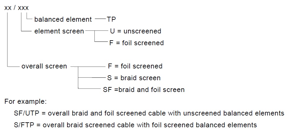

I'm a little confused by the different shielding types, before I posted this thread I was aware of an online place called blackbox networking, I was kind of interested to see if the name would get recommended or not... anyway, they offer a cable they refer to as F/UTP which is supposed to be foil screened, is this different to STP?
So STP is just a shortened version of S/UTP. Just "STP" would imply there is a braided screen around each pair, but nothing around all 4 pairs, which is incorrect.
I think the confusion comes from "shield" being a general overall term for either a foil screen or a braided screen. So some sellers selling "STP patch cables" for example, meaning shielded twisted pair, could actually mean either F/UTP, F/FTP, S/FTP, SF/UTP or SF/FTP!!

So I'm guessing what I'll need will be {something}/UTP as all the pairs within the cable will (obviously) be in use for the HDMI baluns, so it must be designed so that it is immune to its own noise (otherwise it would specify a particular cable to get over it)?
So therefore what I need is something with overall shielding to prevent the interference leaving the cable and affecting the CT100 which will run in the same conduit and route back, which could be F/UTP, S/UTP or SF/UTP? If my understanding this far is broadly correct? obviously SF/UTP will be better than either F/UTP or S/UTP, but is there anything to choose between F/UTP and S/UTP?
