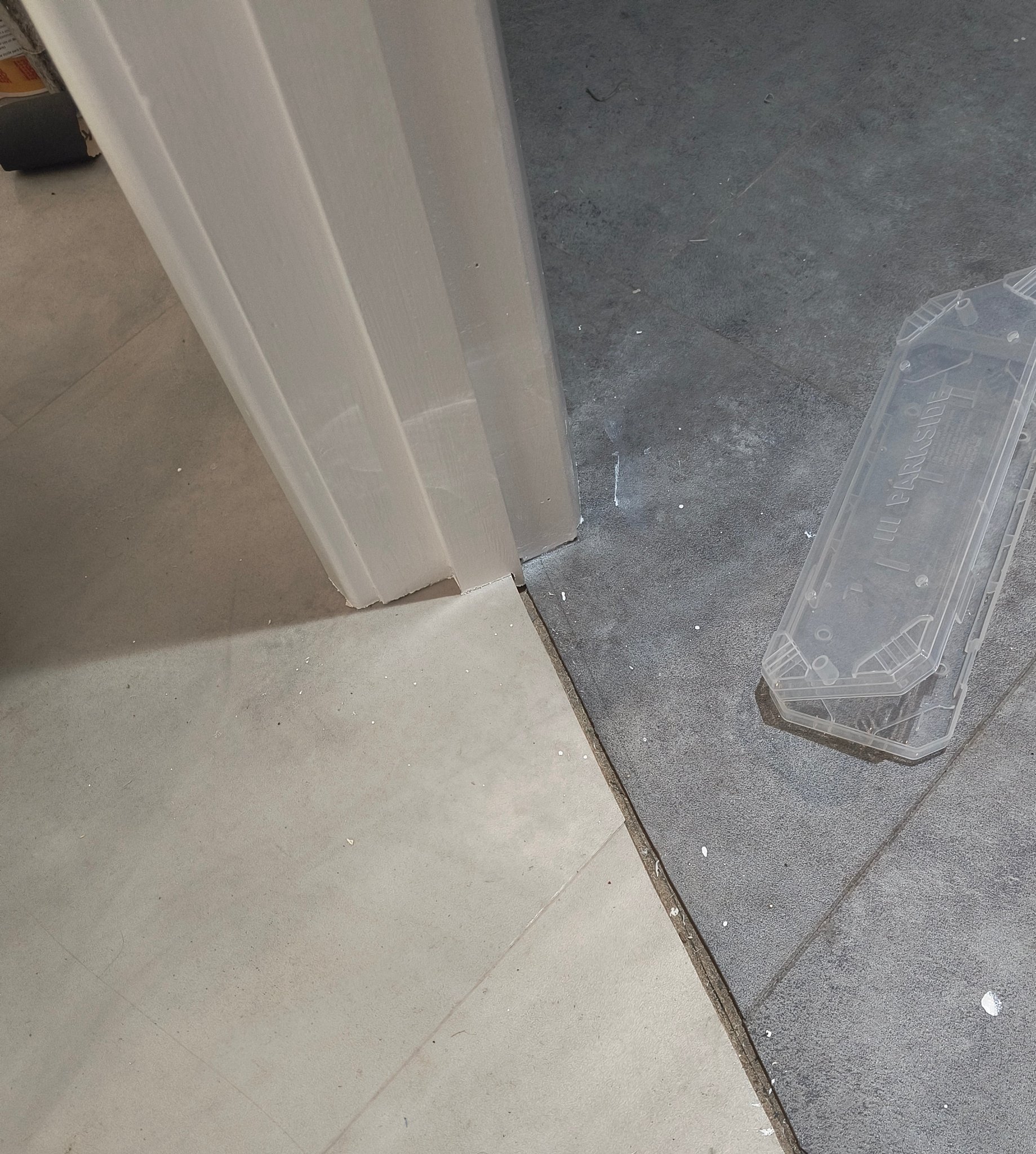

Best threshold strip for this
22 Nov 2009
4,020
1,142
Oldham
Height difference is 11mm.
I would prefer aluminium.
Stairrods UK 12mm Ramp profile would be perfect, available in Chrome, Bushed Chrome, Satin Nickel, Pewter or various gold finishes and Black.
They look nice, but nearly thirty quid each and I've got 6 to do so I'll need to find something cheaper.
Universal Ally Ramps will do the job but will look like what they are, cheap!
Have a look at CAT profiles or possibly Gripperods Premium range, they may be a bit cheaper than Stairrods UK
Have a look on the all in all trim website for cheaper trims. Are all the doorways short of the doorway like the picture ? You will need to notch the trim around the door moulding.
