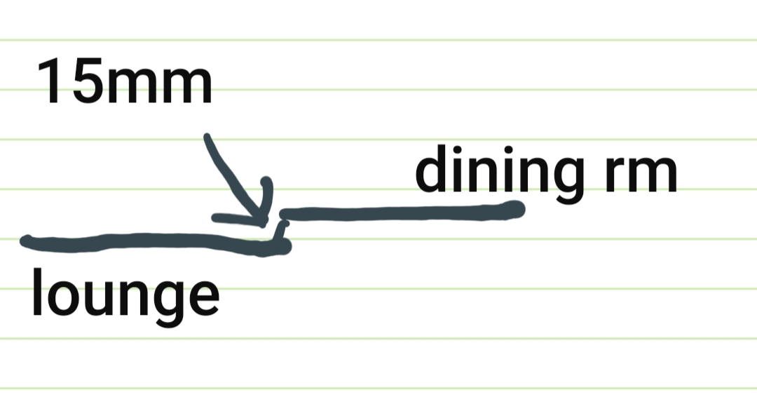

Laid laminate floor in lounge & dining room, at the door threshold between the two there is a height difference of 15mm, can anyone recommend suitable threshold bars that allow for height differences?
