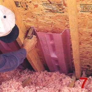

I was thinking maybe something like the pic below would work but I can't find them for sale in the UK. I think they call them eave baffles.

Never seen that stuff before but I have seen a lot of cavity walls filled and insulated with polestyrene balls, which you can buy in large bags generally sold as bean bag filling which you could pour down your voids.
I can see the backs of his tiles so on this occasion I don't think its necessary.
That's right guys. There is no felt. Does that mean ventilation isn't an issue here?
Thanks,
Tim.
Any moisture that gets into your loft will be able to escape through the gaps between your tiles.
