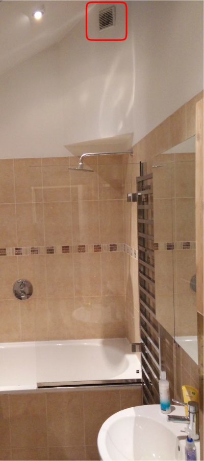

Hi,
I recently moved to a property with bathroom where the fan is above >3m high off the ground directly above the bath - circled in red.
What is the best way you think it can be reached? Will this cost more than usual to fix due to its position if I were to get someone in?

Not impossible. Does the glass shower screen swivel, if not I would want it removed and then you could access the fan with a short ladder. With someone footing it - I guess the floor is tiled?
Just curious - Why do you need to access it? Is it faulty?

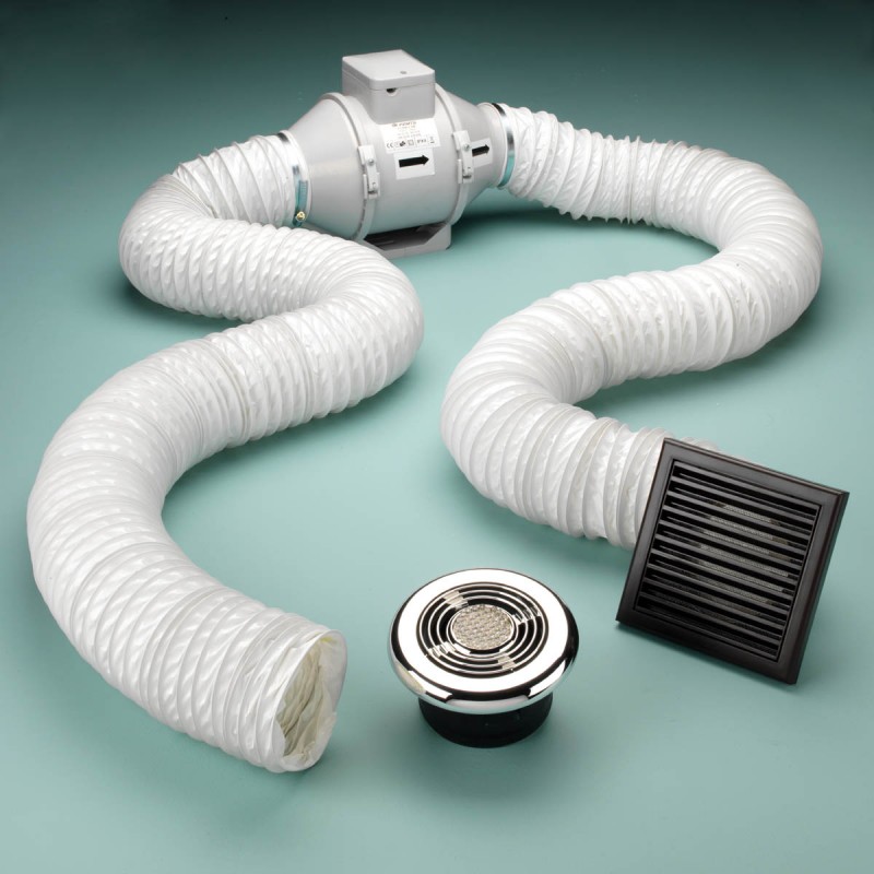

are you sure that's a fan? It looks like just a grille from the photo, is there an in line fan in the loft somewhere?

Yes, its not turning
Have you checked the easier things first? FCU fuse blown, somebody turned off the isolation switch, etc.
Otherwise you/someone has to get s ladder up there. Either per my post above, or dust sheet in the bath, then a sheet of ply, then ladder.
Once there you'll need to know what/how to test it.
Alternately, get a spark in and make it his/her problem

I assume its a fan because there is a lot of dust attached to it
I meant is that just a vent grill for a remote duct mounted fan.
Is there some signs I should look out for which would let me know for sure either way or only way is to go up and check it?
If you have a camera with zoom on or take a pic closer to the fan you should be able to see the fan blades through the slots if its a normal fan
