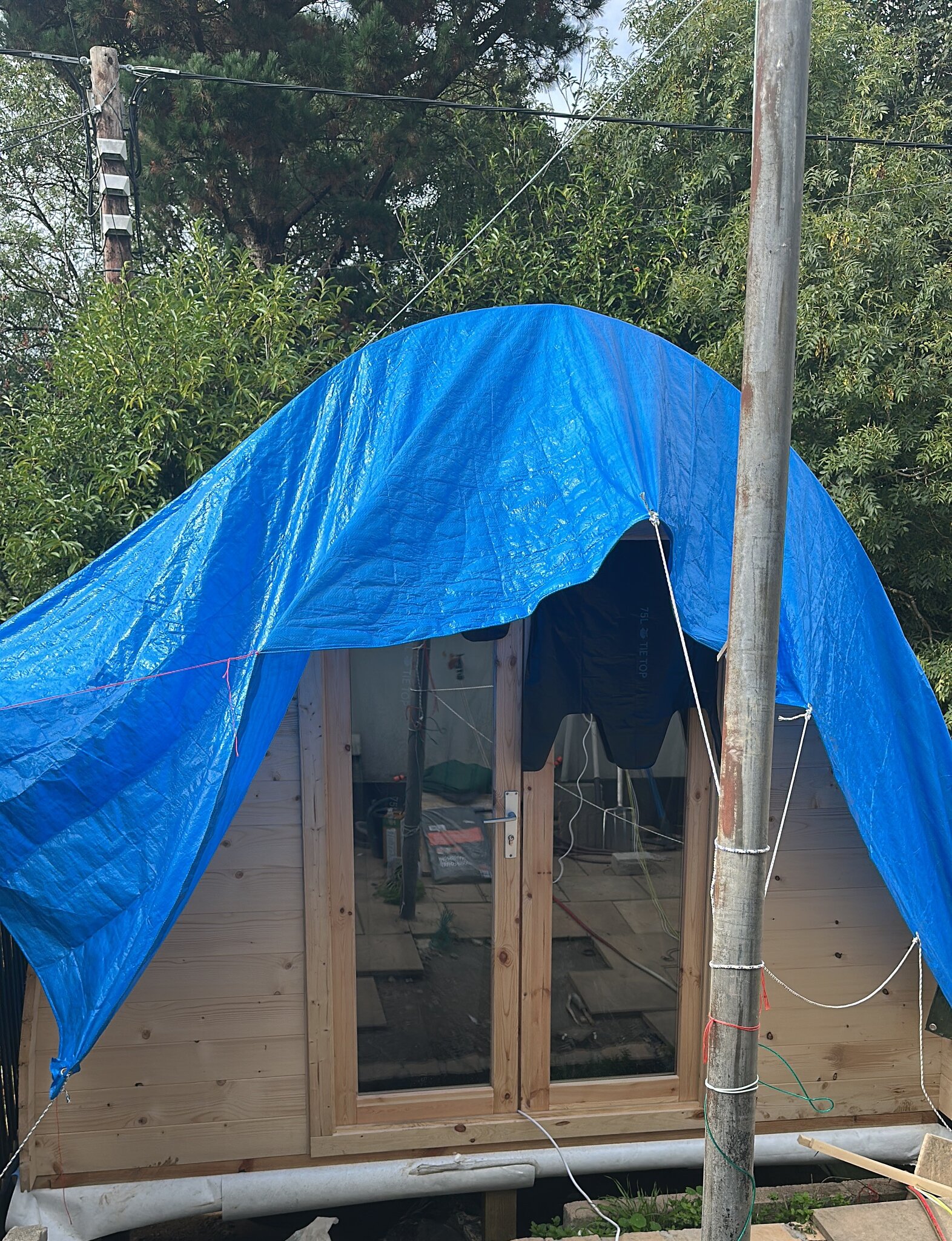

I need to protect and insulate the pod asap, and my brain is spinning with all the info I'm trying to take in. I have 4 questions...
QUESTION 1: Is it worth treating the (un-pressure-treated) wood underneath the membrane/insulation/etc, even though it's not exposed to the elements? If so what is recommended, and low-VOC?

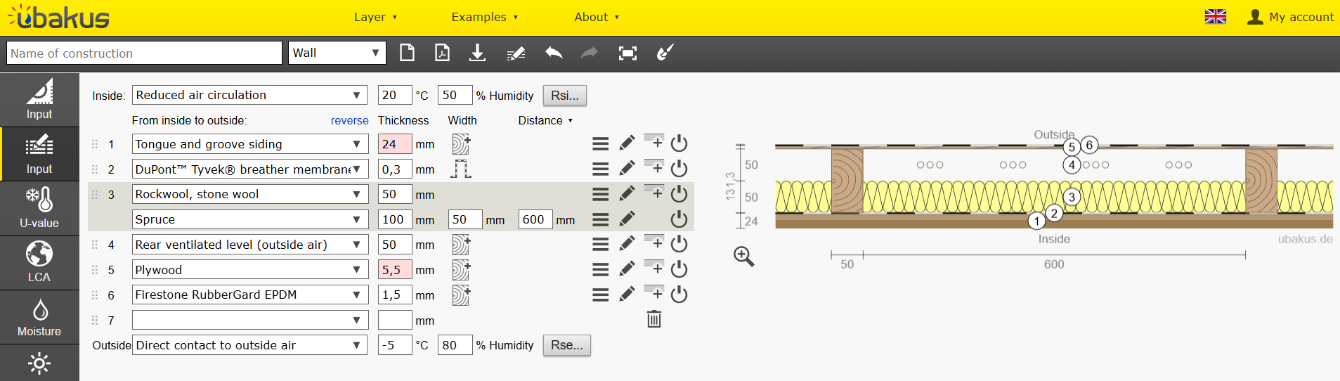

Below are my insulation plans:

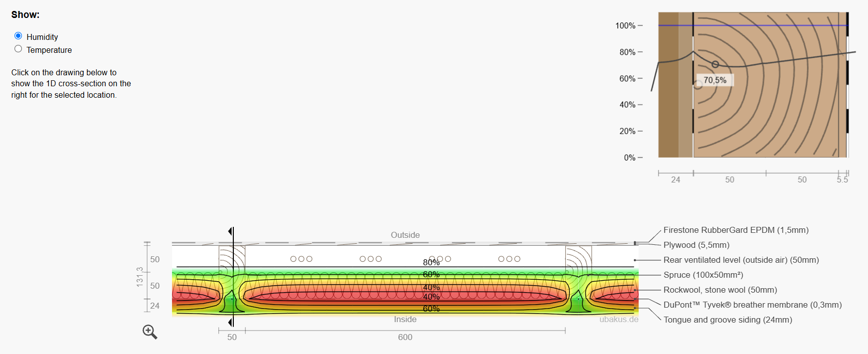

QUESTION 3: Is there a way to address the thermal bridging (?), for example a small layer of insulation on top of each batten?

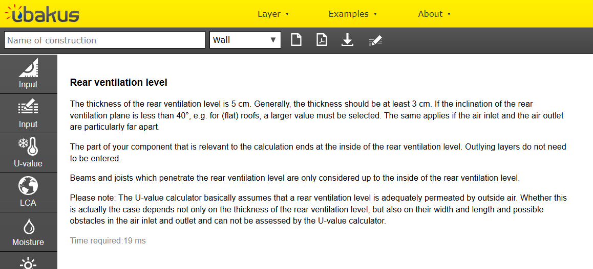

QUESTION 4: Will ventilation (with insect screen) on the bottom of each edge be enough, or shall I add some, maybe, in the tiny eaves?
I originally planned to add a EPDM rubber roof, but I am super sensitive to smells and I wouldn't cope with a constant rubber smell.
QUESTION 5: Is rubber paint the next best thing, if so which one? Will birds make holes in the roofing layer?
QUESTION 6: I can't reach!!
I did not think about the height and need to fashion some kind of scaffolding, if anyone has any tips?
