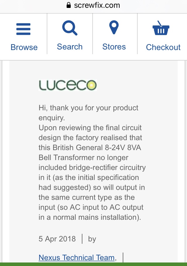

If you want 16V, connect between the terminals marked 8V and 24V. If you measure that, I'd expect a reading of about 20V unloaded.
Yes, I've looked at the 'datasheet', and it is at odds with your multimeter!
I think you may require a proper regulated 12V d.c. supply for your electronic equipment.

From info given so far, and because of the seemingly wrong info from BG, you're trying to power a piece of dc equipment from ac.

defo not a cable issue as when it didn't work I connected a 10cm cable from the transformer directly to the doorbell! hence why then went back to testing terminals with meter. think the issue is it's actually outputting ac and not dc as the spec and I was using about 5 metered of proper bell wire.

I’ve emailed BG support to flag the issue to them. But they knew two years ago that the data sheet is wrong. This is from Screwfix queries about this product.
