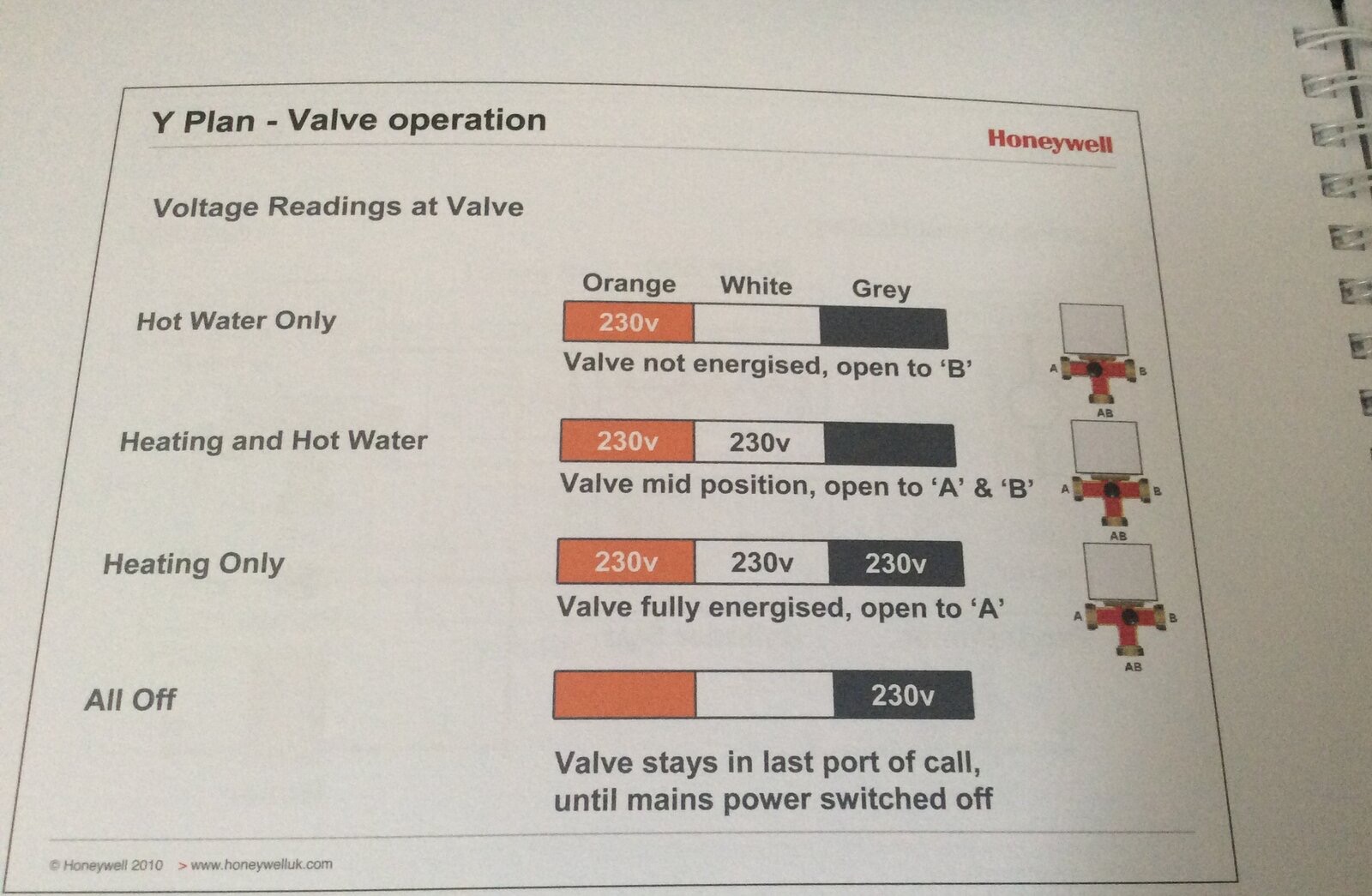

I have a British Gas BGMPSV-23 mid position actuator which is faulty, ive tested the motor which works ok and i'm now looking to remove the pcb so that i can test the micro switches (the resistors and diode also test ok)
i did think it would just slide out but something is stopping that happening
any help would be much appreciated (i'm an electronics eng.)
