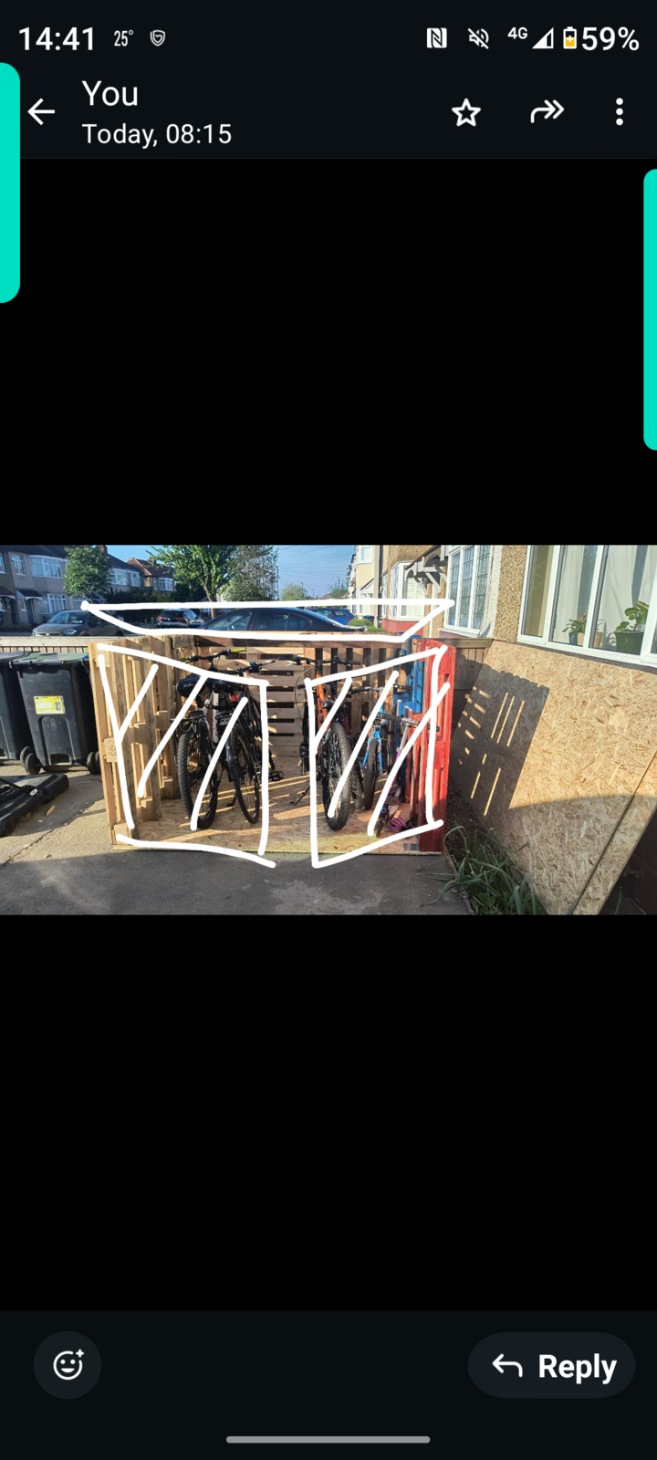

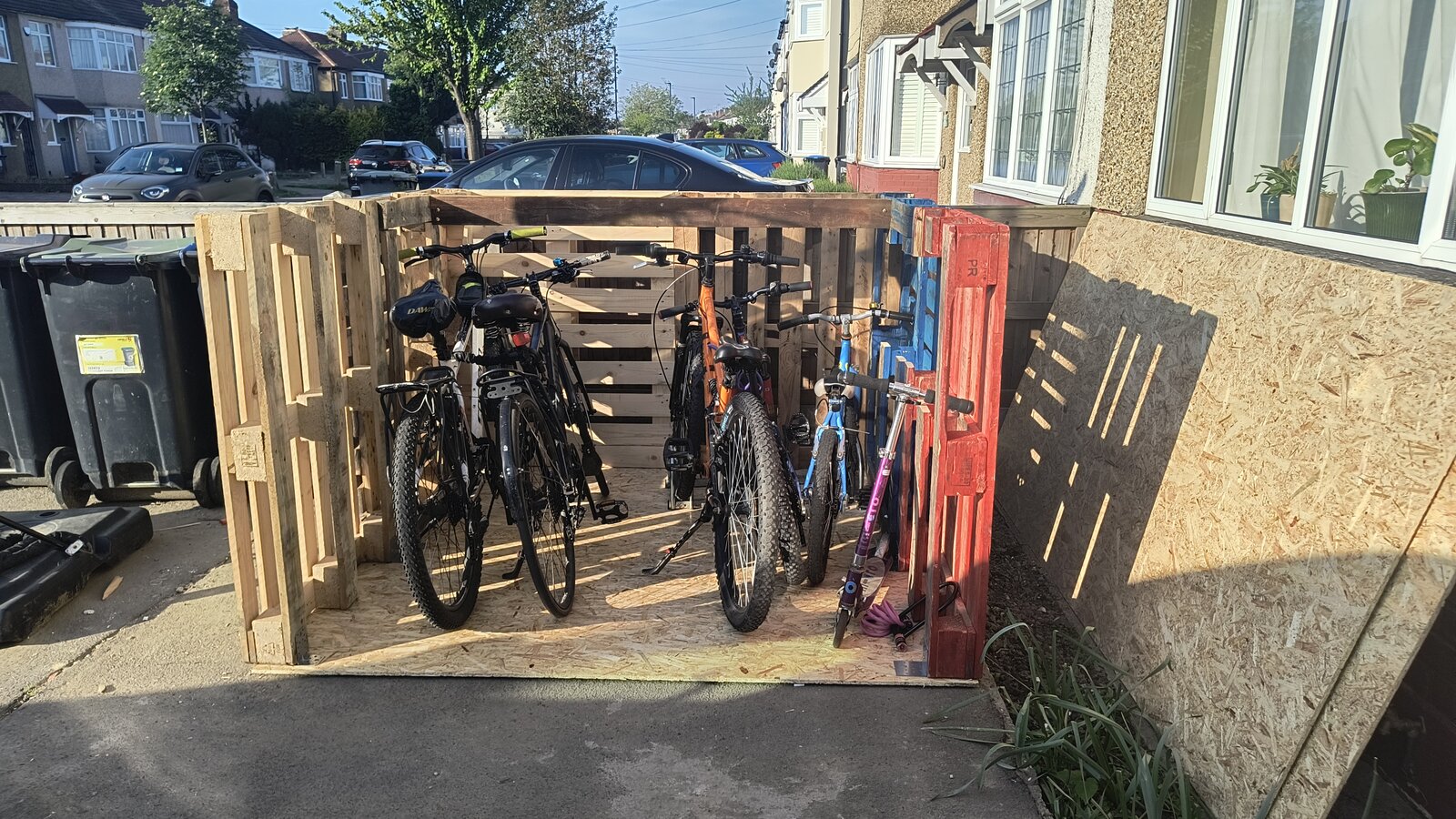

Hi guys, I'm making a shelter for our 5 bikes in the front driveway with the main structure out of pallets and the floor, gates and dynamic roof from 11mm Osb sheets.
I'm attaching two photos, one is the current state of this shed without the doors and the second with a quick illustration of the door and top roof which will be moving up and down on gas struts to allow easy access to the bikes. My vision is to have the roof and the two gates in a closed position lockable only with one sturdy lock. My question is does a lock like that exist? I've seen hasp locks which could be perfect if the male receiving end was split into two sections which meet each other when the gates are closed and allow the female clasp to lock both gates with the roof. But hasp locks I can find seem to only have two pieces not three.
Please let me know if I'm not making any sense and will try to explain better but hopefully the images will make it clear.
Thanks in advance! Shlomi

Hi Harry the link leads to some motorcycle page on face book have I missed anything? An image to illustrate your idea would be really helpful, Thanks a lot
Thanks a lot I understood the idea before I saw the product but seeing it confirms. Its a great idea I didn't think about only issue I've got is my gates will be made of 11mm Osb and with the locks being positioned at the top of the gates I'm worried someone can simply pull them from underneath and break them. That said I can invest in thicker doors...
True. Regardless its easier to screw into thicker material. Will feel better to double the 11mm Osb and turn them into 22mm each gate. The link is still jumbled up but managed to find the item on screwfix with the code in the link. Thanks for all the good tips.

Interlock roof with doors and bolt one door from inside leaving just one door to lock .
You need pallets as a base , osb will rot quickly in contact with ground.
Hey brilliant idea foxhole, to bolt one door from inside and lock only one. With regards to Osb base, I've raised it above the ground by 1cm so hopefully no contact with water.
1cm ? It will get soaked .
Hey foxhole thank you, I won't dispute that possibility, however I have my doubts how often, how soaked and how many years it'll take for the Osb to rot as you suggested if it was to sit straight on the ground. Wouldv3 been interesting to compare the longevity of your original pallete as a base straight on the ground vs my Osb 1cm above the ground to see which will rot first... But it's a calculated risk im taking here and not much at stake given it's a bike shed, with the wheels only touching the ground, and no money spent on material really... What about the gas strut hinges, any thoughts?
