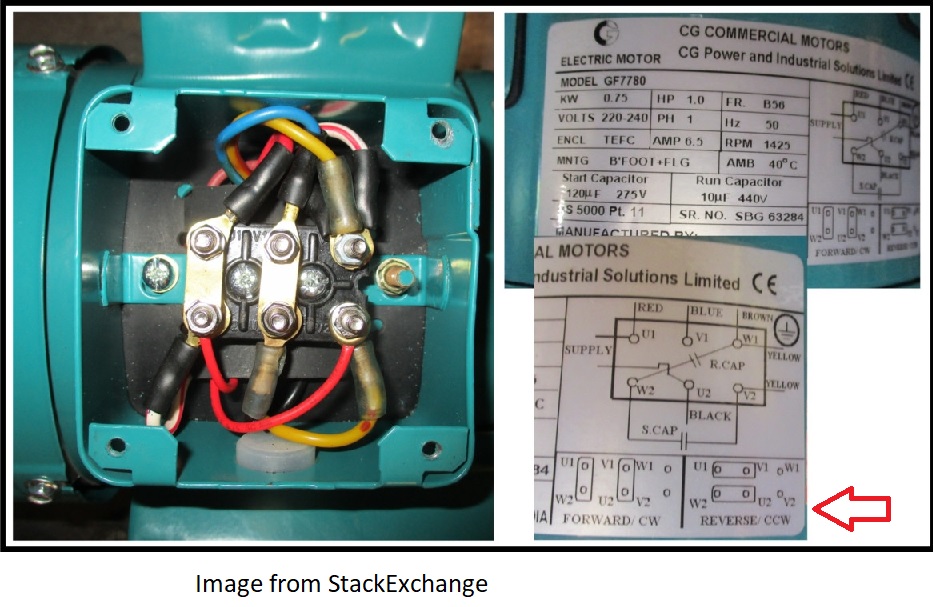

My mistake, it has 4 cables, L N E and a black cable
(Impossible to wire a Single Phase so it runs backwards!)
Not true. Most AC induction motors have two field windings in the stator. Magnetically they are about about 45° out of phase.
One coil is fed direct from the AC supply and the second one is fed via a RUN capacitor as apposed to a START capacitor
Reversing the connections to one of the coils will result in the motor rotating in the opposite direction.
