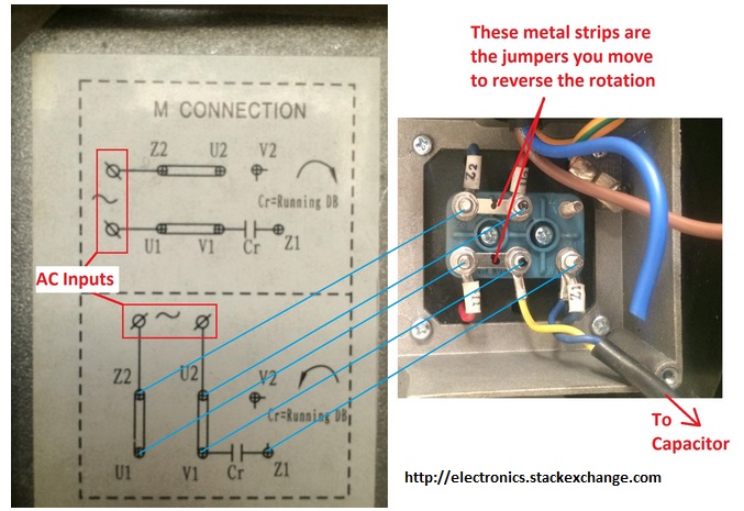

If the motor has a run capacitor then it may be possible to change the direction of rotation by re-arranging the connections in the terminal box on the motor.
A run capacitor is in circuit all the time unlike a start capacitor which is switched out once the motor is running. Details of the make and type of the motor will help to provide more advice as to whether the direction can be changed.
If it's single phase then it must be running the correct way, my simple understanding (happy to be corrected) is that without swapping the windings leads around, it couldn't be reversed. So presuming the motor can only go in one way and cannot be physically reversed, then I'd be confident it's doing what it should.
True but many general purpose motor are constructed in a way that makes it easy to change the direction of rotation by moving links on a set of terminals.
This is a typical set up
That said make sure the motor is a reversable motor with two equal run windings and not a motor with a run winding and a start winding where the start winding is smaller than the run winding.
Quite a process and therefore unlikely the electrician would have performed those modifications for the OP's straightforward motor swap by the looks of it.

I know this is an old thread, but the diagram may be useful to others.
I am refurbing a Biodisc BB at the Moment including wiring in a consumer unit and Motor.
From the above drawing swapping the motor connections for U2 and Z2 should reverse the direction.
