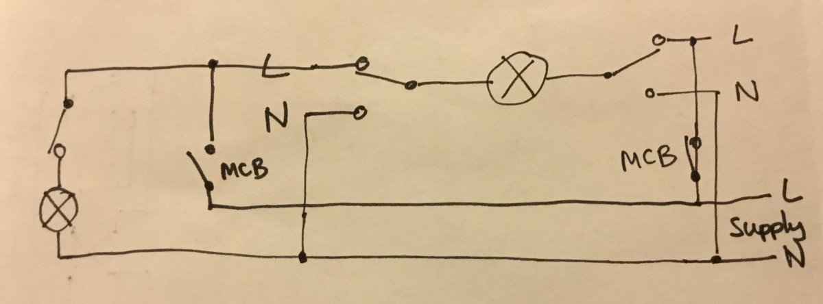

Imagine that you have a two-way-switched hall light wired in this "not recommended" way, and the switches are set as shown, so the light is off:
Now imagine that the left side is connected to the lighting circuit and the right side is connected to the socket circuit.
Now imagine that somewhere else on the lighting circuit, another light (with standard wiring) is switched on.
Turn off the lighting MCB but leave the sockets MCB on.
A current can flow through the two lamps in series, so they appear dim.
Similarly there can be a load on the sockets side that allows current to flow when the Lighting MCB is on and the sockets MCB is off.
Questions: is this a two-way-switched light? (Note that even if it isn't, you may be looking at the other light in the circuit.)
What happens if you remove the bulbs from all the hall two-way-switched lamps?
When both MCBs are ON, is this lamp on or off?
p.s. There are surely many possible explanations other than this one.
It's also more than possible that there are multiple problems with the wiring.
Efficiently diagnosing it will be a great test of your detective skills!
Imagine that you have a two-way-switched hall light wired in this "not recommended" way, and the switches are set as shown, so the light is off: .......... Now imagine that the left side is connected to the lighting circuit and the right side is connected to the socket circuit. .... Now imagine that somewhere else on the lighting circuit, another light (with standard wiring) is switched on. ....
Well, yes, that could do it ... but that would be a pretty extraordinary (and potentially dangerous) way of (deliberately) wiring two-way switching, even if the two switches were connected to the same circuit. Have you ever seen it done like that?

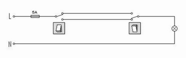

I was under the impression that way was quite common and the reason behind borrowed neutrals on the landing light. Borrowed live would be another alternative though!
Sorry, I missed this one last night. In the meantime, EFLI has illustrated the 'old' method of implementing 2-way switching - as you say, still quite commonly found (and once-upon-a-time 'universal'). I find it hard to believe that the method suggested by endecotp will ever have been regarded as acceptable, not the least because, in one of the 'off' configurations, both sides of the lamp are at L potential (although the light obviously not 'on').

I found that two way system in a couple of houses in the distant past. More recently I came across it when the house owner mentioned that the light switches on the stairs needed replacing frequently and often tripped the MCB. When the switch was operated the arc between the fixed contact and the moving contact continued until the moving contact landed on the other fixed contact. The arc was now crossing the 3 mm gap directly between Live and Neutral and maintained itself until the MCB tripped or the switch burnt out
In the old bakelite and ceramic two way switches there was a large gap between the two sets of fixed contacts. Often they were two separate make switches with a common toggle. The moving contact was far enough away from the fixed contact that the arc collapsed before the moving contact reached the other fixed contact
Interesting. As I said, I find it hard to believe that it was ever regarded as 'acceptable' or 'allowed'.
I can't even think why anyone would have wanted to do it. About the only 'advantage' I can think of is that it does not require any 3-core cable. However, on the 'downside', it requires cables from both switches to the light and also requires L&N feeds to both switches, not to mention the inherent 'dangers'. Am I missing some other 'advantage'?
