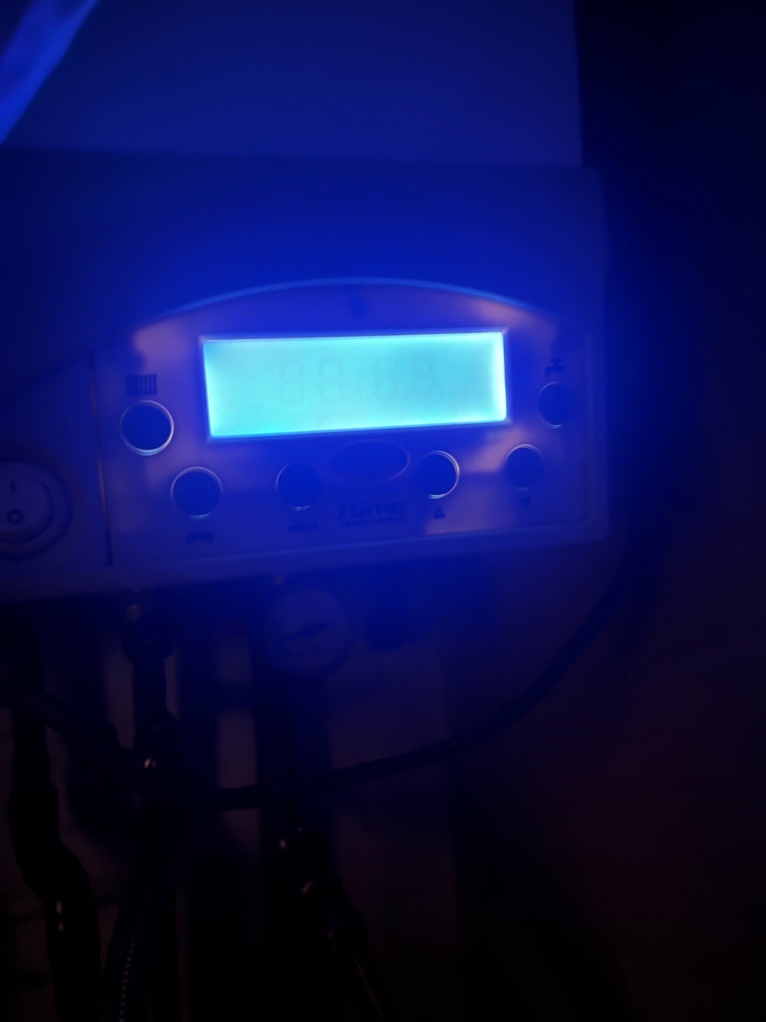

I have an Ideal Esprit 2 combi boiler. I’m not sure how long it has been like this but the display light is just on with nothing displaying? Any ideas?
Hot water and heating working as expected?
The display illuminating suggests low voltage present but display activation ( segments that align to create the information, not being addressed)
Perhaps the display pcb if it has one? Else like above post the main pcb
Check for correct voltage, ribbon cable, et al. Else as above, could be pcb.
