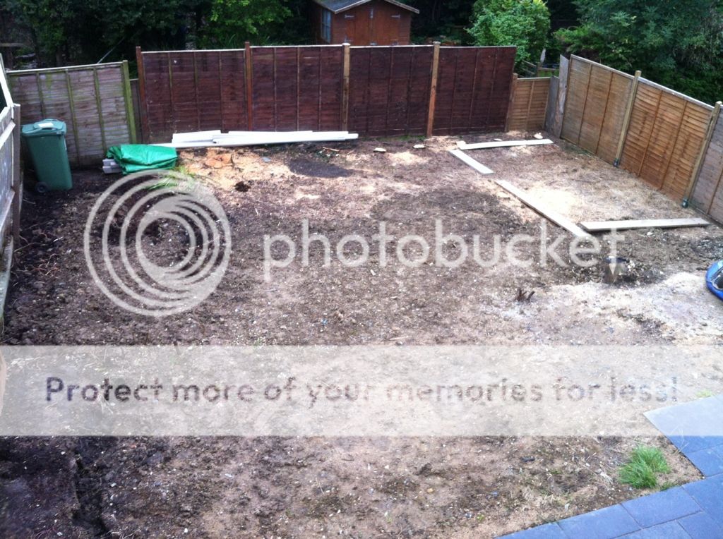

Hi all
I have just extended my back garden :) made a big dent in my pocket :(
I have always wanted a block built shed/workshop. My plan is to clad it with shiplap so it looks nicer.
So i have laid out with scaffold planks roughly what i want. Its 15ftx8ft.
I have already lined people to lay the blocks and build the roof if i go for it, I'm basically looking for other peoples views and possible pitfalls i may not have thought of.
The 3 fence panels to the right of the pictures are the land i have just brought. I hope that makes sense.
Any how here are some pics whats your opinions?
It appears the land falls away quickly past the fence. If that is the case you may need deeper footings.
It will be quicker and easier to build a timber frame building and it has the advantage of being more water-tight and easy to add insulation.
But you clearly are keen to build a block structure and i say go for it. Who cares if timber is a bit easier every man should have the joy of building at least one structure from masonary.
