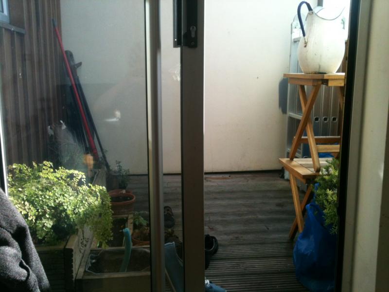

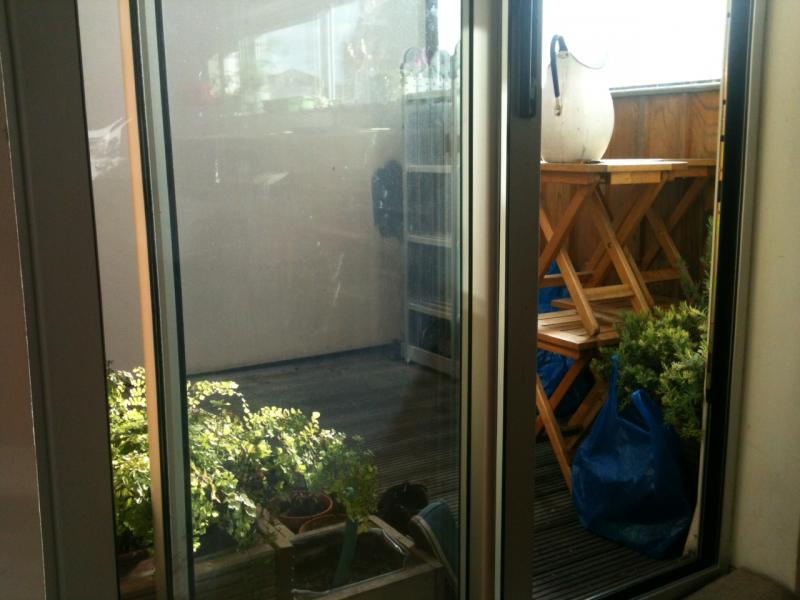

I am planing to install some planters and seating on my little balcony / terrace and then lay new decking. I want to build the planters and the front / base of the benches out of block (aggregate I guess) and the render them.
The balcony is just covered in sanded roofing felt with the current deck siting on that, with drainage in the front.
Can I just build the planters straight on the roof? and if so how do I allow room for drainage? I was thinking I could leave a space between the first row of blocks (kind of castled on the bottom) so water can drain through. Is that just stupid?
Any advice would help here! Thanks.

The balcony is part of the 2nd floor of the house, timber joists spaced at 450mm I think, in short sections between a steel beams and the party wall with the house next door. So the joists supporting the balcony are about 2120mm long, the balcony its self measures 2120mm x 2080mm. I am pretty sure it's all topped off with 22mm chipboard, a layer of ply, dpm, a couple layers of roofing felt, and then the current deck is sitting on 45mm x 45mm beams which in turn, are just sitting on the felt.
What I am thinking is a planter roughly 450mm x 550mm on either end of an L-shaped bench. We were wanting the face of the bench and planters to be rendered block, with the bench its self hollow for storage. We plan to make the top / seating part of the bench out of the 90mm x 22mm balau decking.

Your other major problem is that timber decking or even the structural roof deck is a terrible base for masonary. Block work might crack as it moves destroying your hard work. A better bet might by loose laid systems which are stuck with adhesive such as these
