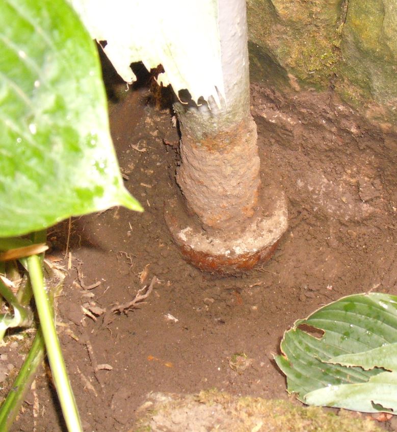

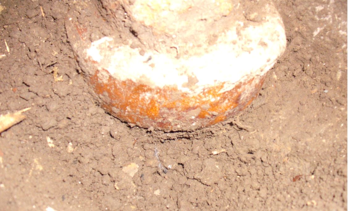

Blocked downpipe turns out to end 5" below ground not connected to anything. What should I do?
Does seem unusual to just terminate a rainwater pipe into the soil, next to the wall, but without digging the surrounding area up to look for any sign of a drain, it has to be assumed it was never connected. I'd be looking to providing some kind of drain to remove the water from the house walls, and channel it to a safer point away from the building. You dont need a surveyor, any Builder worth his salt will be able to lay some drain into a soakaway, or if there is a suitable drain nearby, join to that. (Not if you're on a septic tank though!)

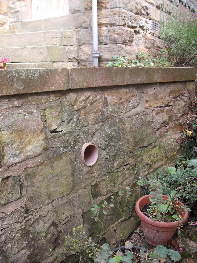

Yes, there is a 110mm drainage pipe nearby that seems to do nothing (never seen water come out of it, although there is some algae on the stonework below it). I bought a self propelling pressure washer drain unblocker and put it in the pipe, thinking it must be connected in some way to the downpipe. All that happened was a lot of earth, snails and then finally sand came out. The 110mm plastic drainage pipe must have been laid in the 1980s by the underpinners, probably because they damaged a similar dimensioned glazed earthenware pipe that must have been there before they did the underpinning. Photo attached of the drainage pipe with respect to the downpipe.
I will now have to buy a borescope and try to determine what the function of this 110mm plastic drainage pipe is. My new theory is: it was 4pm knocking off time one afternoon in 1980, and in a hurry to finish the job, the underpinners didn't bother to connect the downpipe to the 110mm diameter drainage pipe, and just put back the earth and stones - who would find out? - if true, it has taken 39 years to come to light! I will post further as new evidence comes to light. The puddling in the cellar, only after heavy rain storms, is probably due to a P trap on the other side of the house being full of sediment (a gully grate stops leaves and bigger items getting into it) but water was observed to go down the gully too slowly, causing it to back up against the stone work. There are also of few inches of missing or cracked bevelled rendering at ground level that connects a cracked concrete back yard (horizontal) and to the stone wall (vertical) nearby the gully and P trap full of sediment that caused a small amount of water to back up sometimes.

Pipe in the wall may possibly be there to drain any build up of water behind the wall, (which could have been an acute possibility given the rainwater downpipes didn't go anywhere!), and was never connected or intended to be connected to the downpipe. I suspect you may be right in that it was a replacement for a previous clayware pipe.
If the discharge from this pipe isn't going to have an adverse effect on the area underneath, and/or wall below, it may well be worth looking at connecting the downpipe to it, under the patio. Just provide some form of drainage for any accumulation of water behind the wall.
Wish I had taken pictures at the time but my drainpipe did the same -- down the side of the house and into the tarmac driveway.
When we had the driveway dug up and a new one laid, we found the pipe went about a foot into the soil and that was it. No soakaway, no channel, no pipes, etc. As a result, the mortar between the foundation blocks was pretty much non-existent and they were visibly damaged from years of rain water pooling under the surface. It also explained why the wall the other side (hallway) would get moldy in the winter.
Had the pipe go into a proper drain and sloped away into a soakaway. Not had issues since.

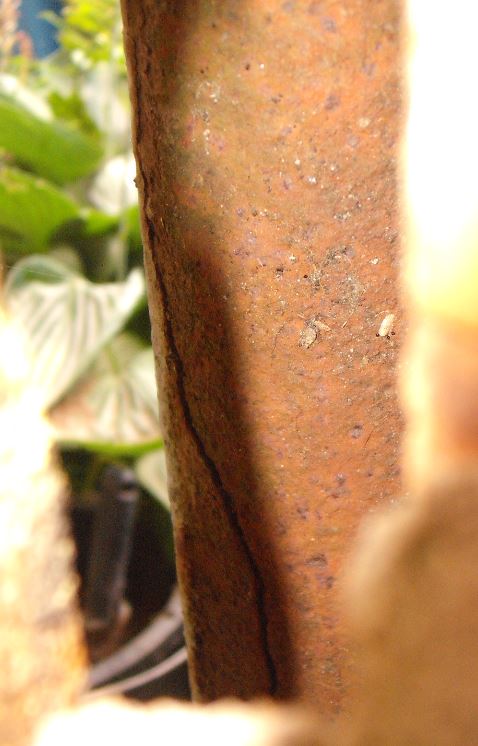

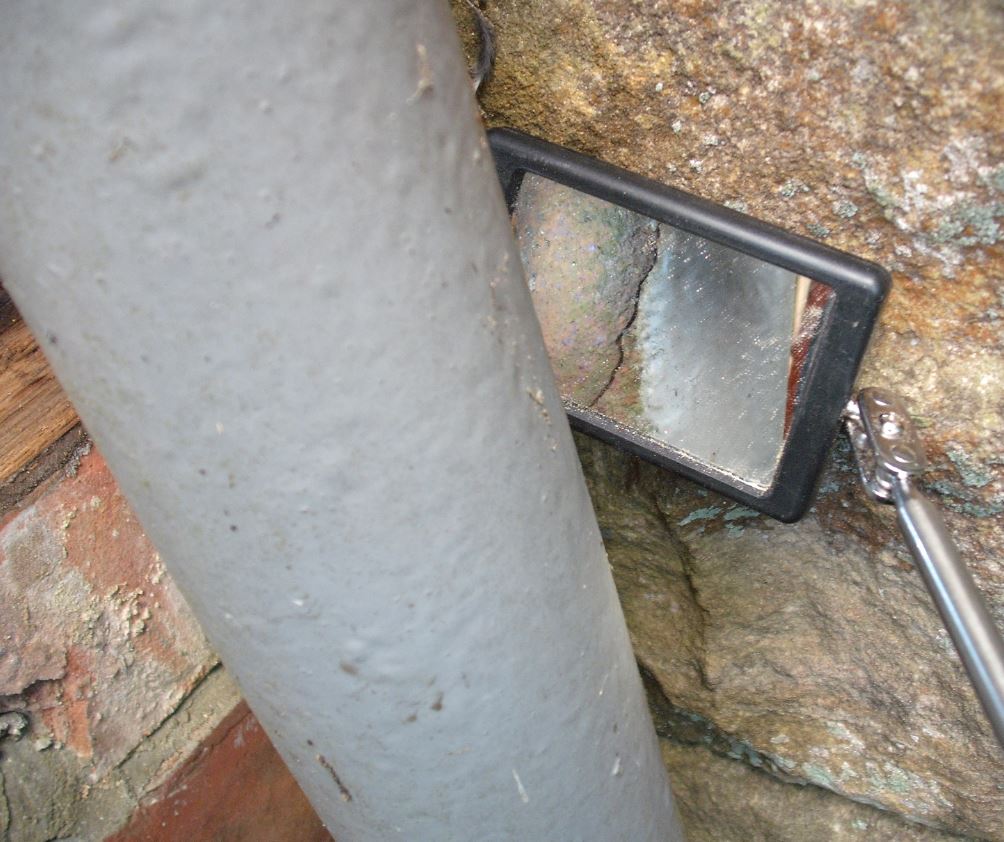

I have now found a much more suspicious cause, quite by accident, while doing a completely unrelated task (removing a plank of wood from a shed that was infested with wood lice - it enabled me to see a 10" long hidden fracture in another round cast iron downpipe that is up slope from the cellar). It may not be the only cause of the damp in the cellar (thanks to the poster who suggested Edwardians/Victorians did not use waterproof membranes below concrete floors).
I will try to start a new thread, if that is more helpful, to deal with the most likely cause of the damp in the cellar: how should I repair fractured 2.5" round cast iron rainwater downpipe connected to a socket of a vitrified clay pipe, a socket whose OD is about 5" to 5 1/2": how do I ensure the repair solution enables low cost recovery of silt and moss at ground level while using traditional materials (prefer metal downpipes above ground). The first photo shows the view of the downpipe after removing wood lice infected plank, and the second of why the fracture was never spotted.

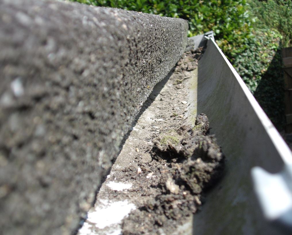

If it is a bit defeatist to assume moss will end up in the underground drainage system, then it is because I think the birds drop moss in the gutters (not the only way it gets there), and being cunning blighters, will drop it threw holes in any balloon guards. I worry about sediment getting into the underground drainage system and causing backup of water in the downpipe, and the freeze-thaw cycle in winter fracturing the pipe, although I don't doubt the pipe is close enough to the shed, where a misplaced hammer blow by the builder putting on the shed cladding many years ago could have caused the pipe fracture.
How is the cast connected to the clay? Best course of action I'd say is to replace the damaged cast section in it's entirety, worst case scenario would be you have to cut the clay back slightly and make a new connection there. If you can get a photo of the existing connection between the cast and clay, it may help judge that situation.
Cast can fracture through age, also is it's a rigid connection to the drain, (i.e. mortared in), then this wont help absorb any slight movement that may occur. Same principle when iron gas/water mains fracture.

There is an horribly greasy(very) none setting tape you can buy in a roll, which would seal that up temporarily - sorry I cannot remember its name. Maybe Denso tape? Where it joins the clay pipe, I would expect it just to be sealed with mortar. Rope pushed in to make up the gap, then filled up with mortar.
Where cast iron pipes were joint, I seem to remember they just hammered lead in to the gap to fill it up.
To fix it permanently, cut the cast iron pipe off square - angle grinder carefully or hacksaw. Then install a short bit of plastic. The easy way to get the cast pipe out of the mortar, is to drill numerous holes in the mortar until it frees. Then make up the gap as before, rope with mortar on top into the clay.

with ref to the pics of the cracked RWP pipe(s) and its connection to the clay hub - for best practice you will have to remove the full length of pipe from hopper or gutter outlet and, after examination, either remove the damaged bit of pipe or skip the whole length, and replace with new CI or plastic.
at the hub, dig down and expose the horizontal piece - cut it at a convenient place and connect a trap to pick up the RWP.
Looking at that, I suspect the cast pipe was simply placed into the clay socket, a piece of sacking or similar wrapped around to prevent debris getting into the drain, and the joint sealed with mortar. It's doubtful that joint will come apart without breaking something, (clay probably), so you would be best cutting the clay at a convenient point, and redoing that section. Modern jointing methods will allow some flexibility, so going forward, any movement should be accommodated. (Going to be pedantic, but should point out, that old drain is 'Salt Glazed Stoneware', the new clay drainage is Vitrified Clay.)
Unlikely a silt trap was ever fitted on that, a direct connection was made to the drain, which would lead to a soakaway. Any rainwater connection to a combined sewer in that era would have been via a trapped gulley. The presence of soil pipes nearby is probably unconnected, the drains would have been laid as required to suit the building layout, and rainwater and foul drains passing over/under each other where required.
Dye testing can help trace drain runs, but only if the dye can be seen downstream. Given it seems likely these rainwater pipes are heading for a soakaway, dye testing would probably be a waste of time, so it leaves sonar tracing, (expensive), or a bit of old fashioned digging. Provided you only clear the soil from above the pipes, there shouldn't be an issue, you only need to ascertain the route, not the condition.
I'd get a 9" angle grinder for cutting the clay pipes, anything smaller will struggle, (bear in mind the pipe wall is at least 1/2" thick), and then swapping the stone disc for a metal disc, should allow you to cut the cast above the socket if it aspires the cast has been joined with run lead. Not sure what you mean by 'high priced silt scoop grabs', but Wickes do a wet vac for about £45 which is ideal for cleaning out gullies!

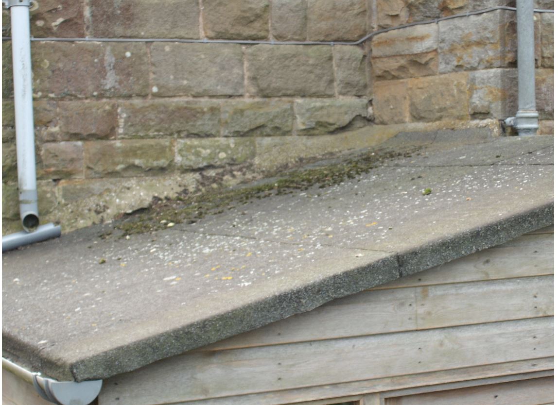

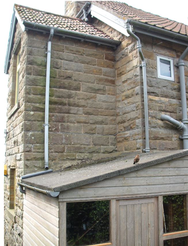

Yes, I see there is no way to slot in sideways the new section of cast iron down pipe without removing the entire downpipe above the damaged section. Cast iron downpipe isn't exactly conveniently flexible, is it? I need about 4" of vertical clearance to get the section of pipe in. The rainwater cast iron downpipe that includes the fracture is the one in the middle with two successive swan necks connected to the gutter.
Having to disconnect it all would turn a £100 'cost of parts' job into a £3000 one perhaps if I have to hire scaffolding, etc. since the swan necks protrude out over the shed roof, and the shed roof is not great support for a ladder (the builder probably did not use good quality marine plywood for the roof and may have economised with some sort of chip board covered with a thin veneers of better looking wood that hide the structural weakness).
I am right out of my DIY comfort zone having to take down the entire cast iron downpipe right up to the gutter but on the other hand the professional builder who installed that plastic guttering and downpipe to the left of the picture (about 30 years ago?) has maybe not served us well other than to keep the bills down (he acted the way he did I assume under pressure from my father to keep costs down, which pleased my father, but my father didn't understand or know about the short cuts taken to achieve the desired bill). As a non expert in these matters, so I can be wrong, I think the arrangement to drop water from a jerkin roof on to a tiled roof below is a bit Heath Robinson (I am sure the original Edwardian era rainwater collection system was better than that). Second, the shoe of the plastic down pipe above the shed roof is held on with a rusting screw (not solvent welded?). Third, the gutter on the shed roof is screwed through the asphalt into the shed roof (I can't think of a better way to promote water ingress into the wood of the roof below the asphalt). Fourth, the pitch of the gutter on to the shed roof causes water to rush over the edge of the gutter below if it rains very hard (I have sanded off all the resulting algae and black mould that was on the wood below this gutter, although the designed arrangement probably works about 80% of the time as intended). Fifth, the gutter below the shed roof is attached to the plastic elbow that disappears into the shed by another rusting screw instead of being solvent welded.
I have doubts whether the Edwardian era cast iron downpipe inside the shed, which I assume is connected to the same salt glazed stoneware drainage system as the fractured cast iron downpipe about 8' to 10' away to the right, was designed to cope with a builder installing a rainwater collection system that effectively collects moss from a) the shed roof b) the tiled roof and c) the jerkin roof (also tiled but higher up). It was maybe originally only meant to collect rainwater from one of these roofs. The difficulty of cost effectively cleaning these high up gutters without scaffolding or without a very long-reach expensive cherry picker, one that would have to be with mega anti-tipping stabilisers and be situated outside the garden walls, may be the cause of moss getting into the underground drainage system, for the plastic pipe that disappears into the shed is connected to the exposed part of this Edwardian era system. At 800' above sea level and in an area of high winds, the small amount of moss on the shed roof (only in one sheltered corner) may mean the rest of it has been blown off into the shed gutter.
I wonder if that drain might have been blocked too and the lower part of the pipe filled up with water, which froze and split that pipe?
I am 85% certain you are right. See pictures of the moss. Also, a blockage means water probably only backs up and seeps out of the fracture in heavy rain, which agrees with what I see in the cellar: light puddling only after heavy rain.
Below: some moss in the shed gutter
