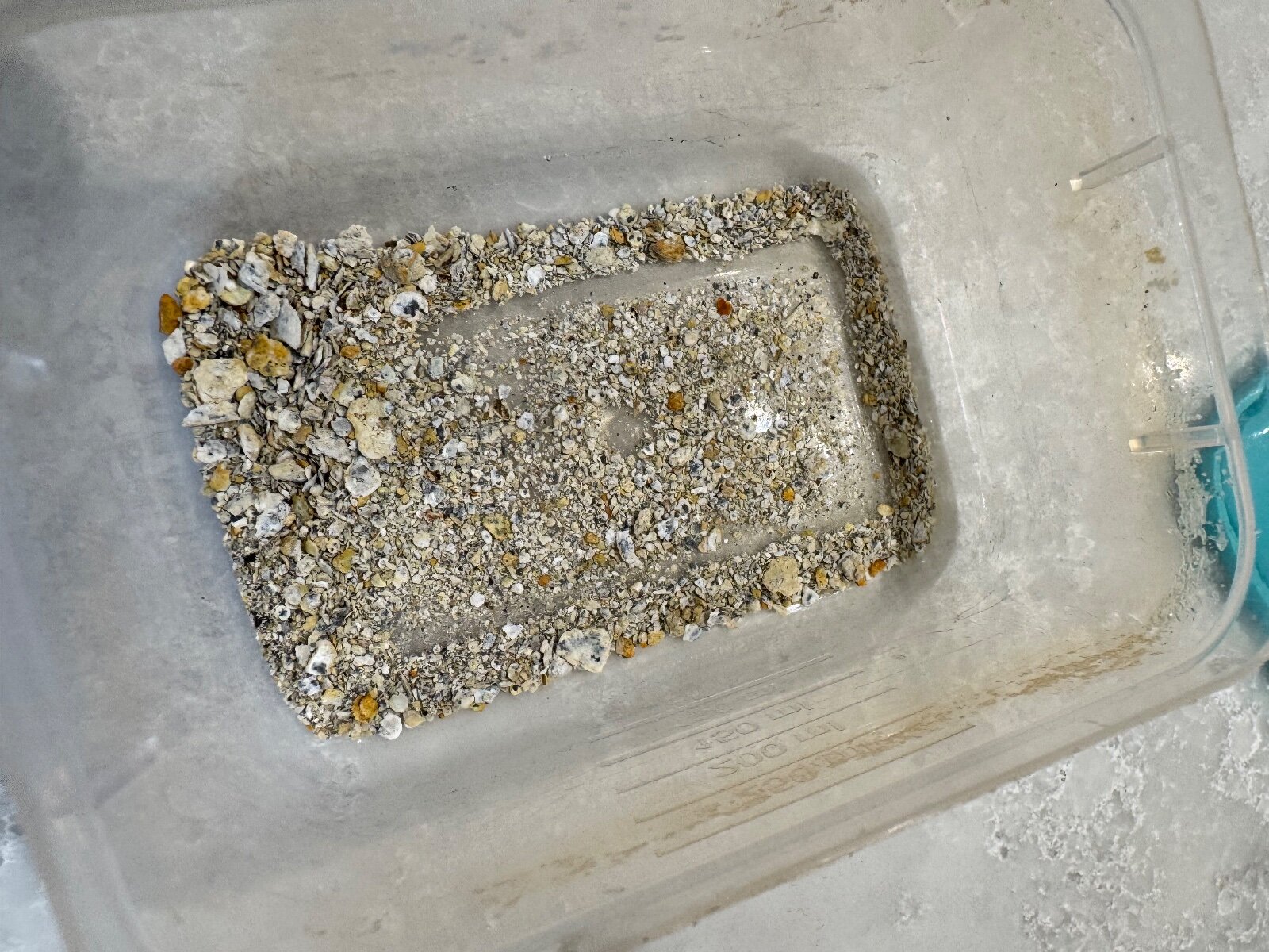

I have a Worcester Greenstar 30i that’s 9-10 years old, about 3 years ago the heat exchange plate all of a sudden started getting blocked with what’s in the picture attached. I’ve had it cleaned out, exchanger plate replaced twice, every radiator in the house has been replaced, inhibitor put in the system, electrolytic inhibitor installed and nothing has stopped it. 2 months after having all my radiators replaced it’s blocked again and I’m losing the will to live, nobody seems to know what’s causing it. Is it limescale, is it corroded copper, is it the plastic pipe, is it a deeper problem with the boiler? I live in a hard water area but why was it ok for so many years before? My British Gas friend who has to clean the plate out and keep changing it doesn’t know either, said he’s never seen anything like it before. Please please help!!!

Looks like limestone chippings rather than limescale. What’s the temperatures set to?
60 will be to cold for central heating though won’t it? Is there anything else I could do to keep it on max?
I just don’t get how it went for 5 years with no problems on high temperature and then it doesn’t work
Pressure seems to be fine, I was having to regularly but pressure vessel needed changing and then didn’t need topping up anymore but problem with plate still carried on
My thought - Constant topping up, means fresh input of hard water, and a fresh amount of limescale to build up. That would become loosened, and block up the plate.

You say the rads are getting bunged up which means the primary water side, you mention the exchanger plate, do you mean the main boiler heat exchanger or is it a combi boiler which will have a PHEX (Plate heat exchanger).? If it is a combi then the DHW side of the PHEX should/might show signs of blockage as well, did you look at this side?.
It was happening way before the pressure vessel needed changing so wasn’t having extra water put into it for the first 2 years it was happening, the vessel only went quite recently
It’s a combi so plate heat exchanger, it’s in both sides of it as well, I thought changing all my rads that needed doing anyway, a new plate heat exchanger and a fresh dose of inhibitor would work but sadly not
It might be worth getting the mains water and the scale analysed/tested since this is the common denominator, even though the primary side was not being topped up and you were getting the same problem, the system was probably refilled from the mains.
If not done so, Install a combined mag & particulate filter on the boiler inlet, it might catch some of that stuff., even if only a temporary measure.
