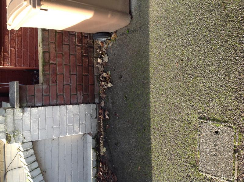

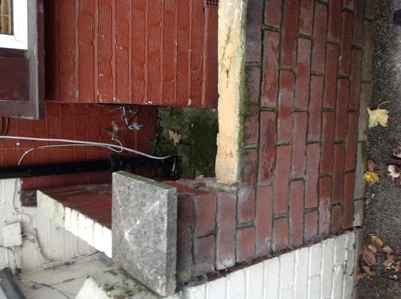

We live in an 80 year old mid terrace and have a problem with damp in our front walls.

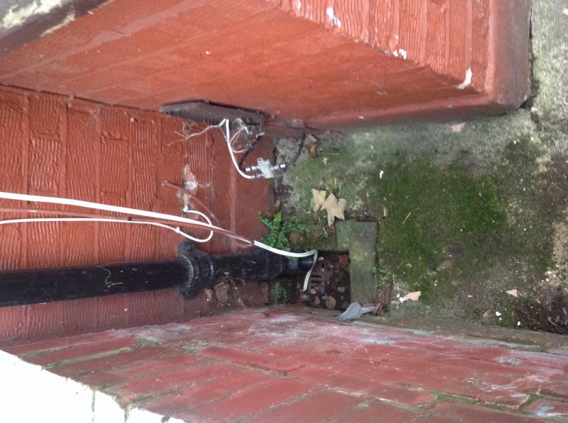

Just outside where the damp seems worst, we have the gutter downpipe for the surrounding terraces. It is cast iron and has a downpipe shoe at the end going into a sort of gulley type drain and presumed soakaway underneath.
Every time it rains water will collect at the front of our house between the front wall and a front boundary wall (about a metre in height, maybe 60 cm between the front boundary wall and front house wall)). Apart from the drain the whole area is concrete.
Im not sure how best to sort the problem. Assuming the soakaway is blocked (highly likely due to the amount of moss and leaves on our roof and the age of the property) how would i even go about digging it out? Would it also run under the pavement? This seems unlikely in principle but im not sure how else it would be big enough to drain the water away.
Another idea id thought of (im sure id not be allowed) would be to divert the drainpipe into the road by removing a brick from the boundary wall and connecting a short section of plastic pipe between the existing downpipe and the brick wall. This would lead to the water flowing over the pavement into the road!
A friend has suggested breaking up the concrete at the front of the house and replacing it with some decorative shingle. This would allow the water to soak in over the area but im concerned it would just increase the problem.
Whats the best way to solve this in a property of this age?

Are you sure it doesn't emerge somewhere at kerb level to run into the roadway drain? Are there any gratings or covers?
Cheers
Richard
Hard to tell from the pics but it looks as if there's a cast-iron gulley in the pavement to the left of your downpipe (or it might be a decorative cobble, can't tell, there are leaves on top of it). See if that is a gulley and if it emerges from the kerbstones onto the road (I'd be amazed if it doesn't).
I know it is offset from your drain but there's nothing else near it so if it is a gulley then rod it (from the street) and see what happens- given the age of the place I'd be amazed if there was a soakaway

Good spot for noticing the metal fitting on the pavement.
There are perhaps two metal external stop box covers on the pavement. Both leaf covered to some degree.
The one to the left of the boundary wall is perhaps your neighbour's Stop Tap box ( the cover seems to be open).
And the one to the right might be for your water supply - i could be reading too much into the square'ish shape below the leaves?
Why dont you first clean out the gulley trap below the RWP? Does the RWP drain more than one property?

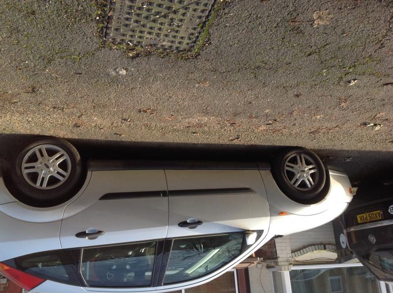

A pic of the front elevation showing your and your neighbour's houses and the pavement might help?
Note: the sand & cement plinth at the base of your elevation wall, and bay wall, should be removed - there is only one 9" x 3" air brick in sight?
Yes. This was highlighted at the survey and a suggested cause oft he damp as it bridges the dpc. How would i remove it? Chip it off with a hammer?!
The metal square things near the wall are to do with now defunct cable. I think all the houses here must have had it installed some years ago. Either way (as you can see from the earlier pictures) its in a bit of a mess.
Having done some looking around in the road i can see nowhere obvious that the RWP drains too. I did find three 'manhole' covers outside in the pavement level with the rainwater pipes butt hey say GPO on so I reckon must be for telephone cables (was so excited at first - though i might be able to rod back!). The only other drain is a proper sewer manhole in the road.

Sorry about the crap pics again - i promise im not getting them the wrong way round deliberately!
