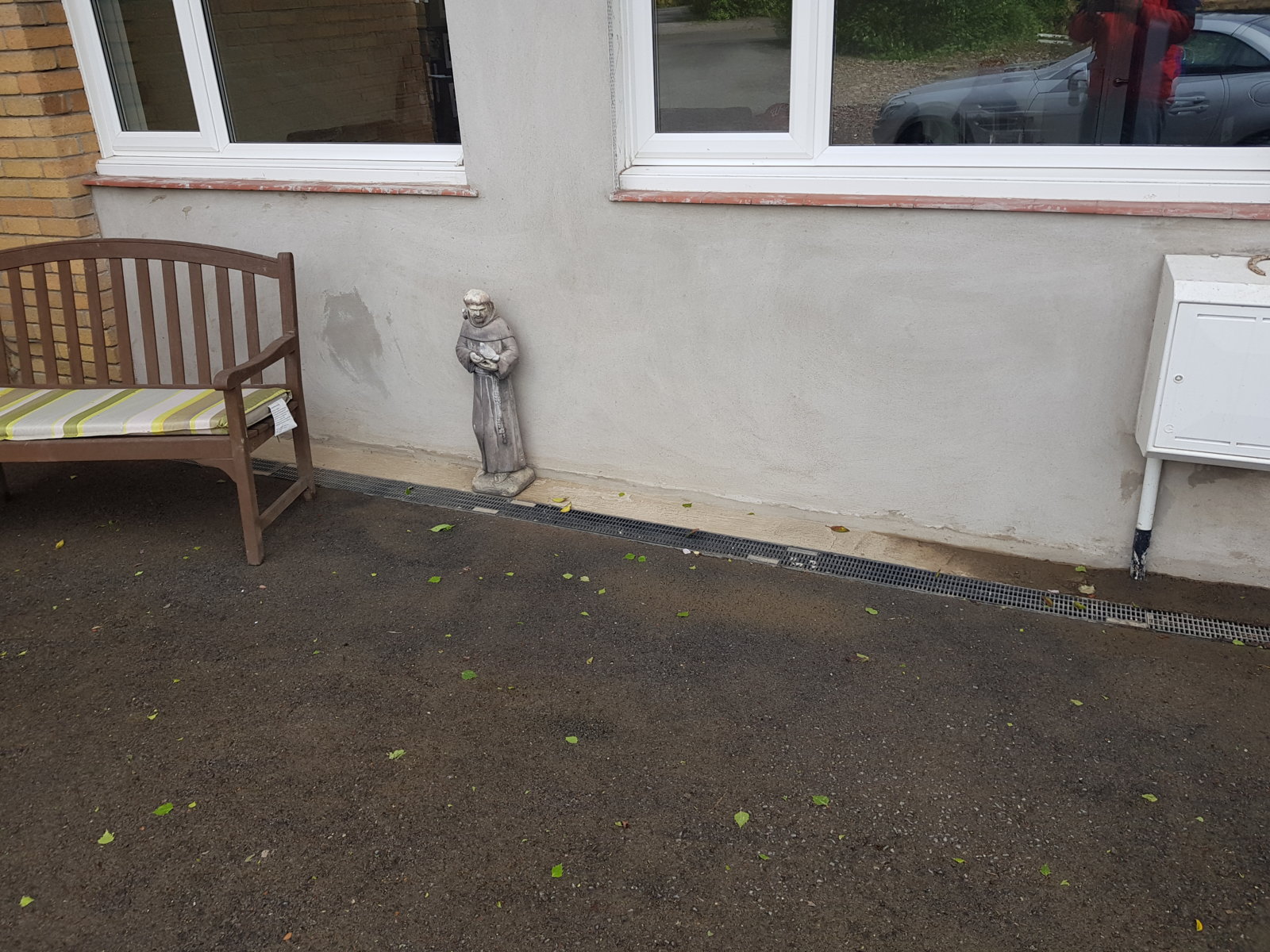

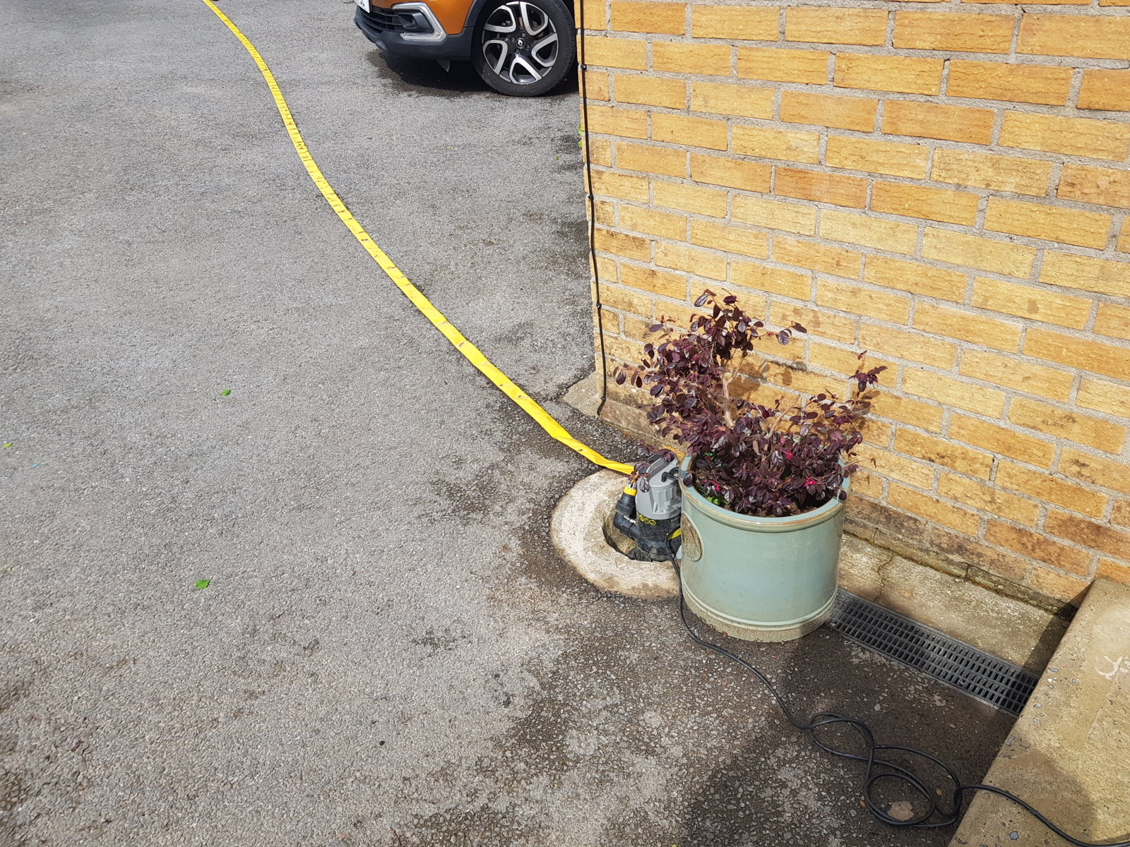

Please see attached files as you can see the front of the house has recently been rendered the rainwater will rest against this when we have a massive downpour.The pump does its job keeping it down as you can see just below the window there i

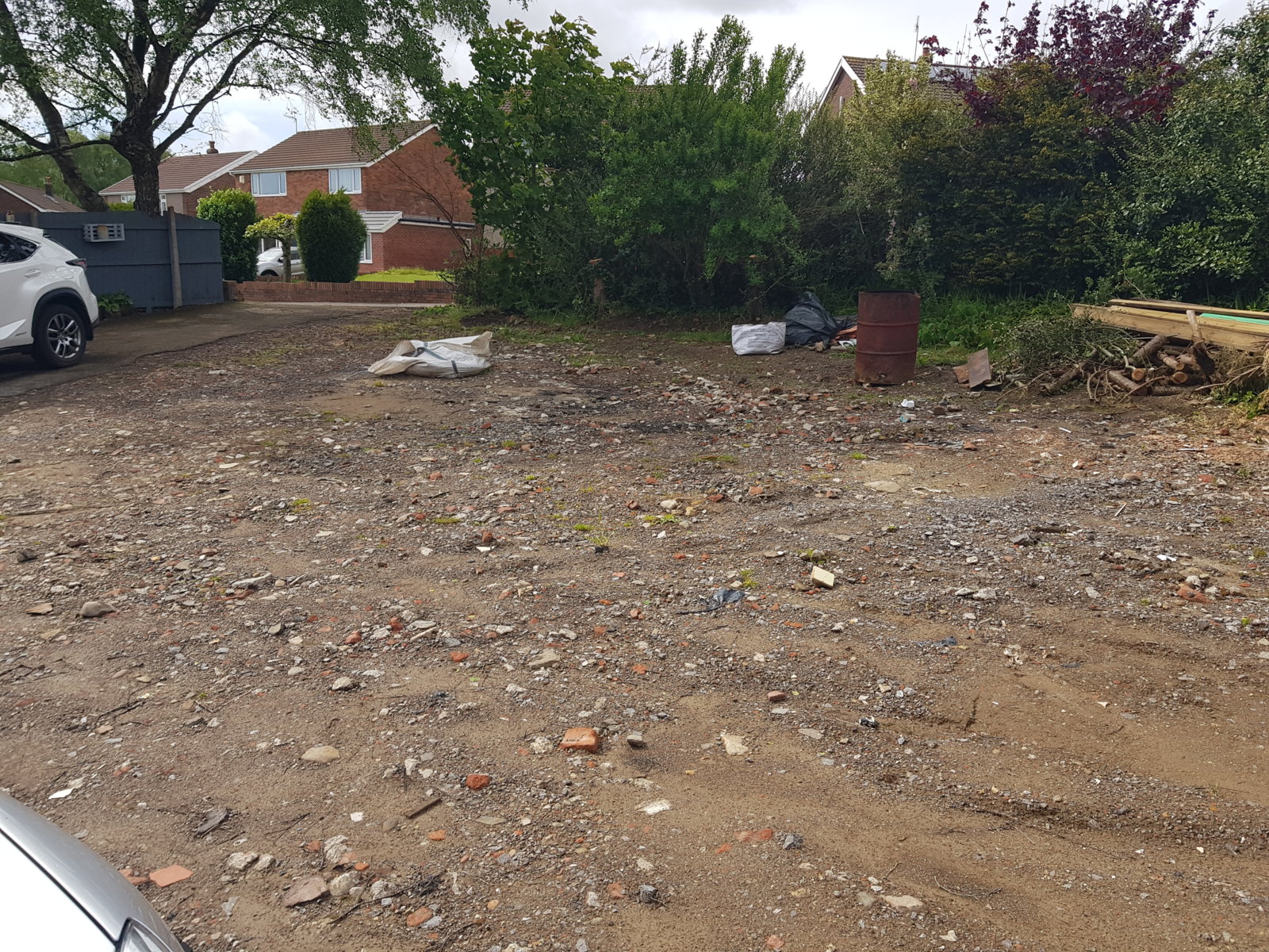

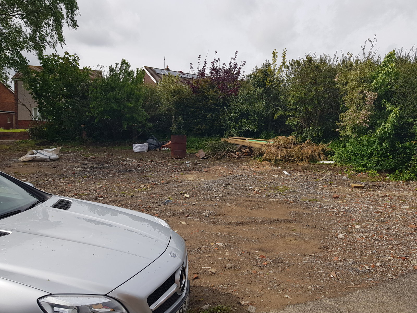

is a grid drain leading to the gully and the pipe leading to the soakaway 7 meters away on the ground where there was a wall earth.
This piece of land needs to be landscaped as it has got hard core rubble on it at present and the drive has an incline l
