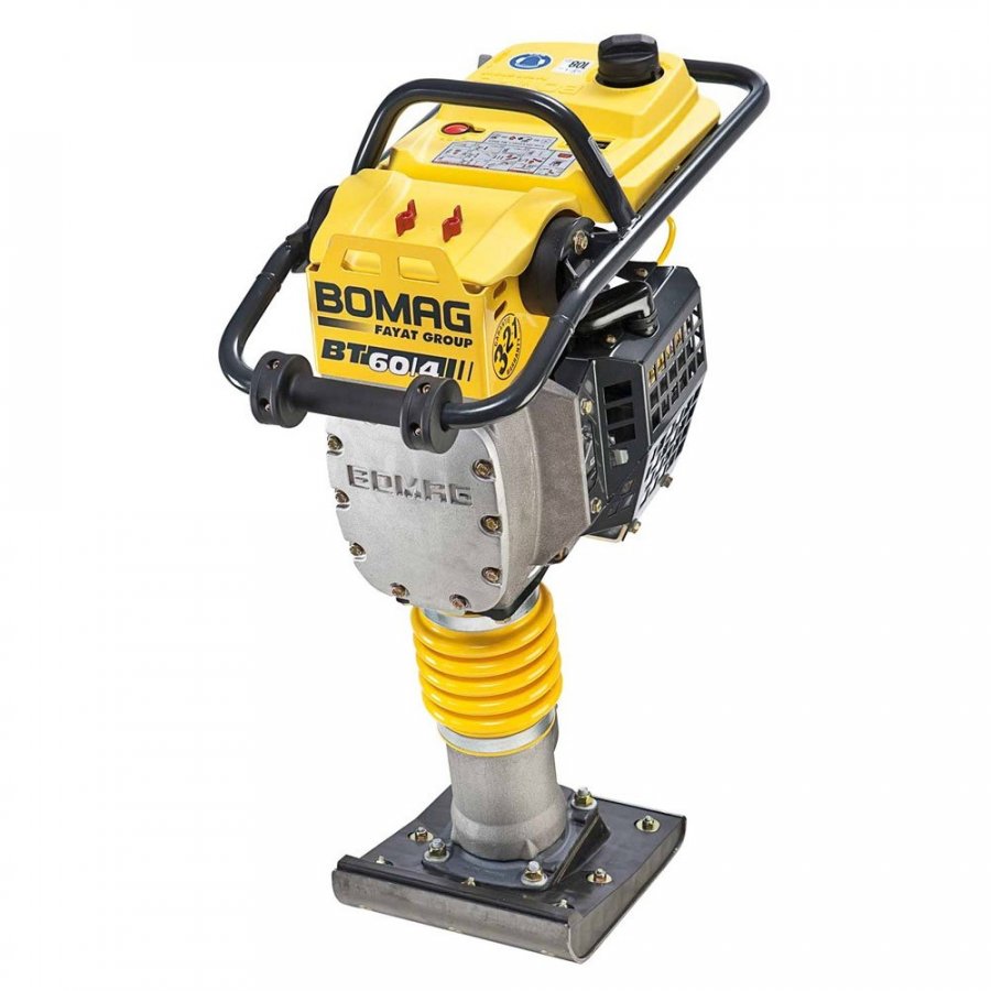

Defiantly a trench foot, I'm not sure of the proper name. We call them a McDermotts Motorcycle at work, named after one of the lads.
Your best off compacting it in 250mm layers really and once the ground has been broken it may never be the same again but you have a good chance with it being clay.
Thanks all, 1990 would you use a whacker plate or will good old boot suffice?
Googled trench foot. Definitely don't want that!!!
This is the one:
There are manual ones too, basically a metal shaft with square lump on the end.
how deep will that work. My metre deep hole is full now so how much would i need to remove to effectively compact?
To be honest if you try to compact material you need to work in much thinner layers 250mm is far to much. On major sites using really heavy plant the thickness is usually around 150mm so for what you plan to use no more than 100mm. I don't reckon much on your chance of getting it back as it was. If you can find the impervious layer in the pit walls then you should try and follow that with impervious materials like clay then backfill on that the rest. Then keep your fingers crossed!
I'd go 250mm but that's just my opinion.
Thats OK but if the OP is looking to get as near to the original impervious layer as possible then the most likely layer will be any clay. Unfortunately it is also a most difficult material to compact and you certainly won't even give yourself a chance if you try to do it in a thick layer. Backfilling in places where there is either no traffic or other need for a high level of compaction will probably be fine with your 250mm. It really comes down to the materials being used and end purpose when considering layer thickness.
