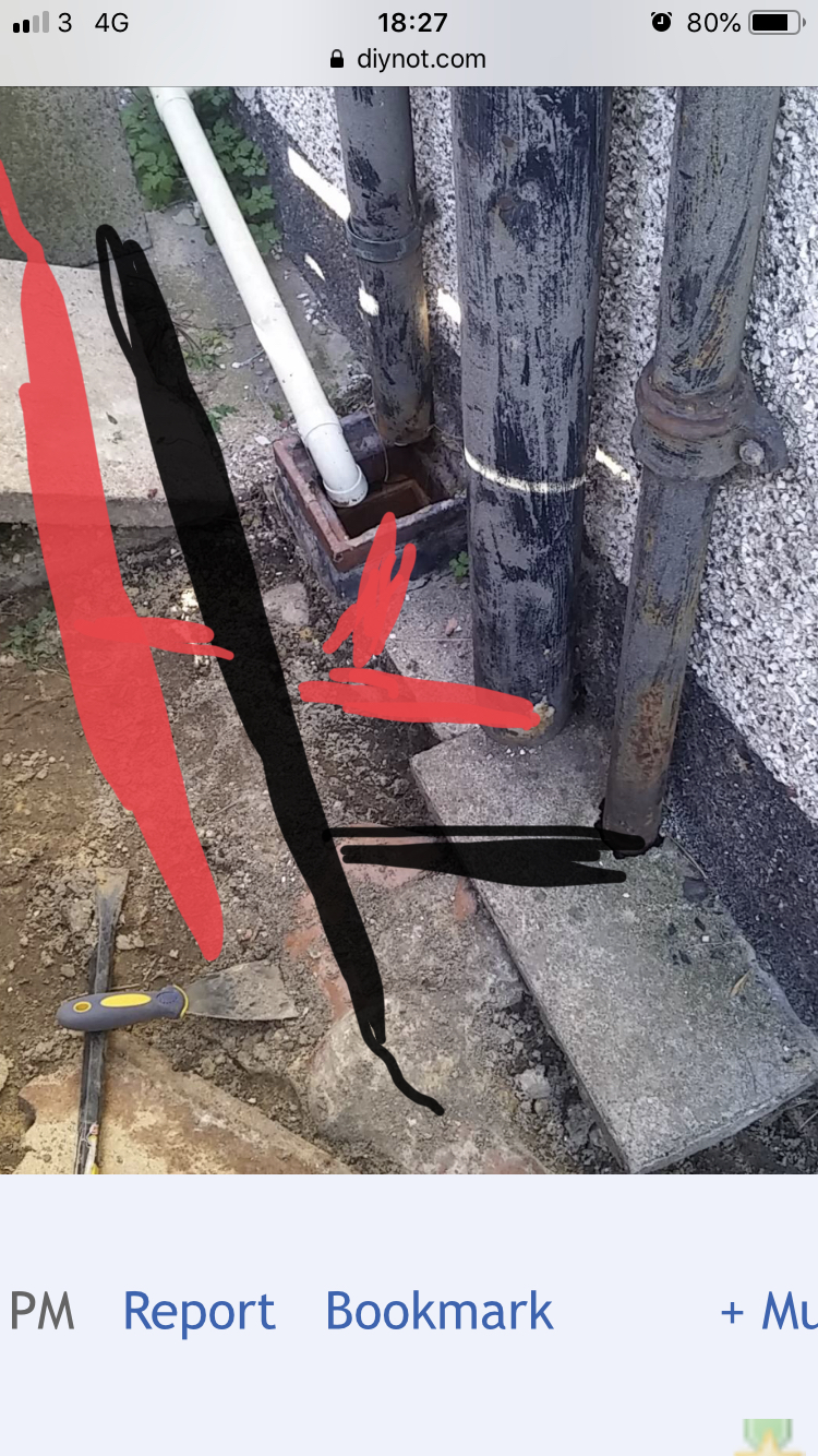

The toilet has been removed as it has been backing up and leaking out of the sides of the pan connector
I have plunged the hole, put hot/soapy/bleachy water in there.. and I have used a wet vac to suck out the junk
The plunger/vac has pulled some junk, but the drain is still slow/blocked
The other drains (bath, vanity unit sink and kitchen are all fine
I have used some rods which i have stuck in the drain but the blockage appears to be at a bend 45 or 90 degrees) I am unable to get to...
I am planning to get the blower in the the toilet waste pipe. By do so but do i run the risk of just making things worse?
Are there any other options?

It looks like you have seperate rain water and foul, something like this:
If you can’t unblock the toilet drain you will likely have to replace the bend at the bottom of your stack.

@Nige F yes, the toilet pipe goes down through the floor (and by feeling) it appears to quickly bend.
I have added some marking for clarity
(1) Toilet waste pipe
(2) Is the approx location of the toilet
(3) Bath /vanity waste
(4) kitchen sink/washing machine/dishwasher
(5) water from gutter
(6) soil stack cast iron vent

find an open the nearest man hole an observe whats dischargin into it , eg the WC,bathroom wastes, an that open kit waste/gulley.
is the black plastic pipe goin into the gulley a seperete bathroom waste pipe?
that gulley needs a grid/gratin cover.clean out the gulley trap - use a glove.
you might be able to rod back from the m/h.
lightly covered drainage pipes can be seen in your photo be careful you dont crack anythin. esp if you try an lever the fixed slabs up.
you could lightly remove soil to see what connects to what underground.

Interestingly, all the pipes are cast iron. This pipe collects the rain water from the gutter

so the first pipe on the right is a RWP but im talkin about the black pipe goin into the open gulley next to the white pvc pipe - whats that pipe drainin?
no matter how this problem is resolved you need to lift all the soil an slabs away to see clearly whats goin on in case of future problems.
two different drainage materials suggest previous work at that position.
lever the slabs up from the very right hand side an lightly tap your flat bar behind it to ease it away from the wall - looks likeits been stuck with silicon.
if you clear the site then post a photo of whats exposed.

Long term it needs a mini inspection chamber on the junction with 1 & 3 on it.
I can’t help but think that theres going to be a bodge connecting pipe 5 into the clay under that slab.

My 10m rod with plunger attachment managed to clear the blockage via the manhole..
I ran some hot water from the kitchen and bathroom and just plunged for a good 15 mins.. Thanks for the help guys!
