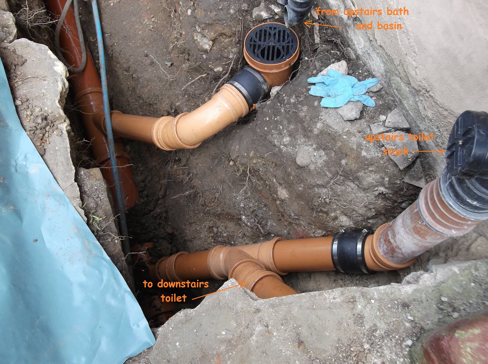

@dannynolan Do you know exactly how/where the upstairs loo soil stack and downstairs loo soil pipe tee into each other? I assume your photo is a sewer inspection chamber downstream and if both empty out of that one pipe, you'd hope that the builders put a small access chamber upstream where the tee is. That is certainly the case at our house both front and back.

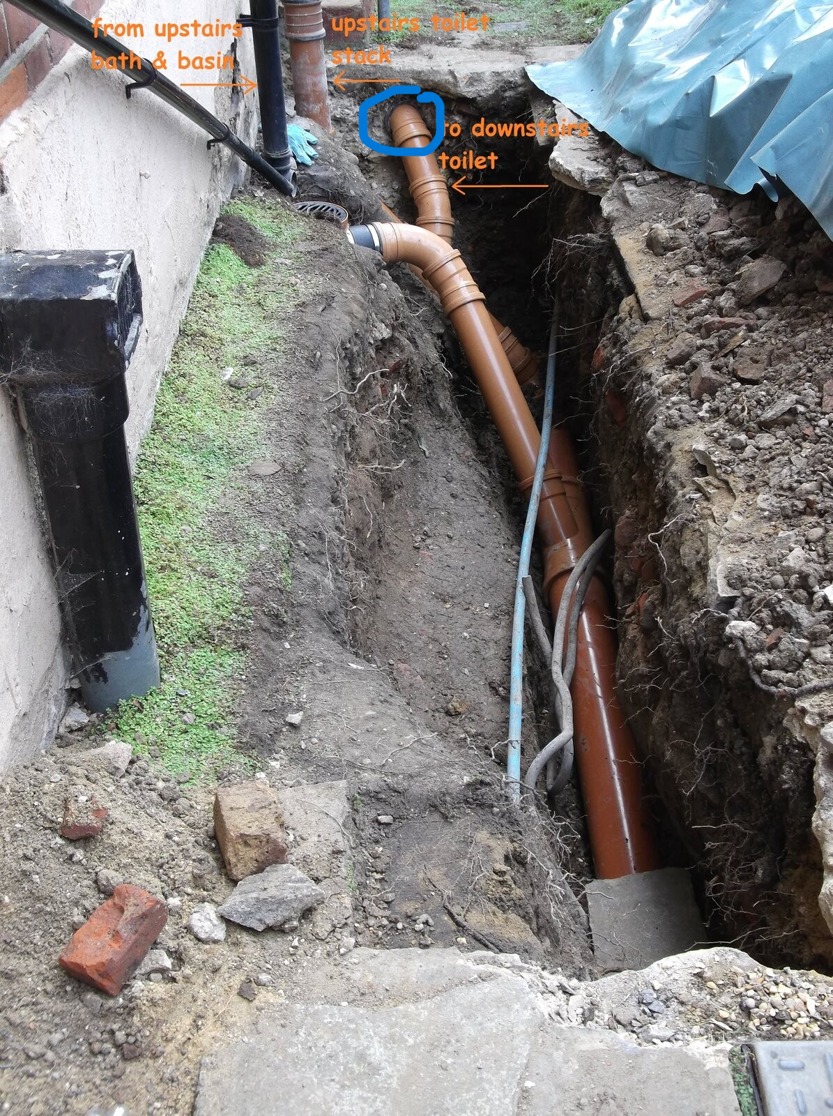

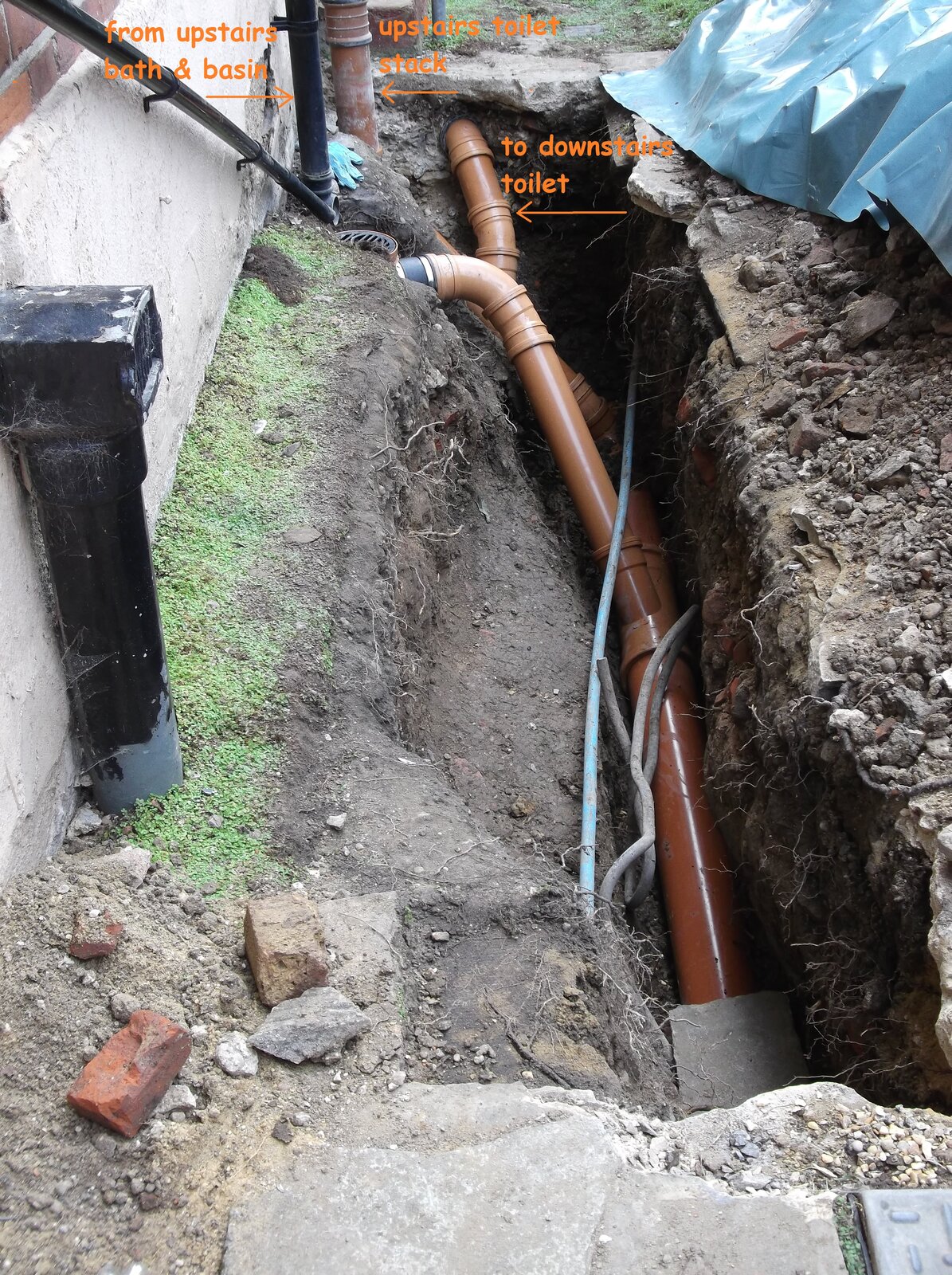

I've added two pictures showing the pipe layout, this work was done twelve years ago because of tree root ingression through a break in the pipe due to an old bodge job. Due to space restrictions they couldn't install an inspection point between the downstairs toilet and where it connects to the stack. If as we suspect, the blockage is in the waste pipe between the downstairs toilet and where the pipe joins the stack what would be your suggestion.

From the photos, if you rod from the inspection chamber end, it looks like the rod (and/or camera) will tend to go up the soil stack towards the upstairs loo due the type of junction pipe used. To get it to go up the branch to the downstairs loo, you'd need an attachment for the end of the rods that is like a slightly curved flexi tube - and even if such a thing exists (I haven't found anything like that - the pros might know) it's still a bit hit and miss whether you could encourage it to go up the right branch.
So you may have to remove the pan and rod from the toilet end as @Stuckinarut suggests - but given you don't yet know what the blockage is, you'd need to weigh up the risk of inadvertently moving it downstream and potentially blocking both loos.
Is the inspection chamber the thing that is visible in the bottom right hand corner of the Toilet 1 photo? - if so, at least it isn't too far to rod right through if necessary.
Ref. what I said previously about pipe volume, I think the blockage is probably a bit further than your toilet snake will go - but with the pan removed, you'll get a bit further with that so worth another go.

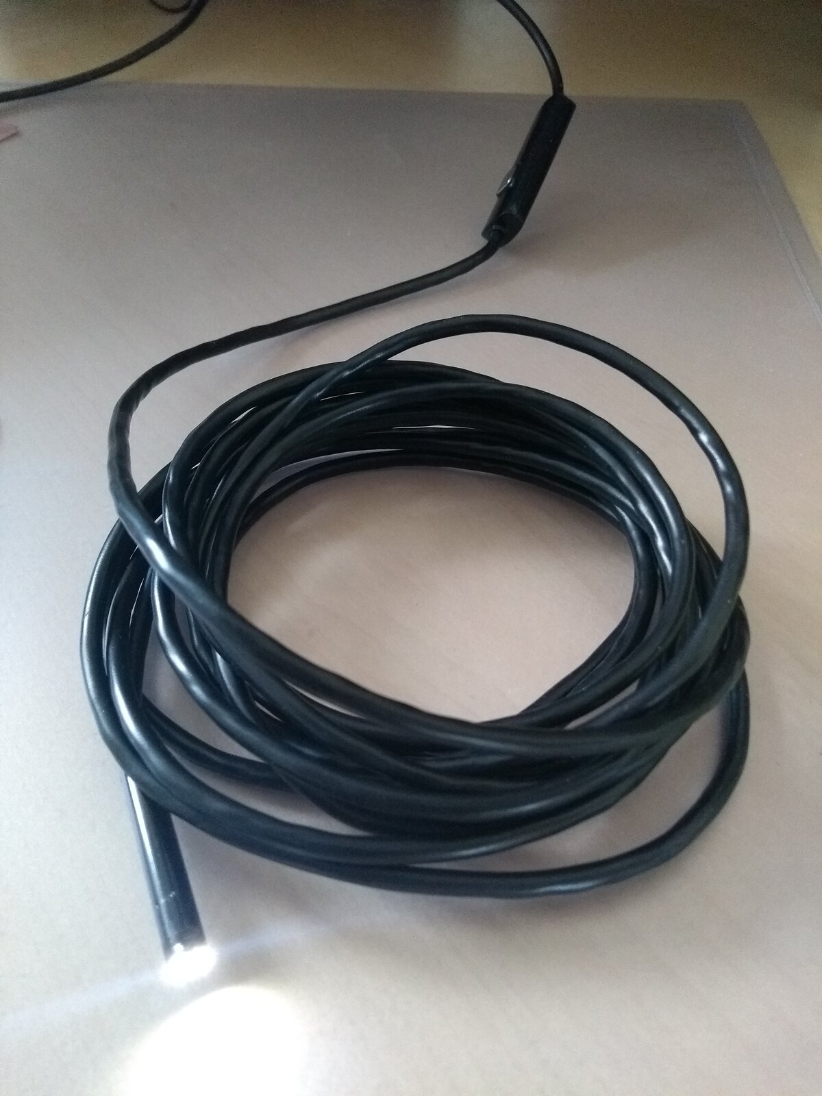

The Rothy is an expensive bit of kit so won't be cheap to hire, and it's not as if you have a long pipe run in this case - so if it was me, I'd be tempted to see if there is a cheap unblocking device you can buy that will get you all the way to the inspection chamber. It can't be much more than 6-7M by the look? If it won't clear, a USB boroscope (tiny camera on a cable) can be had for under a tenner off ebay or Amazon and you could tape it to the device and see if you can get a look at what it might be.

Given it seems only the Downstairs affected, I'd say the issue could well be on the joint marked, where new and old connect. Any idea how that joint was made?
For what its worth, I'd think it very unlikely to be root ingress, at least in the new pipework section anyway.
...agree and that joint looks like its a bend judging by its position.
Don't know how the joint was made. The pipework it goes into was replaced about fifteen or so years ago. Thanks for your opinion on the roots, we feel the same, despite Dynorob! being 90% certain that was the issue.

As an aside, this is what I meant by the USB boroscope as I'm just about to use it to look inside a dry lined wall. It's about 6mm diameter with a circle of tiny LEDs, and mine has a 5M long cable. The black box has a button to take a snapshot and there is also a little thumb wheel to control the brightness. I originally bought mine to drop down a riser when tracing where a pipe went, but it has come in very useful on many other occasions since. Only snag is the LEDs aren't as bright as my photo suggests.
