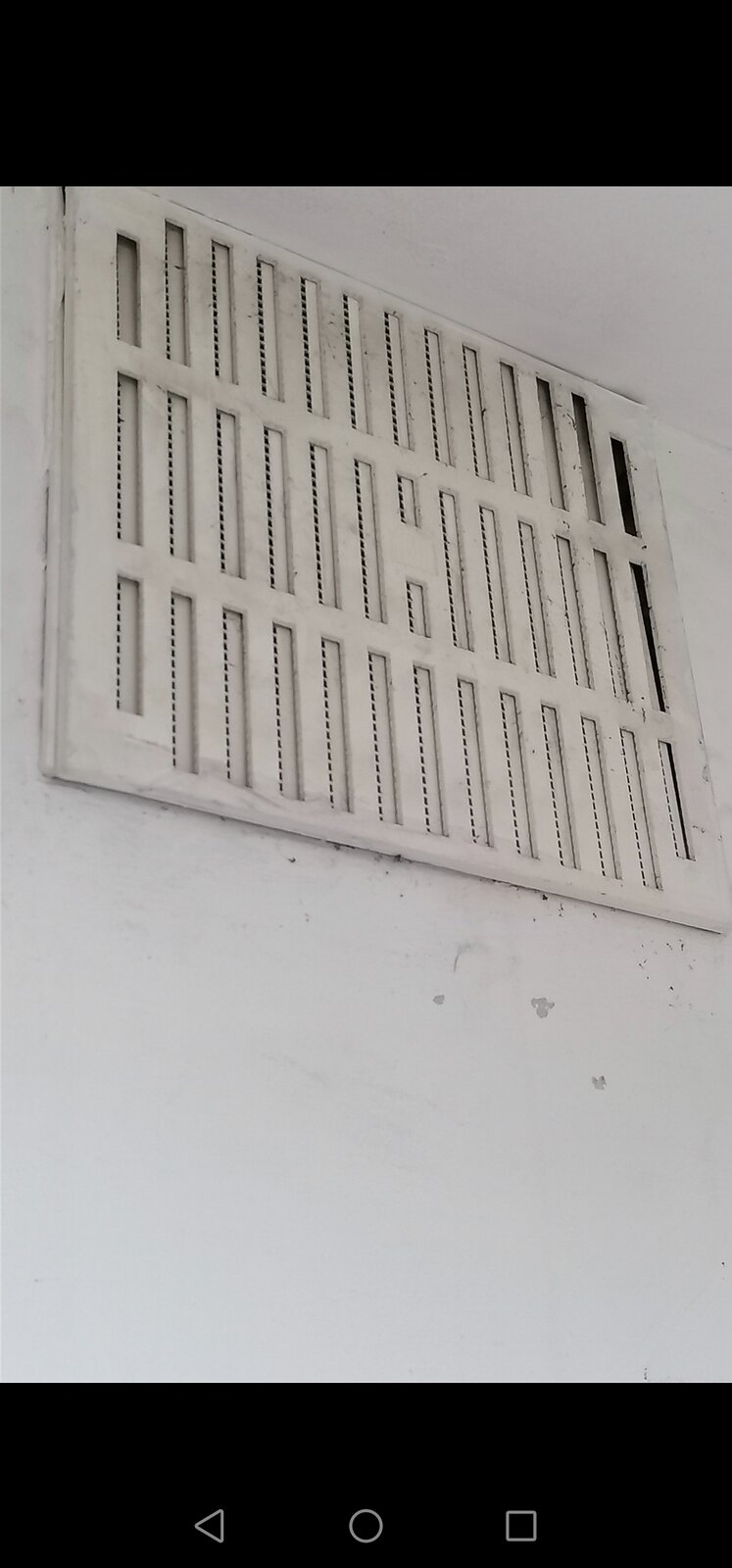

Hi can anyone advise me how to block this air vent for the winter. I won't have any fires lit in the house so I won't need to worry about carbonmonoxide
If you're happy its not needed, just cover it temporarily with a sheet of card....whereabouts in the house is it?
John :)
If you are a tenant don't cover it.
Especially if this is a newer property, built post '90.
Any condensation and mould repair will be billed to you.
I will be leaving pvc windows slightly open in rooms not used. This room is used and struggled to heat up last year with a pipeing hot radiator. Was like a gale coming through air vent constantly

the one you show is closed by pushing the outer panel half an inch sideways so it slides across and blocks the slots. This is the design.
perhaps one or both parts is bent and distorted. Take them off for a wash, and see if they work correctly off the wall.
if the wall is not flat it will not seal correctly, but you can put plastic draught excluder round the perimeter of the wall part, so it seals against the wall. Do not tighten the screws so much that they distort the plastic.
A new hit-and-miss vent is very inexpensive.
You can remove the cover and stuff the hole with insulation or anything else you have handy.
But as I said, if you're renting don't do it, it might end up costing you a fortune.
that vent is in two parts. slide the outer section off and cover whats left with white duct tape.
