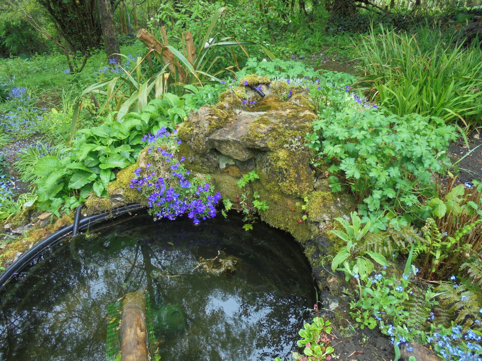

I had an old cattle feeder that would have done the job. Really thick, tough plastic but I made it into a pond. Probably the best pond liner around.
Yes there are preformed plastic standalone pond liners, it's a no brainer if you can find one the right size. All this talk of block wall lining is barmy.
