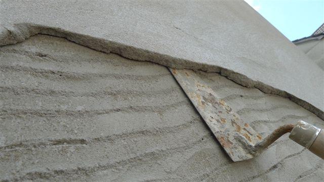

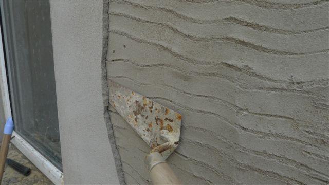

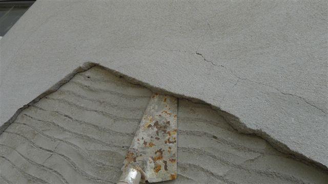

Hi all,
Well, it's been a while since I last posted anything about this job.
The images below are of a part of this stuff that has been applied to the walls as I've mentioned earleir in this thread, and shows just how shocking it is. This is a patch I have removed, in order to see how loose it was and get a few pics here for comment. As you may be able to see, it's coming off with ease and is like this in very large areas with some pretty horrific cracking going on. It's a massive disappointment to my daughter who has already spent well over £1K in having this done. She has refused to pay anything else to this guy and has asked him to come out to discuss it. He initially promised to get onto it and sort the issue, but for the last month or more has avoided her, and her fiance's calls. It seems clear now that he's looking to cut his losses and step off the job altogether.
What are the views of you all looking at this one.???
To me, this is woefully short of being an adequate standard of work. The render is soft and weak, can be rubbed off with finger pressure and is very easily crushed in your hands. It's a P**s poor job in my view, but I'd love to hear the opinions of anyone else that can be bothered to read all of my whingeing here.
Thoughts anyone.?
Grand Wizard is right - the top coat hasn't bonded to the scratch coat. Render is notorious for sucking the water out of the following coats so what happens is the top coat dries out instead of setting via chemical reaction. All you are left with is damp sand/cement that will never harden. It'll have to be re-done.
As joe and the wizard say, looks like top coat will have to come off, and any loose cleaned off well. Possibly a SBR slurry before finish coat
It may also have been overmixed or put on in very warm weather, but the scenario above seems likely.

I'm hoping your scratch coat is okay . If you can't scrape it away easily, and it is not 'live' or hollow, then that's good. As it will be less time and material to fix.
You'll be able to hack off the rubbish top coat yourself , and clean it up for the plasterer.
