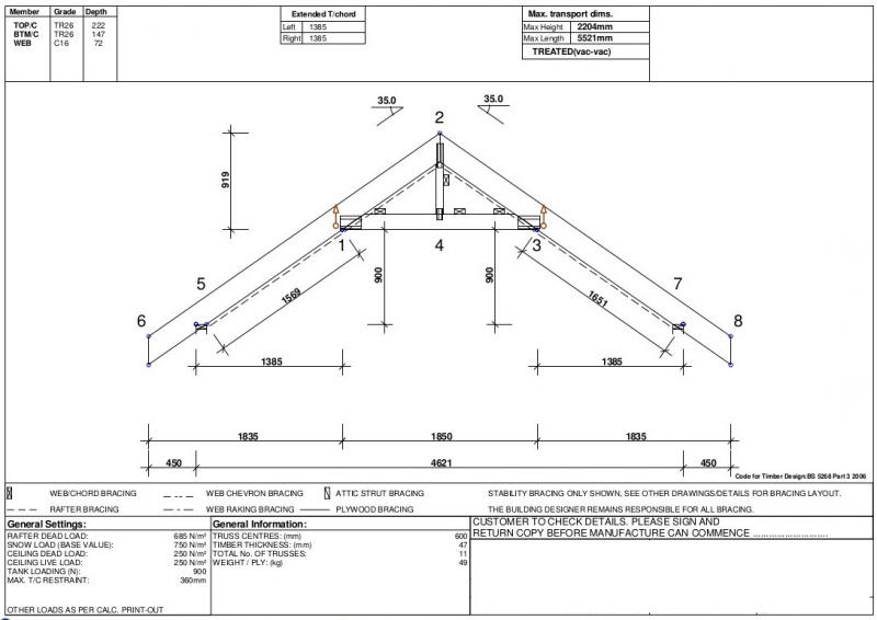

Morning all.
My question is:
Do I need the lateral and diagonal/chervon bracing on a roof that is fully boarded with OSB?
The new bits being built are a free-standing garage with attic trusses and a sun lounge with raised ties.
Just coming to the bit where we have the trusses up and we are going to FULLY board the roof with OSB3, before battens/counter battens/tiling, etc.
The trusses are engineered, ridge roof with gables, strapped to everything in sight, but I don't want to use the bracing where I don't have to. It means a lot of battening out and a lot more work fixing the insulation inside, plasterboard, etc.
I'm having a little difficulty getting BC and the truss manufacturer to give a definitive answer as to whether - or not - I still need to lateral/diagonal/chevron brace the roof structures. Each one says ask the other - and I seem to have given the BC dept a headache. The last quote from them was 'you are a trouble to me' - because I'm not quite doing things the traditional way. The last thing I want to do is get the boards on and then start having to poke/manoeuvre braces into the trusses. :(
BC has been quite good but if I can find an official reference, they will probably be happy. :D :D
Anyone got any ideas/references/pointers, please?

There are plenty of places to fix laterals adjacent to the node points and indeed the bracing diagram shows them.
As I said in the original post, all I'm trying to do is remove/minimise the need for lots of battening out behind the ceiling covering.
If I can't - I can't................

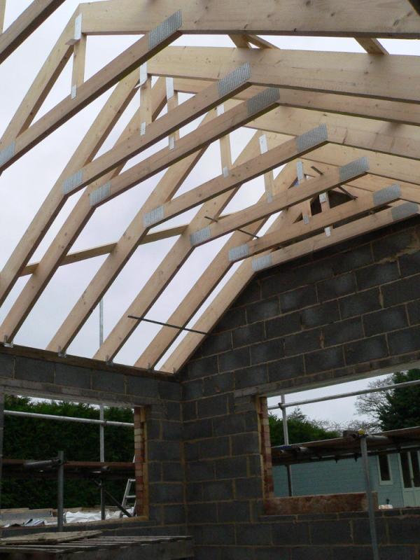

Pictures coming up.
[/i]
I think that a pic of a truss would help - plus a view of the actual roof. OP, Are you talking about intersecting roofs?

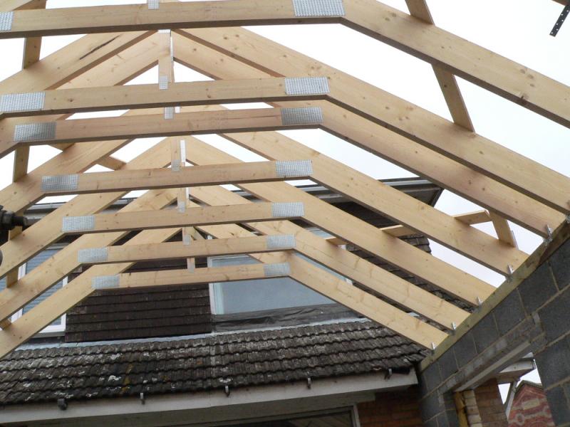

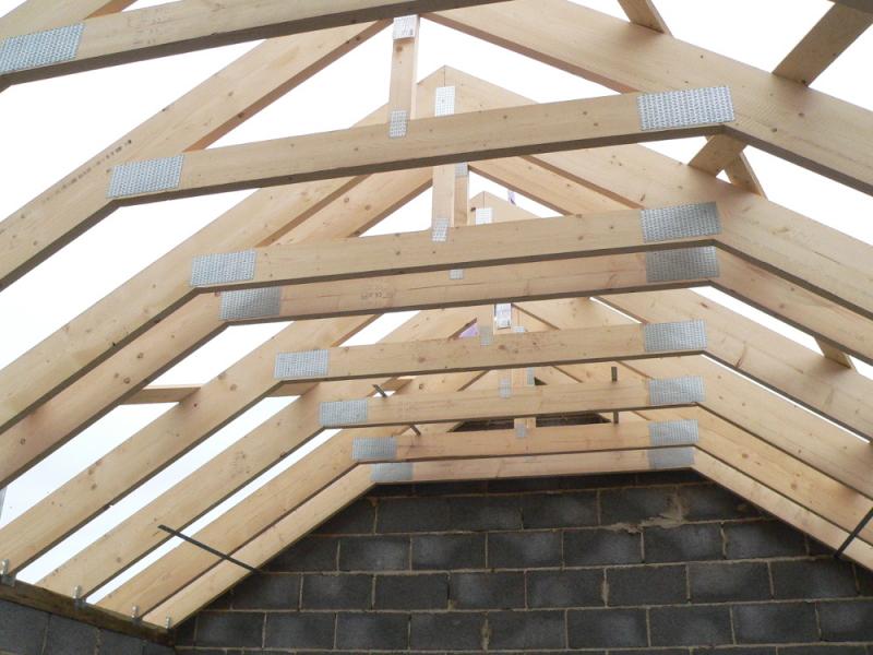

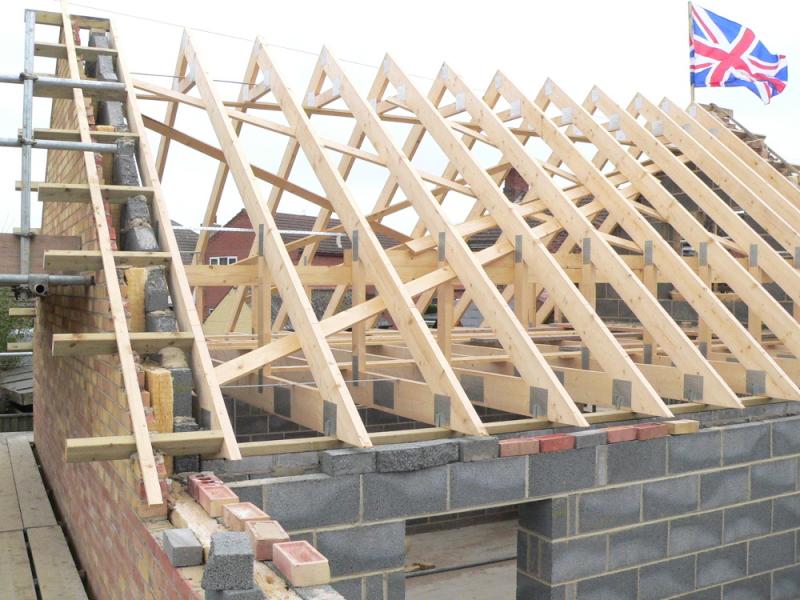

Here goes:
//www.diynot.com/network/PatsPatter/albums/
If I got it right, that should show them.
If not - I'll try again :rolleyes:
Alternatively: :D
Garage
Sun room
Note: The Sun room roof will intersect the dormer/roof. We have the trusses for that as well.

I'll drop out at this point. Its different from what i understood its to be, and there are now two roofs involved neither of which is being braced as i would do it.
Get a carpenter who frames roofs involved and it will be resolved immediately the joiner is on site.

Incidentally, when you say 'neither of which is being braced as I would do it', I assume you are talking about the manufacturer's diagrams - not the way they appear at the moment?

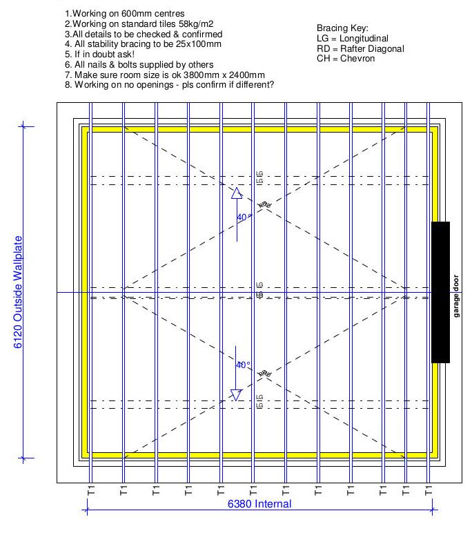

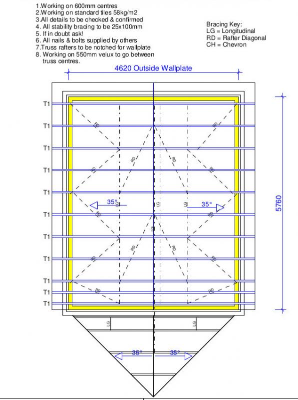

The diagonal bracing is wrong and needs to go down to the wall plate. This applies to the raised tie roof also. You will need to overcome the diagonal brace where it passes along the vaulted bit by means of a ply thickening gusset.
The bracing schedule is clear and specific and must be adhered to. BC can not authorise a change to this bracing detail.
You will also need to fix solid bridging where the bent straps pass across the rafters/joists.
Thanks, noseall. A fair bit to digest :)
If you're referring to the bracing as shown in the photos, it's only there to locate things whilst we put the trusses up.
Apologies but not quite sure on that one. Could you elucidate a little, please.
OK, that I can appreciate but.........

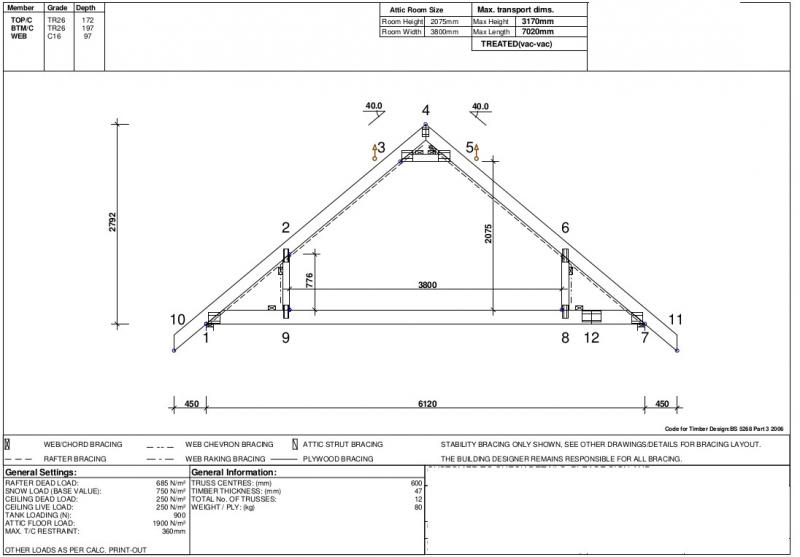

Assuming you mean what the builder called 'gable straps' I had worked that one out from reading various other bits and pieces - including that particular truss manufacturer's manual, published on line - but not supplied! There is nothing to stop the gable straps from folding in compression without them in place.
The manufacturer's manual also states that the garage trusses will also need (solid bridging?/dwangs/noggins/whatever terminology suits) between the floor joists as well, even quotes specific sizes. They aren't shown on the drawings, either. It looks as if they are relying on BC to ensure that happens, as well.
As far as I can tell, the information I've got from the truss manufacturer seems a lot less than complete. You've already pointed at a couple of gaps in it. My questions to them have not produced any useful answers. I want somewhere to look/refer to and a bit of good advice and I very much appreciate all that I'm getting on here.
Perhaps you see my quandry? I don't want a disaster and I know I'm perhaps trying to produce a bit of a hybrid but why not? Nothing improves, or progresses, unless it is questioned by someone with an idea. ;)
Raised tie trusses are particularly susceptible to lateral movement in the direction of the ridge.
This is because the rafter between the tie and the wall plate is acting as a slender beam, which can easily buckle sideways.
However, if the trusses are finished with OSB on the top (as they do in Scotland) then this would be sufficient to give you the horizontal rigidity. Use noggins the same depth as the rafters at unsupported board edges. Also, ensure that the gable walls are firmly strapped back to the roof, straps engaging at least three trusses.
It is surprising that your truss-supplier has not given you more advice on this point.
PS see if you can get a copy of C.N.Mindham 'Roof Construction and Loft conversions' - very good chapters on trusses.
