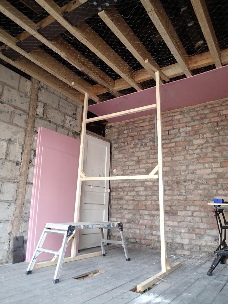

Bit of DIY, tired to board the ceiling on my own.
Yep bit of a pain, got a few on ok, but one was a pain and have a smallish gap.
My question is how large a gap can I have?
Apart from not giving up the day job,should i
1) Take is board off and cut a better fitting one.
2) Use a slither of plasterboard you cut off to fill the gap
3) fill with a some sort of filler and tap over it
4) it's not too large tape it and should be fine.
take them all off and start again only this time turn your plasterboards the other way so they are laying across the joints
steve is being cruel but well correct.

yeah, cheers, I did think that about the direction, but only after I had done it.
if running across the joists, the board should end half way across a joist, for you to screw it to?
As the lads say you have made a bit of pigs ear there !
Take them off and start again and make sure all joints fall on timber
Put noggings in as well and space the screws a bit tighter
You can buy yourself a plasterboard stand from likes of screw fix or knock up a dead man out of couple pieces of timber to prop the boards up whilst you are screwing them in place
This is the best time to get a mate in to help you a favour being called in would be ideal time right now
Good luck :D

Cheers for the reply.
In reply as I'm no 100 % sure on all of it
Going to take them down and start again
I had some bodgit and scarper merchants in, so now doing things DIY. Yep aiming for the regs. Downstairs steels all fine and passed, though that was just taking out a brick wall. These for the attic conversion have been more difficult to fit.
1) yes was going to put in rockwool from above
2) By dead man, do you mean upside down T's? I made 1, but 2 does sound more like the right thing
3) What is needed for the steel? Why does it need painting? I thought the red was rust proofing that wasn't needed for steel in a building. Also lining?
I led to believe that all was need was fire resistant boards between the bedroom and the attic room. Giving 30mins + escape time
4) Halfboard joints? What are those?

as for fire boards they don't give you any burn time at all its the system you use on or around the steel half bond on the boards is like brick work cut half a board or as close as to the joist then run off that then start from the other side on the next row.
If you ask our building regs or steel guys they will tel you what system you can use.

half bond is you start with a half board from the wall cut too the closest joist
then next full board and so on then next row you start with full board to the closest joist..

Dextraneous thanks for the props, bit and small platform.
Boards have been removed, netting up, spoke to building regs lady and cracking on again, hopefully with less mistakes
Plus i've built a myself a friend, who is helping me lots with the boarding :)
