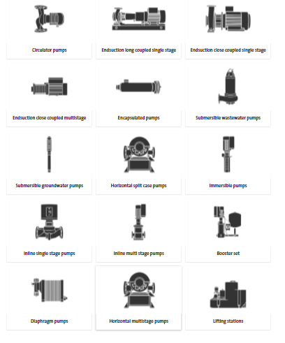

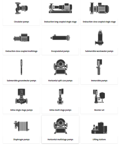

It is not a pump, it is a circulator, it does not PUMP anything at any time
Best tell Grundfos and other pump manufactures their brochures are all designated with the wrong descriptions
And just to help you understand what a pump is here is a dictionary definition for your clarification
"a mechanical device using suction or pressure to raise or move liquids, compress gases, or force air into inflatable objects such as tyres"
But they are pumps, Grundfoss make pumps and circulators
