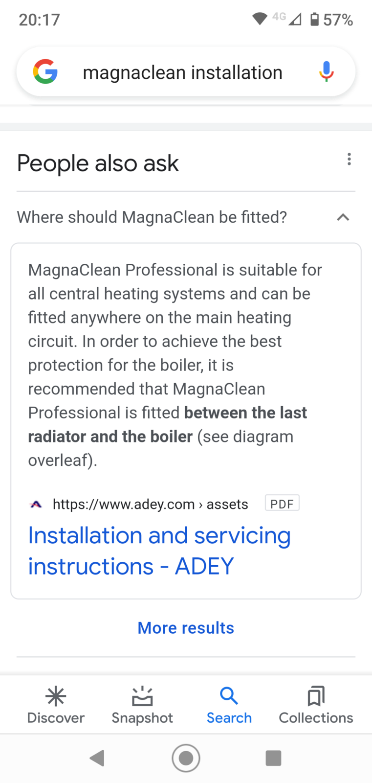

And you really want an Adey Magnaclean or similar setup to help keep the system clear
