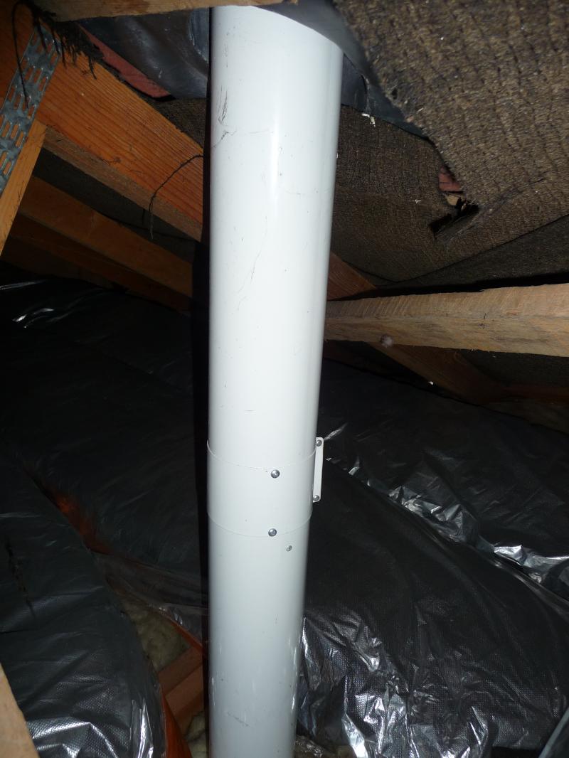

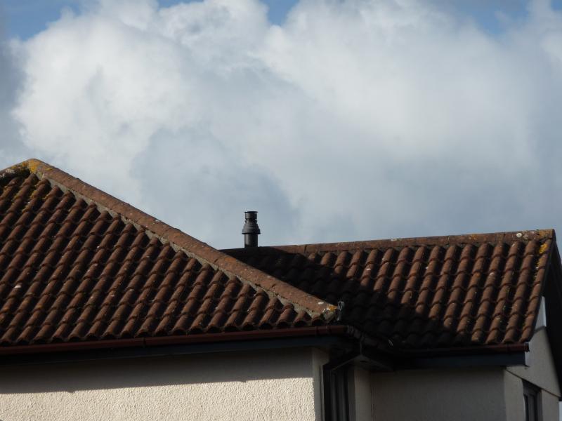

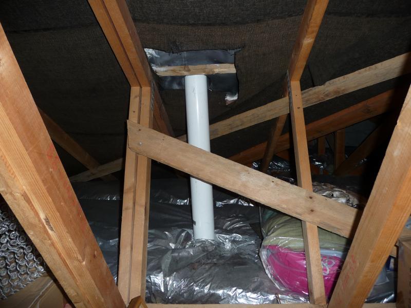

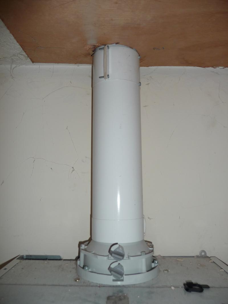

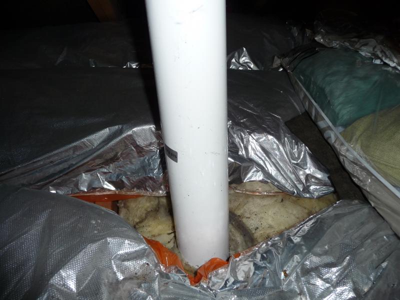

I've taken some pics of my boiler flue. I assume that the gas regs have changed since my boiler was checked last year. What needs to be done regarding 'clipping'?
Cheers
Looking at the pics, I would suggest that one flue clip would suffice. Fitted near the joint and attached to the adjacent roof timber.
So the 'clips' are purely to prevent any movement of the flue, rather than anything specific regarding the flue joints?
Are these clips available to the DIYer? Agile mentioned previously that any work regarding the flue should be done buy a gas registered person. But as I am not looking to disturb the integrity of the installation in any way, I would like to research my options.
Any links or pics available of what these clips look like?
