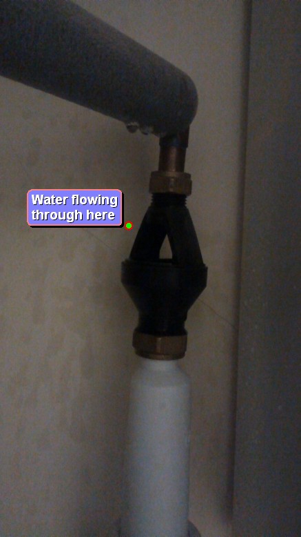

I was sitting in the home office when I heard the central heating system gurgling and a wishy-washy sound... I thought "that's not normal" and went to the boiler cupboard (where there is a Glow-worm Flexicom 30sx, a big tank and a smaller tank) to observe water rushing visibly through this piece (some of it splashing around)...

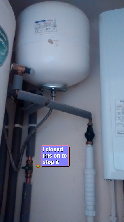

So I panicked a bit and ended up turning off this valve that appears to go to the tank above...
The rushing water then stopped... well, it hasn't stopped, but it's a gurgling dribble instead.
Obviously something's not right - and I'll need the experts calling-in - but it would be good to get any views from the Internet experts!
Safety devices have operated on the unvented cylinder.
A suitably qualified G3 engineer needs to be called to diagnose the fault and rectify.

It's not clear to me how I can just turn this system "off" until I can get someone around. Have I done the right thing by turning that big green valve?

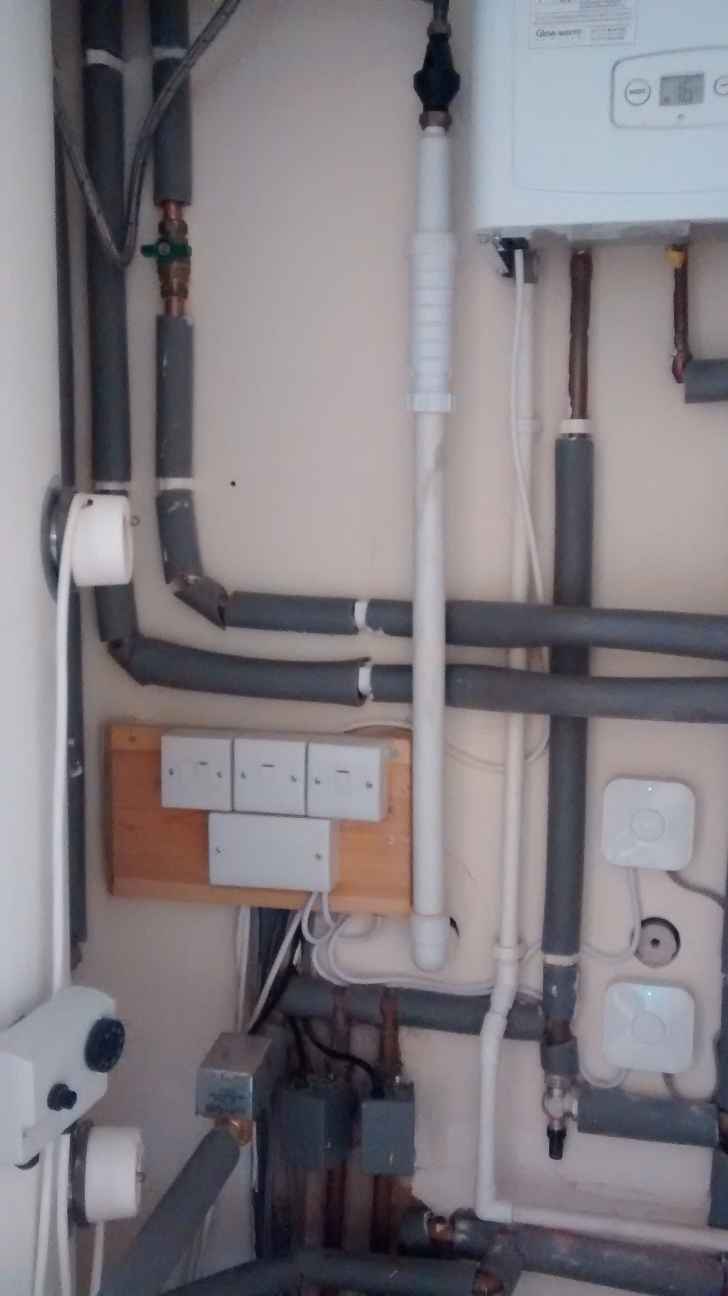

Turn off the three electrical switches shown in your photo, and any other similar ones.

I've been in touch with a firm I've used for doing GSCs and services in the past. Provided a link to this thread so the pictures can speak for themselves.

Also very curious why I have an 'open' pipe... it was intriguing to see water flowing (dropping) across an open space like it was. Is that normal?
Having an open pipe is normal. In fact it is essential. Water flowing through it is not normal and indicates a fault in the system.
1/ the pressure in the sealed tank is too high and the safety pressure relief valve is opening to relieve the pressure ( to prevent the risk of the tank bursting )
2/ the safet valve is opening at a lower pressure than it should.
3/ the over temperature valve is opening because the water in the tank is too hot.
The open space is to allow you to see that the safety valve has opened. It also provides an escape route for water from the safey valve if for some reason the drain pipe is blocked.
What ever the fault you need a competent G3 registered technician to service the system to ensure it is safe and that your insurance is not invalidated.

I have "reset" the system about 10 minutes ago and my radiators appear to be getting warm - the readout on the boiler started at 20 degrees and is now at 55 and rising. It seems to be operating as it has done for the last couple of years.
I've asked for it to be looked at and serviced... I don't have a day or time yet. I will keep my eye on things and turn it all off again if anything seems untoward.
Well, I know my answer to the reset.
I turned it all back to how it was and within 20 minutes water started to flow through the black plastic bit again. :cry: Better leave it all off.
