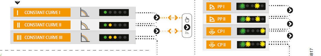

Can't see if the pump is on Speed1 or Speed3, IF speed3 far too high IMO at 6.4M, even speed1 at 4.2M may be a little on the high side, suggest PP2 (3.8M to 1.7M) or CP1 at a constant 3.0M. Also just ensure the pump arrow is pointing upwards.
thanks John.
Yep the pump arrow is pointing upwards. Been in place for about two years and not been a problem.
I have never been sure what the correct speed should be, so thanks for your advice. I will ensure it is as you suggest.
