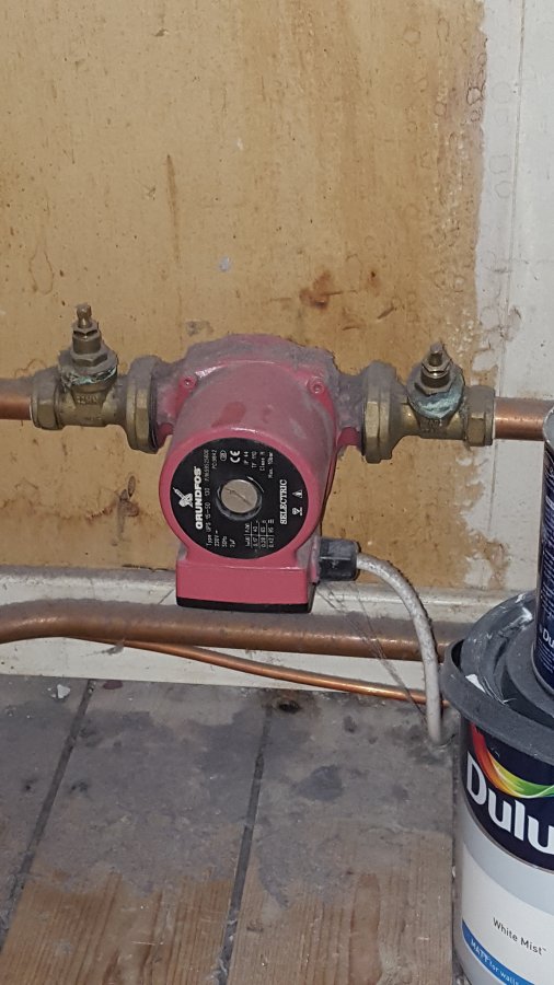

What pump make/model? What speed setting is it on?

Agile, see photo for pump, hopefully you can see the relevant info, it's just a picture I happen to already have so I can take a better one later if required
