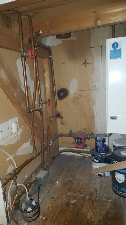

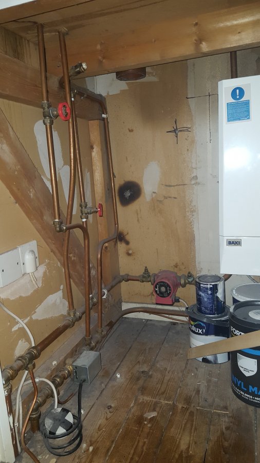

Not sure if there's a bypass, I'll attach a photo of the setup.
Yes the pipes to and from the boiler are very hot when cycling starts
Actually I assume that red isolator on the right hand side is a bypass. If it is it is fully open, is this correct?

The gate valve in the middle is the bypass. That should be closed and opened half a turn until a flow can just be felt by the heat on both sides of the valve.
But that valve setting should have been checked by the boiler installer and the valve head removed! Or has the OP been fiddling?
Tony
Good chance, if no other motorised valve, cylinder acting as a bypass also, so for the time being, I would close the bypass gate valve, restrict the gate valve to cylinder for correct working delta t

Should the isolater on the right hand side of my picture be closed? I am sure it is fully open at the moment, I can try and find out if the plumber who worked on the system recently done this but I have not been able to get hold of him...
I have checked the temperatures of the return pipes, it definitely seems to me like the return from the cylinder is much hotter than the return from the radiator manifolds. This led me to suspect that the cylinder is effectively short circuiting the system and returning the majority of the water to the boiler?

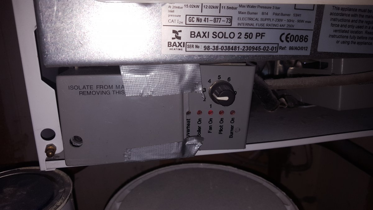

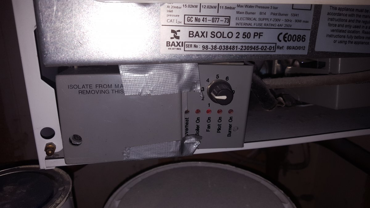

Also I have attached a picture of the boiler controls, it seems the thermostat is set to 3 (of 6) I'm not sure if this is low or not.

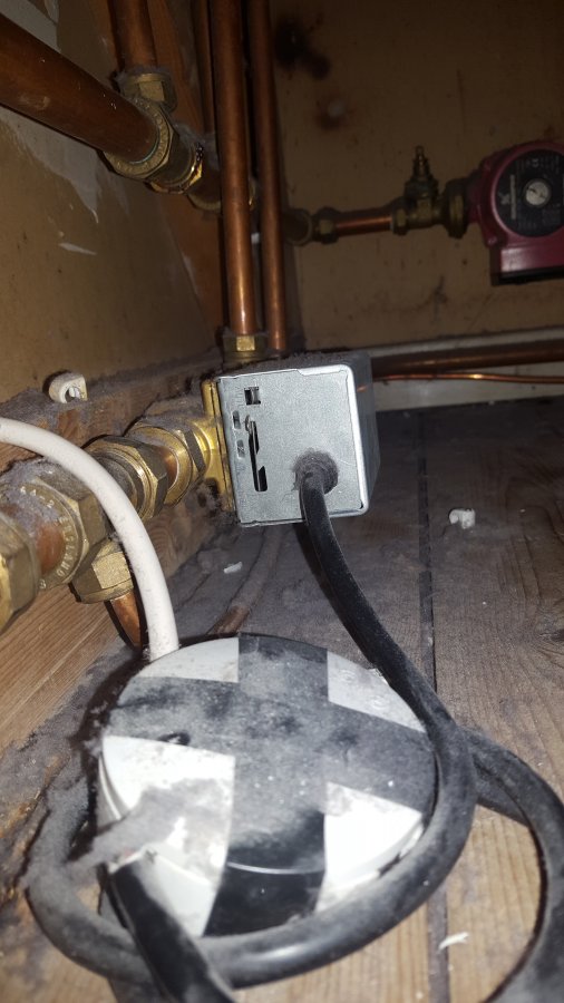

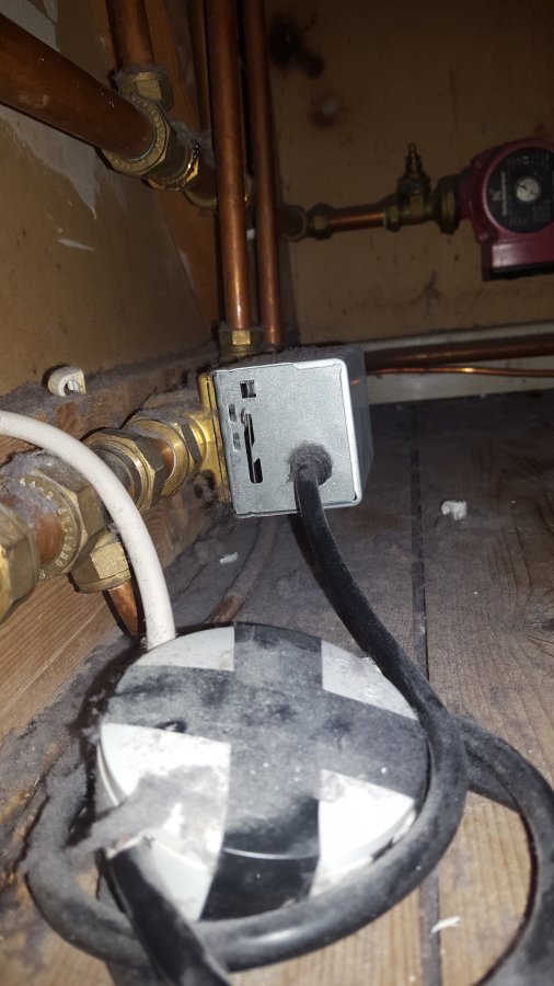

In regards to the motorised switch I will attach a photo but basically my options are: hot water only, or hot water plus central heating. There is no way of running central heating only. Also the cylinder doesn't have a thermostat on it so when boiler is on the cylinder just continually heats.

Those 2 pipes going through the ceiling in the picture, do they feed the cylinder? I wondering if now we start to see your problem, the flow will be taking the easiest path, which by the looks of it, is through the cylinder. Before you do much else, I would get the system altered to 'S' plan if this is safely possible. This means fitting a cylinder thermostat and motorised valve to the cylinder pipework, so when cylinder is up to temperature, full flow can be put into the radiators.
However, (I am assuming you system is open vented), there must be a clear, continuous upward path from the boiler to over the F&E cistern, if this is currently done using the cylinder pipework, a valve cannot be fitted into that section of pipework.
