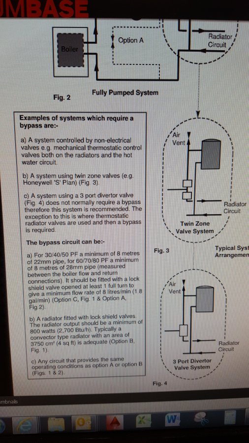

Yeah that's fine I'm definitely going to go for the s plan. For my own understanding though can I clarify a few points
In the current setup surely there is no need for the bypass as there is a path for water at all times through the cylinder?
In real terms is it dodgy to fully close the bypass gate indefinitely? I have most trvs set to 5.
BTW, I don't believe I have an auto bypass at this time although I stand to be corrected, all I have on bypass pipework is the red gate valve

In terms of the noises etc I'm not overly concerned by them I just want a boiler that functions normally. I had been a bitpremature last night when I said that altering the hw gate valve had helped, it must have been the fact that it was full of cold water that had made the difference as this morning it was back to normal with a roasting hot return pipe and the boiler cycling after 15 mins of operation.
I had a look at the installation manual for my boiler, see picture. It seems to confirm what you said, I don't actually need the bypass in the current setup as I have no thermostatic control of the hw so this will effectively act as a bypass. But when I install the S plan system u will need it. It does also mention that the bypass should be 8m of pipework, id say it's lucky if it's half if that!
The idea is that the bypass piping will actually dissipate some heat from the boiler to cool that down if there is no open path.
I specifically give a basic setting for a gate valve bypass so that is available for anyone casually reading this in the future. Of course in your own case it is irrelevant until your system is reconfigured and could be completely closed just in your particular case.
As we have explained, in your case the boiler has to modulate on/off and if it is running for 15 min then that may well be totally correct for your boiler output and heat absorption.

I beg pardon, looking more closely at the picture and I realise what I mistook for an auto bypass is actually a bleed point.
