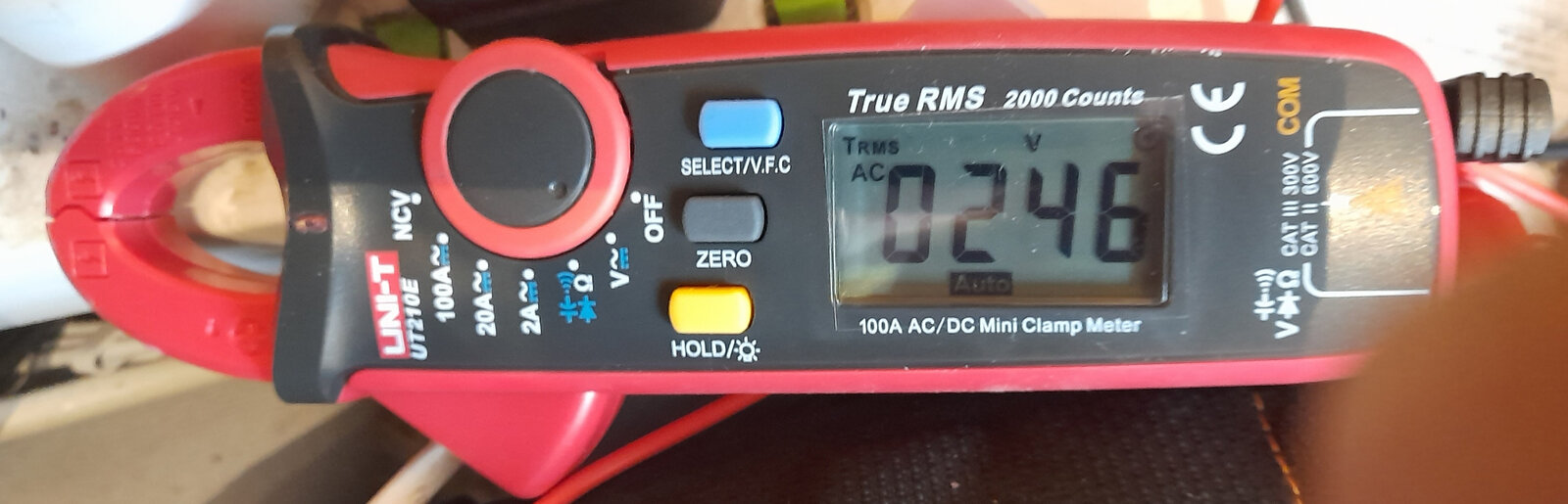

is likely wrong, likely no test gear will be required, likely the guys eyes will be enough, but the right test gear can destroy the boiler if used without the skill to know how, in the main we use an insulation tester VC60B.jpgor clamp on ammeter Testing voltage.jpg to find out what is tripping the RCD, but also need to test the RCD with a special RCD tester, and even going for cheap as shown above we are looking at around £70 for the pair, and £200 for RCD tester, so you can understand why plumbers don't tend to have them.
