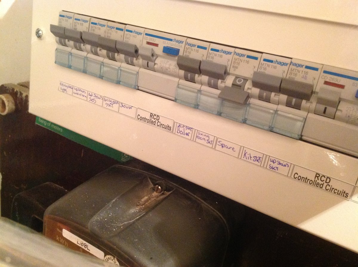

What is written on the device that trips, and does it have a test button?
Or post a picture of it.

The device that trips is the main consumer unit.
It trips flipping the switch down for this circuit which is labelled boiler.
Flipping it back up turns it back on.
All the other trip switches in the consumer unit are unaffected.
I thought Coker on its own switch and all downstairs sockets on there own.
It would be useful to know a little about the device that trips.
We need to know the rating in amps (A).
We also need to know if it is an MCB or an RCBO (an RCBO has a test button).
We also need to be sure if the there is a fault on the cooker or kettle (you haven't necessarily ruled this out yet) which could be causing the tripping.
By you telling us the rating of the MCB or RCBO in A we can tell if this is a simple overloading problem.
KIT SKT Boiler is the one that trips.

16 amp MCB (with seperate RCD).
Almost certainly overloading issue.
Best thing to do is either not use kettle and that oven together, or see if there is a socket on another circuit to plug the kettle in.

It may be possible to upgrade the MCB to 20 or 25 amps, BUT AN ELECTRICIAN WOULD HAVE TO CHECK ALL THE WIRING IS SUITABLE FIRST, SO DON'T TAKE IT UPON YOURSELF TO DO THIS.
The setup is very strange. Unusual to find socket circuits on 16A MCB. Usually you'd expect 20A devices if radial circuits, or 32A if rings.

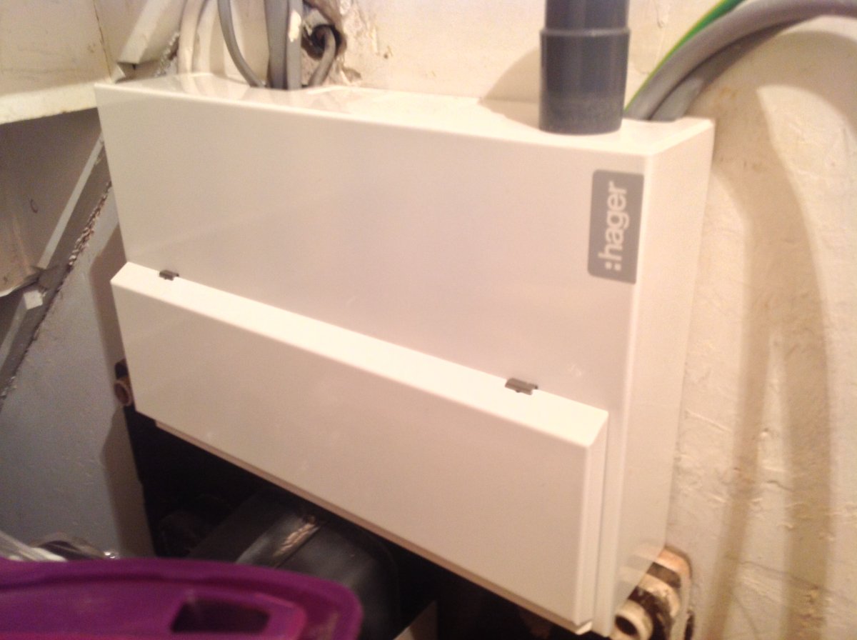

Also, the lack of proper ingress protection at the top of the consumer unit tells me it's not been installed by a professional. I'm also surprised to see a single device for lights rather than separate circuits up & down: probably a bodge to get around a borrowed neutral on the landing. Also a mix of ages of MCB (clear by the Hager logo).
