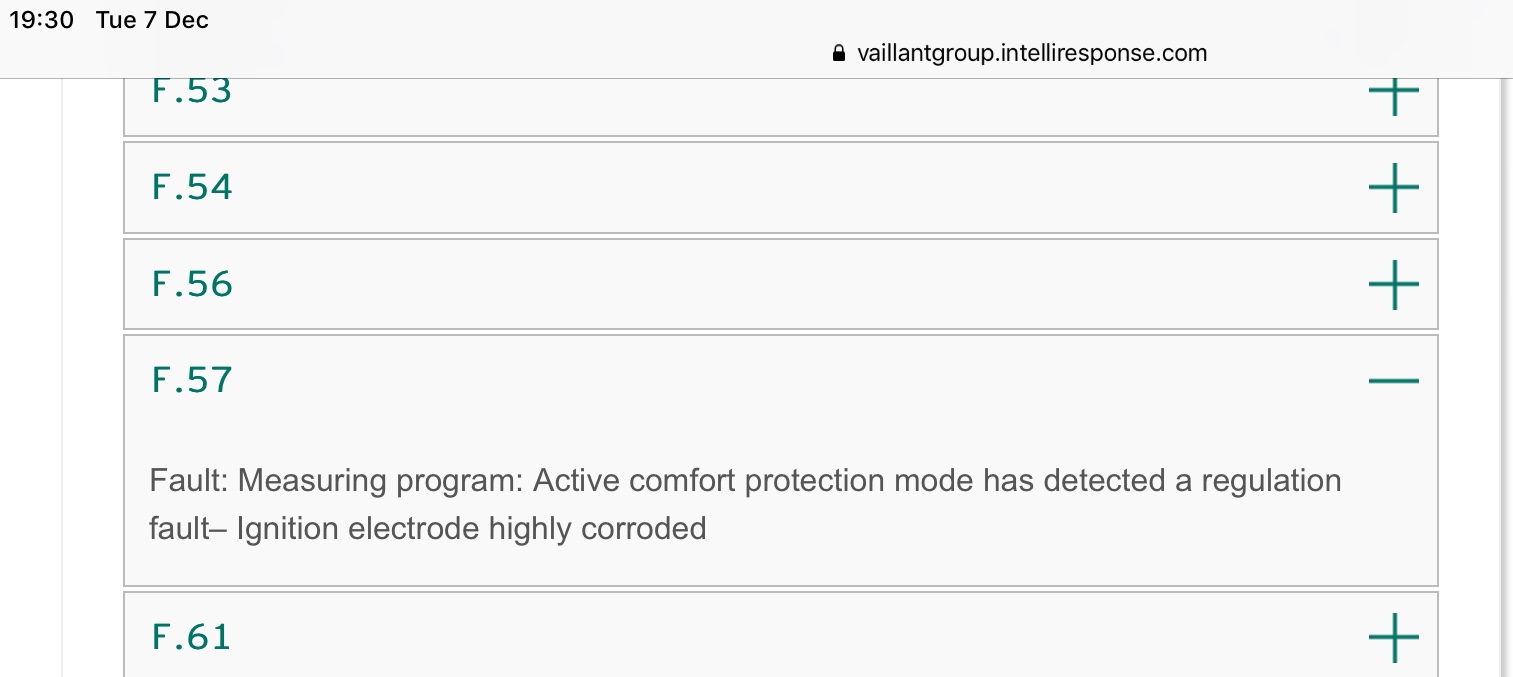

Later, being worried about a possible, very expensive C.B. replacement, I looked up Fault F57 on the Web (a Vaillant information sheet). It said that the fault number indicated that the ignition electrode was badly corroded.
Now, my question is this: if Vaillant themselves say what the fault is likely to be, why would an engineer say that it seemed that the C.B. could be faulty? I should think that he would point out what Vaillant points out as another possible cause for the fault. I am concerned as to whether, if the boiler fails again, the fault could be dishonesty diagnosed in order for the engineer to charge a much greater fee than what would be charged for a new ignition electrode.

where did you get the information that F57 meant ignition electrode ?
I think mate, Vaillant was mentioned, a sheet? So likely the following:
