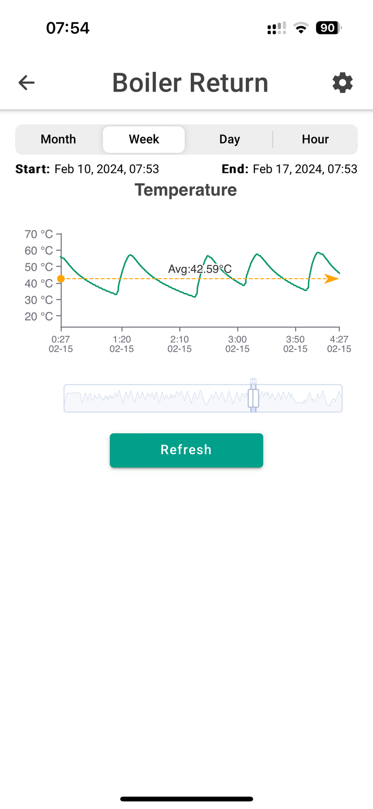

Yep it’s pretty much every hour. I did record the gas meter after you mentioned it before, problem is the CH comes on around 5am so I am not able to check it before that so I get the CH mixed in as well.
It takes around 10 mins for the boiler to come up to temp from pretty much cold, then I assume just a few mins to bring the tank up it’s tiny drop, as you can see in the attached.
I barely need to touch the stat setting for it to click and fire, it’s set to 4 which is around 60degrees, so it’s not centrally losing much if any heat.

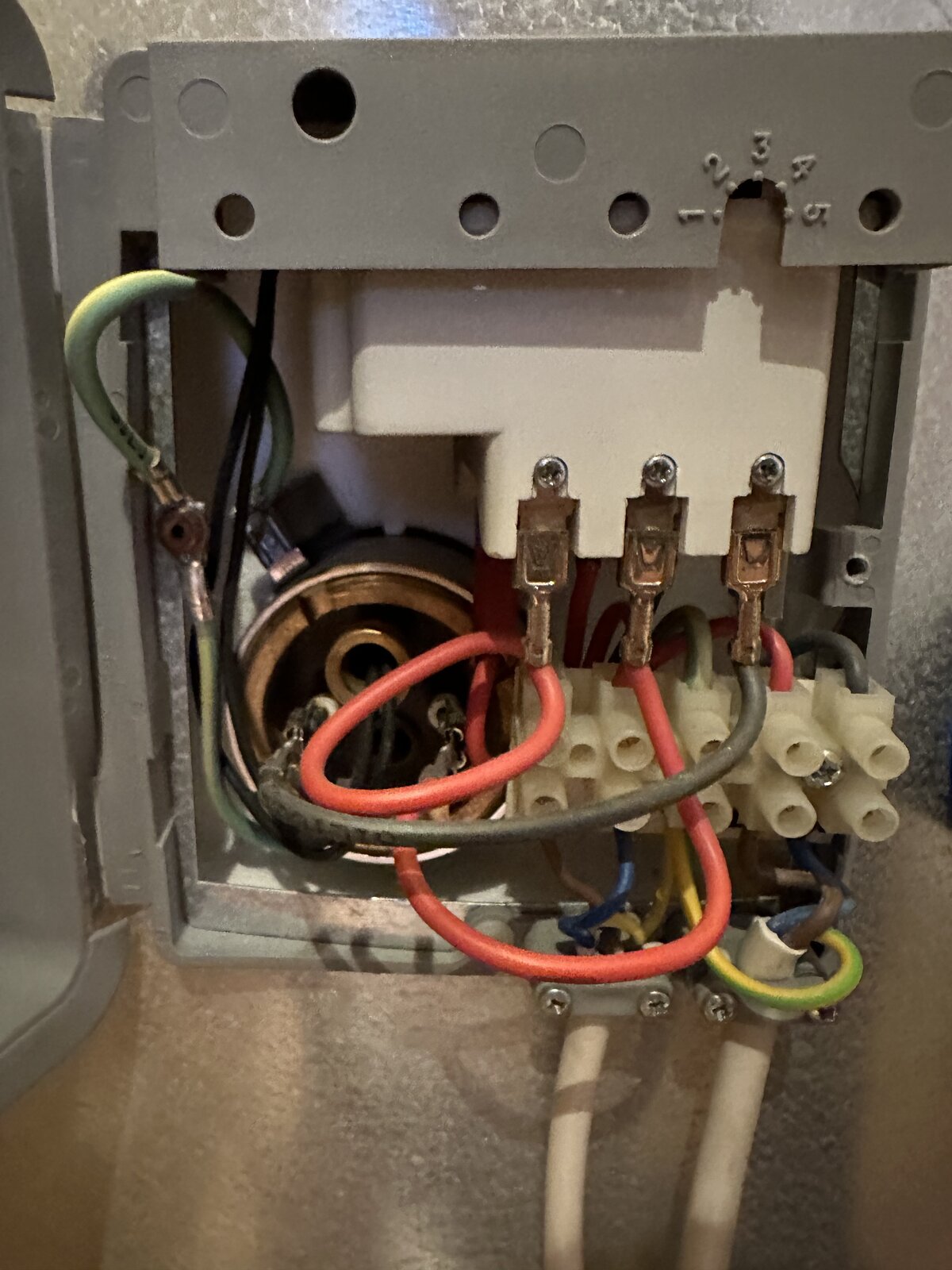

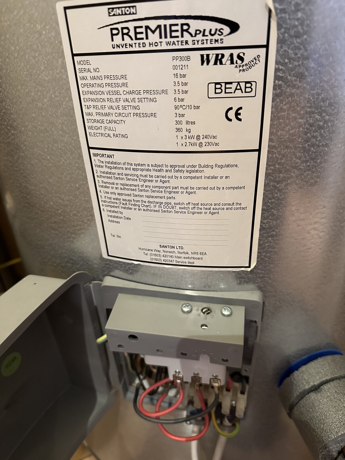

You should have another stat for the bottom immersion heating element, check if a tiny movement makes it click ON/OFF, if not and it takes more movement of the dial then the other stat requires renewing, its just not creditable that any mechanical cylinder stat will have a hysteresis of 1 to 1.5C.
Yea so I don’t appear to have a seperate one for the immersion , just one stat for all…

If you have a top mounted (boost) immersion then that should have a stat at that level, don't think you have.
Yea seems not! I will see about putting in another zone valve to rule out that issue and see from there. Thanks all
Do you have a graph for the flow temperature? The one you have posted says return, I think.
