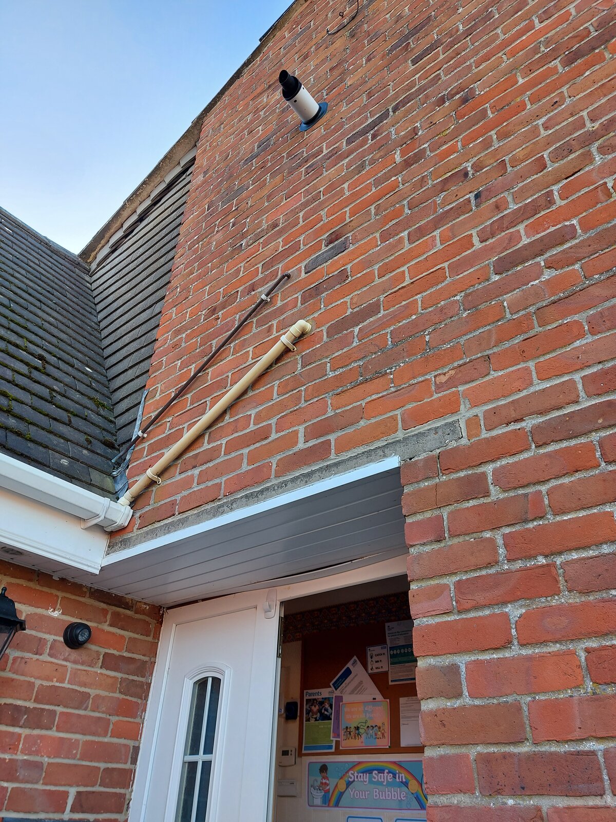

Hi all. Question on boiler Flu. I have a ideal 35kw with the flu going straight through the outside.
The problem is the flu is above the front door steps, when the boiler runs it drips water Into the steps and freezes causing a slip hazard. Can a flu be extended at a right angle to the wall by 1mtr which will then be over a gutter? It is all outside not inside. On the photo it needs to go to the right.
Thank you.

No it can't, and your flue hasn't been correctly fitted as it is. There should be no white on show as it's not UV protected and will degrade. It shouldn't drip anyway, sounds like it's been fitted without enough fall back to the boiler.

You are entitled to a free inspection by Gas Safe if you're not happy with the work. They can force the installer to put things right

It's not the only option. You could just be patient and buy yourself a bag of grit salt to put on your path in the meantime, while you wait for a professional to become available. Better than getting things wrong messing with the flue and killing yourself / other members of your household.

DIY is not an option, Gas Safe Register has the power to get the installer back to do the job properly, but all they will do is cut the flue to the correct length so no white is showing if indeed it is a make that doesnt allow white to show, what make is your boiler ?

However just cutting off the white pipe would still drip water onto the steps. Only two things I could think was moving the boiler or extending the flu.
The first is not an option so I went for the second.

your flue is designed to run back to the boiler it has not been installed correctly and your boiler manu does not allow white showing
Did the installer not possess a tape measure?
It clearly states in the Manu's installation book how much the flue should protrude from the wall.
As said above, GS will make him do it properly at his own expense.
I'll wager £1 that its not sealed with mortar either.
