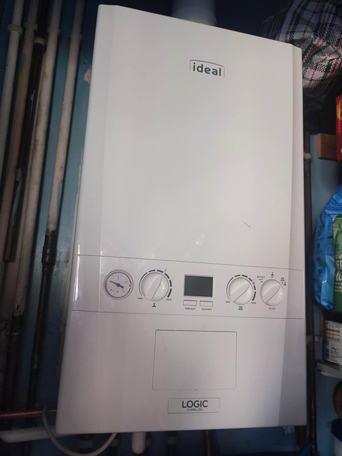

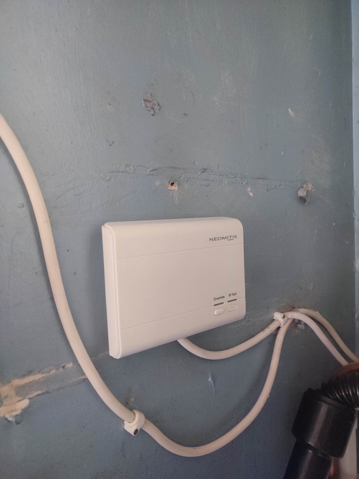

Our boiler has just stopped working. There's no display on the boiler and no lights on the thermostat on the wall. I've checked wiring, no fuses tripped etc, it's just these two things that are dead. Any ideas before I call out an engineer?

Where do the two cables in the second picture running off to the right go?
One is the main power to the boiler and the other is the cable from the thermostat to the boiler.
That is also connected to the burglar alarm which is still working weirdly enough :unsure:
That could be because it has an internal rechargeable battery. Is the 'mains' light on the burglar alarm illuminated?
The alarm goes off if you turn the switch off. I've just tried a new fuse but no joy. :(

Ah well, if you are getting power to the boiler but nothing is powering up, it is more than likely the PCB if it doesn’t have an internal fuse. What is the make and model of boiler?

The wireless thermostat receiver, is also not indicating it has mains power. They are normally externally powered, but on the same supply source as the boiler - which suggests the issue is external to the boiler, rather than an internal issue.
OP needs to try switching the MCB off, then back on, to make sure it is on, and recheck all switches and fuses are OK. Some MCB's/RCBO, don't flip all the way down, when off.

Ideal logic

Just had a go at that but nothing happened.
