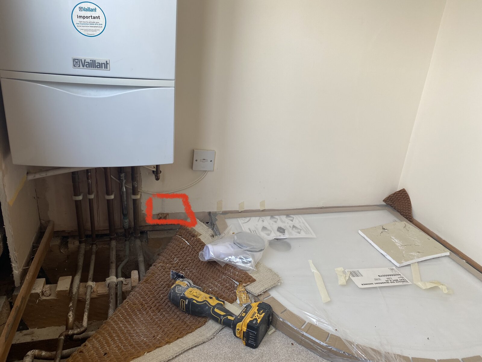

We have a combi boiler in the loft conversion. We are going to put an en suite in there (no idea why previous owners didn’t). I was doing some reading and somewhere said it’d need to be rcd protected? Is that right?
Yes, but not exactly.
No appliance must have or needs RCD protection but the new circuit will have to have an RCD for the protection of people.
It’ll be about 50cm away from an enclosed shower and about 80cm away from a sink (it’s in the corner of the room). Is there anything stopping me from doing this?
The basin has no relevance but the supply accessory to the boiler must be more than 60cm. from the edge of the shower opening.
Socket and plug not allowed so it will have to be a connector of some sort - either a Fused Connector Unit or a simple Flex Outlet fed from somewhere else.

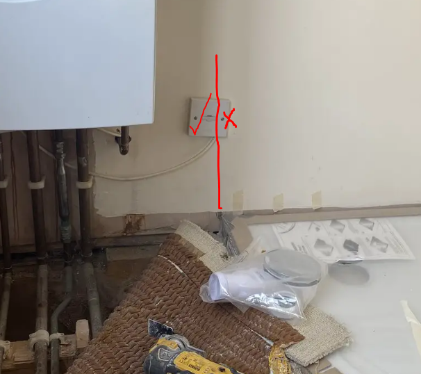

Picture shows current set up. I’ve left the shower tray where it’s going to illustrate. How close can the supply be to the boiler? Would sticking it within the cupboard be sufficient to negate the 60cm issue?

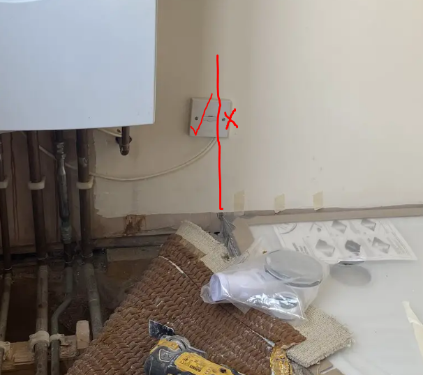

The accessory shown is allowed to be in zone 2 - so it looks like it only needs moving to the left a little.
Makes no difference to the item in the picture.
Make sure the cable remains vertical or horizontal to the new position.

What I meant was, is there a rule where you can’t put the fcu too close to the boiler?
Ie underneath the boiler here? Appreciate the flow in from that pipe might be in the way behind the wall.

Of course - referring to the supply cable; not the one to the boiler.
If a cable is not visible, it gives an indication where a cable might be buried in the wall.
I’m probably going to try and stick it in the cupboard I’ll make for the boiler just so it’s out of sight. Is there a distance it has to be away from the boiler?
Not really. Just common sense.
Putting it in the cupboard probably means going diagonally down to the left.
Ok - just go straight down until you get to the floor.
