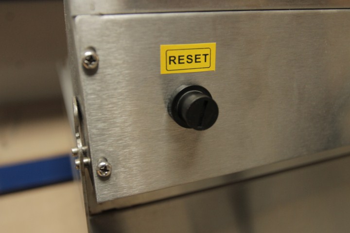

I've been looking around for the overheat/limit stat and can't find any popped-out buttons.
Could it be inside the Honeywell box, hence I need to unscrew the lid to locate it? I've attached a picture of the boiler, just in case you can guide me in the right direction.

It should be on the control panel on the upper section of the boiler that is cut off in your photo. They often look like the attached photo, the little cap unscrews and you can then press the button underneath.

I found the cutout button and reset it - it was on top of the panel at the top, once I had taken the casing off.

Air was trapped in the system and the pump [circulator] wasn't able to cool the boiler as quickly as the burner warmed it up... hence it got too hot and the limit stat kicked in to protect the boiler. All sorted now glad you are sorted.
